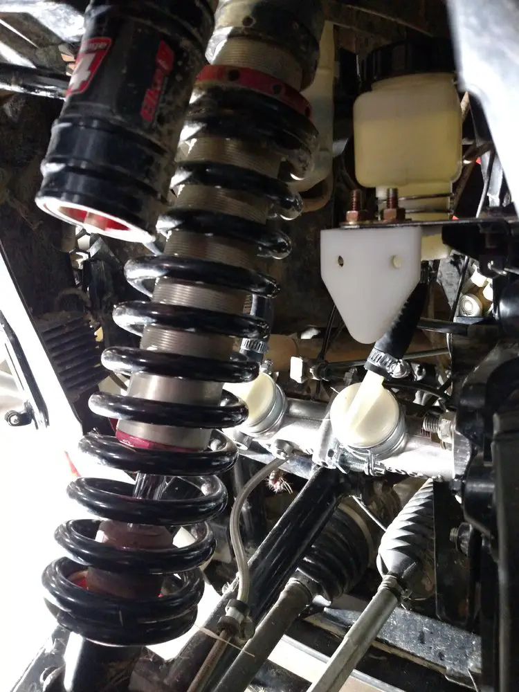

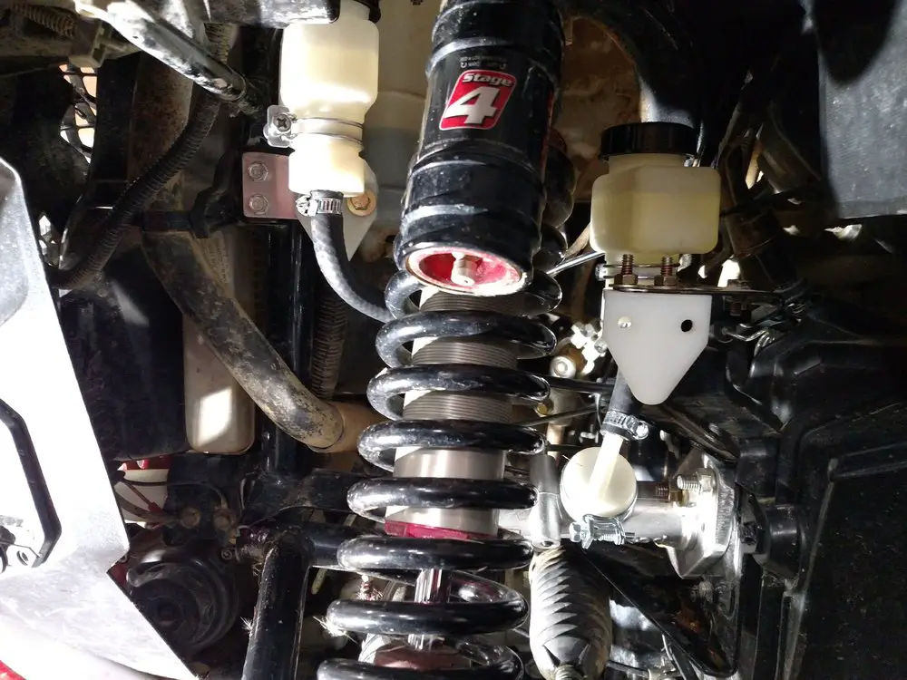

Master cylinder is done and works good. A little less pedal effort. With the dual reservoir, you can loose a front or rear brake line and still have the opposite brake work.

Is that the wilwood 1" bore. got any picks of both reservoirs .Looks really good .Ebrake worked in ?

Think it would be even better with a 7/8" bore if available or move the pushrod mount up on the brake pedal. With my SS lines, there is no sprungy feel.

Thanks may try to do something like that !

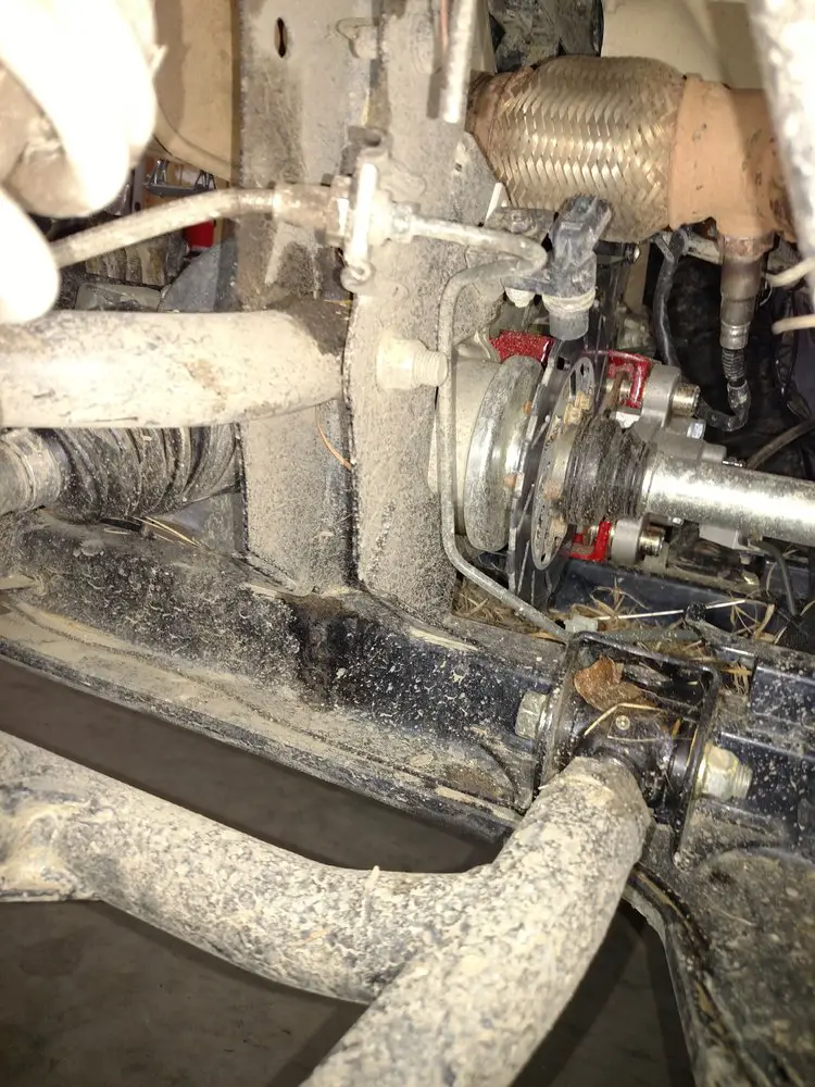

Clutch has been slipping / slow shifting the last couple weeks. Haven't found anything mechanically wrong yet besides the cracks below. No codes flashing. Clutches look good. Think that clutch update probably saved them. All the sensors and wires ohm'ed out good. There was a bunch of dirt in the ECM plugs.
