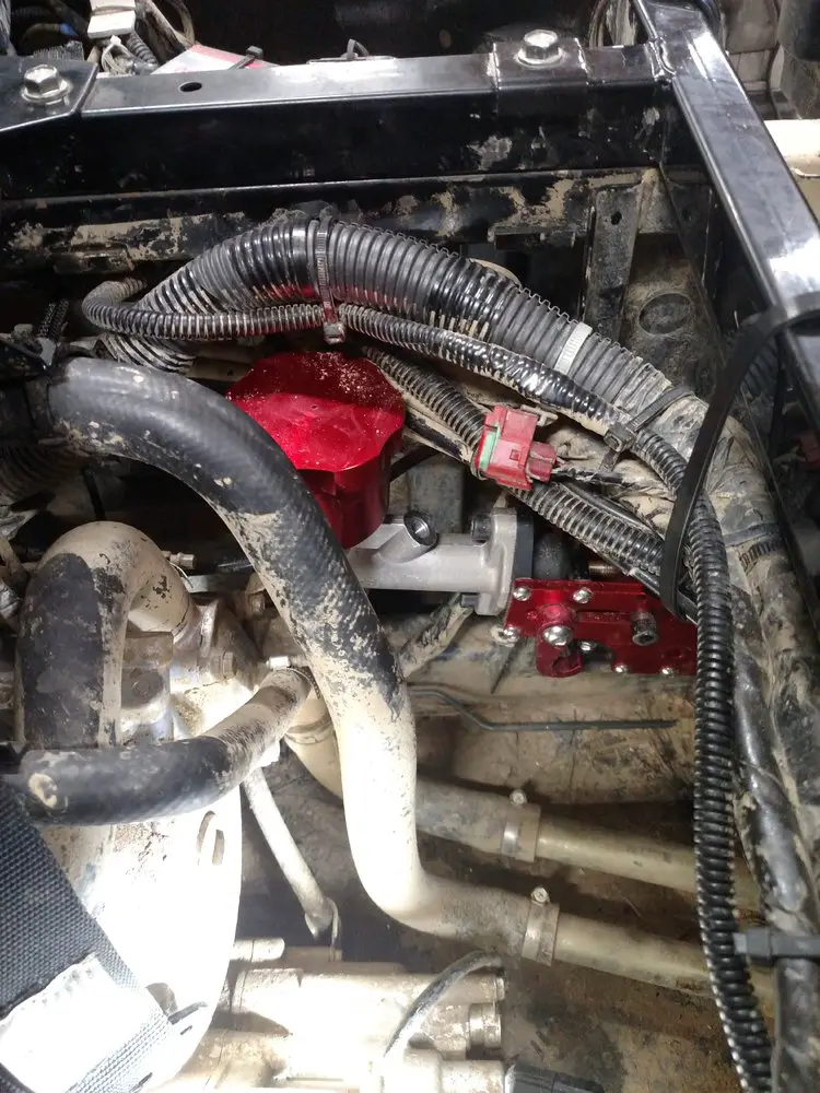

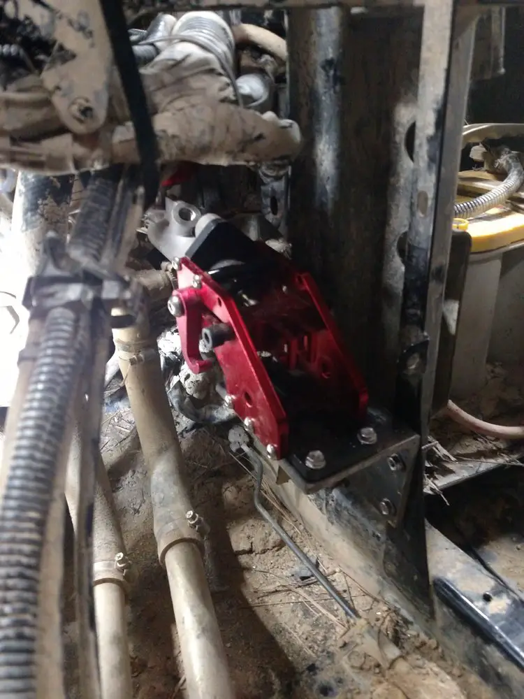

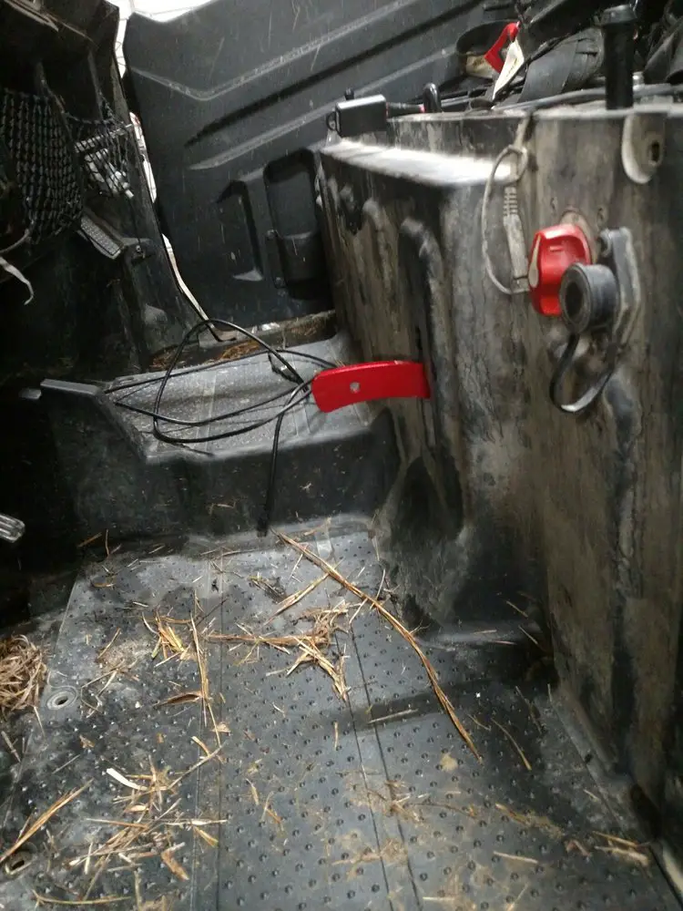

E brake finally underway. Had the disk and caliper mount done months ago. Just mounted the master. Going to go through the seat firewall for the handle.

E brake works. Could use a smaller bore master cylinder for an easier pull. Think I have some old 4 wheeler rear brake masters I might try later. Still need to test this one some more and brake in the pads.

The duty cycle is real low on the electric locks. The cheap manual locks like to leak and blow seals also. The stock master cylinder only has 1 shared reservoir so if anything leaks you will loose all brakes. Swapping to a dual reservoir master cylinder is what I would like to do also to separate front and rear brakes. Wilwood has a 1" bore master with remote reservoirs. Will have to fab an adapter bracket and rod. I'll get to that before takeover.

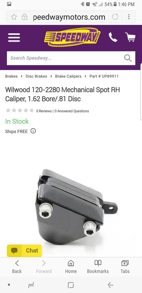

would a cable actuated caliper work? Similar to a Cadilac rear.
Any pics of the caliper/ disk mounted to pinion?
Or this?Screenshot 20180220 134629
Or this?View attachment 65708
I think somewhere like post 410 in this thread there was one way up there. I don't know why a cable wouldn't work might my be hard to pull unless you make foot

The 1" bore would give a little more leverage than the stock 1 1/16" bore.

I bought the wilwood one just like that but it was not floating unless I made some crazy bracket for it. I wanted that with the old toyota truck pull and turn e brake.
