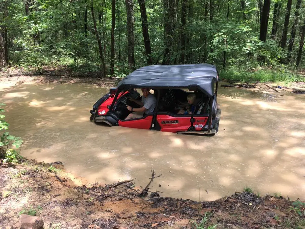

That’s just a few pics, I’ve got lots of vids in deep water and never an issue.
Just tighten every connection from snorkel head to motor. Some guys have had the tubes slip off the throttle body.
Also, I run a 3” filter in place of the snorkel head and the stock filter stays a lot cleaner.

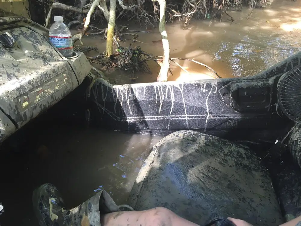

@dswv42 , I've been really happy with the hood snorkel. I've definitely been in water that would have made me nervous with the stock inlet.
Between the UNI prefilter and K&N filter I'm probably not as clean as a Honda OEM filter but at least I'm not throwing away the filter every 1000 miles

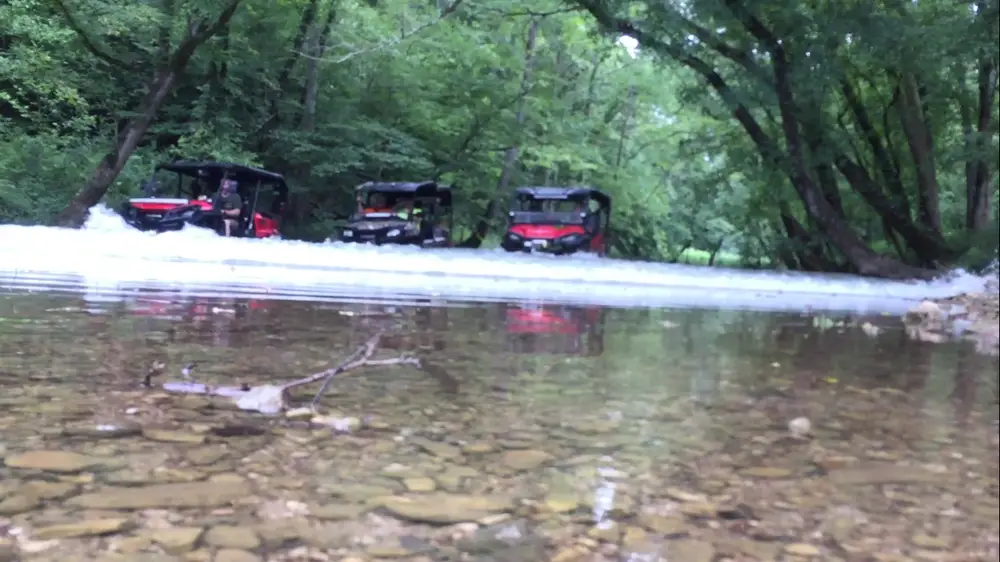

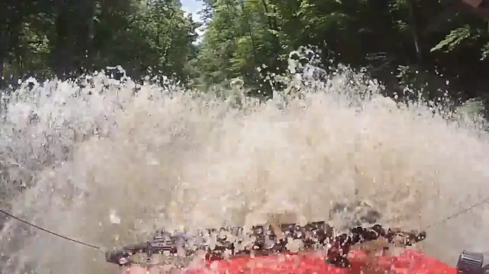

I’m still using the stock location air intake and play in the water a lot. Never an issue with the through hood snorkel. Just snorkel it and forget it.

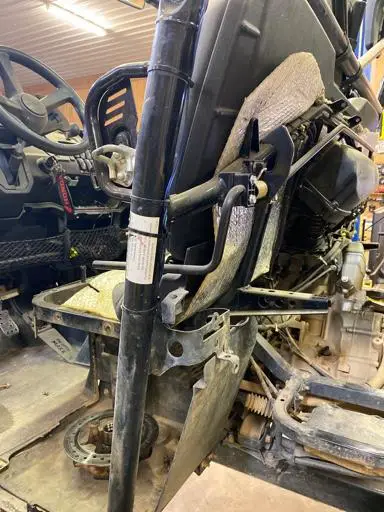

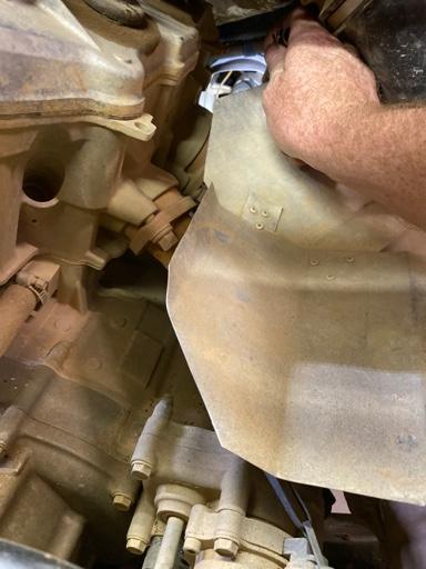

I’m in the shop right now so I will take a picture of my set up which may help you.
First, The foil backing under the seat didn’t help very much until I used one piece that went from under the seat all the way up the back and that made a drastic difference.
9a7c9427fd90a1727ac890ff1c67fa63
Second, I made a little heat shield that helped quite a bit especially for the passenger side rear passenger seat.
06c63c81b01afe75957ec4348021ed25
This heat shield helps channel the air from the bilge fan out the back instead of it blowing up.
4078c6b61a56e76cf27adcb75dc43a63
The 4” quiet series is what I used.

Yes, metal shielding to form a duct cavity over the exhaust manifold is exactly what I have in mind. It blocks radiant heat and forced airflow reduces convection heating. The trick is carefully directing airflow to prevent superheated air from causing more problems.

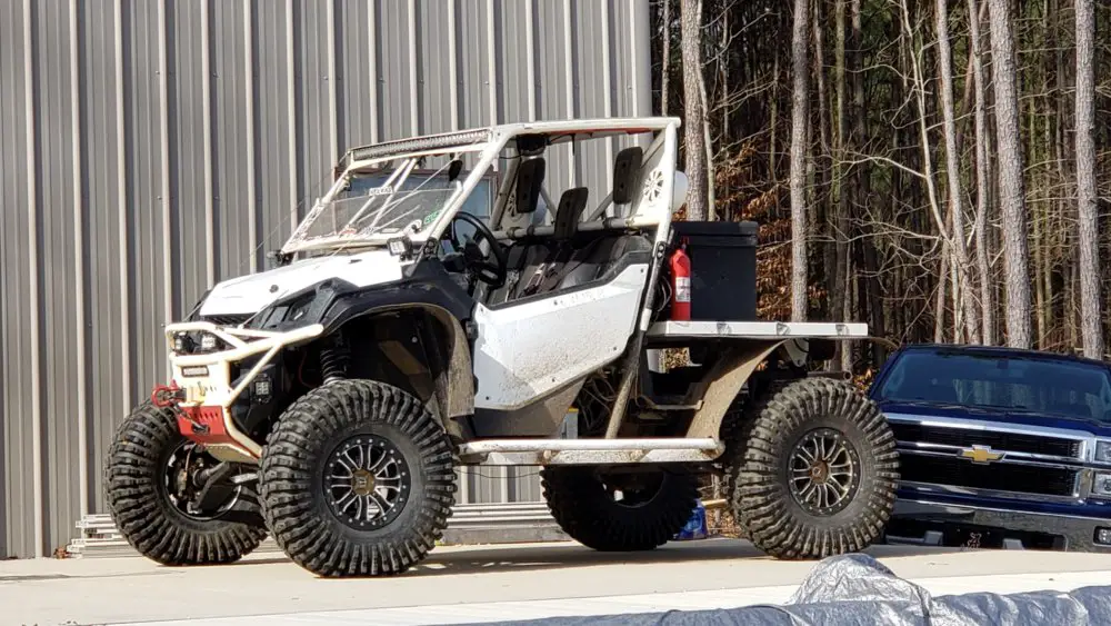

“White lighting”....this build thread.....barrel rolled down a rocky hill in the fall of 2017. It rolled over twice. As you have probably noticed, it has a custom roll cage and it suffered absolutely zero damage with the exception of a cracked wheel spacer. The occupants were wearing their harnesses and there was no injuries.
I probably should do a new roll cage someday but I should first get it rolling again.
But causes the opposite problem when not moving or serious fan. Been there, done all of that X2...

I thought of that, and may have a viable solution in mind, but it's only theoretical at this time. One must be very careful not to trap heat, or it can certainly make things worse.
