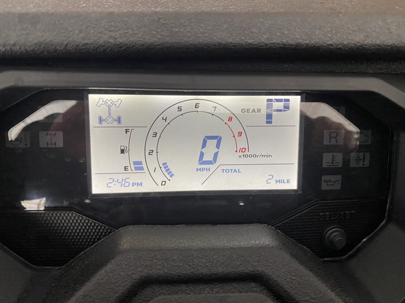

Well guys this dang thing is stuck in 2wd! I can’t get it into turf mode for the life of me. I did get it to go into 4wd one time but I’d really like the turf mode to work! If it ever does find turf mode will this 2wd locked mode change on the dash?

Try backing up and turn hard left or right with it in Turf mode. If it comes out you need to adjust shift cables.

Ok I just went back out and played with it and got it to go into diff lock and 4wd and 2wd locked! So I was wrong! I’m new please forgive me but it’s like it was actually stuck in turf mode according to the dash but I was still spinning both rear tires in the snow left and is back in turf mode now and still spinning both rear tires on the snow! Has got me confused. Should both rear tires spin if it’s really slick? I was actually hoping to see just 1 wheel peel out

You should be able to turn sharply without the inside rear tire dragging, leaving the turf,gravel,dirt,lawn chewed up.

It acts more like a limited slip differential. It will spin both tires but when you turn it should not tear up the ground like a locked differential would
The display is showing turf mode in this picture. The rear diff will have looked connected in 2wd lock.
Edit: There should be a "X" where the rear diff is showing locked
The way I can tell if the machine is physically in 2wd lock or turf is to turn as tight as possible on a hard packed surface and listen for tire scrub in lock.
The 2022 P1K and 6 seaters no longer have the select box under the passenger floorboard. I'll have to get into the service manual to see how to adjust these.

You may need to adjust the rear locker cable located on top of the rear diff.
