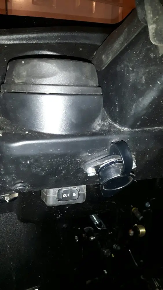

Looking for recommendations / suggestions on where some of you mounted the plug for remote operation of winch where it makes the most sense. I have mounted the dash switch below the left hand cup holder where it can be actuated from the drivers seat or just outside while still able to steer.
I have thought about either mounted in or on (via small angle bracket) the Strong-Made bumper.

I put the switch and remote plug under the driver's side cup holder. You'll be standing beside the machine when you plug the remote cord in. Handy there and not exposed to the weather etc.
20170301 151821 resized
FYI Al
