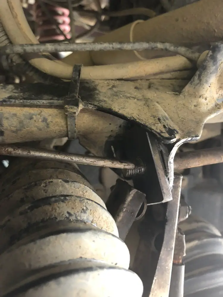

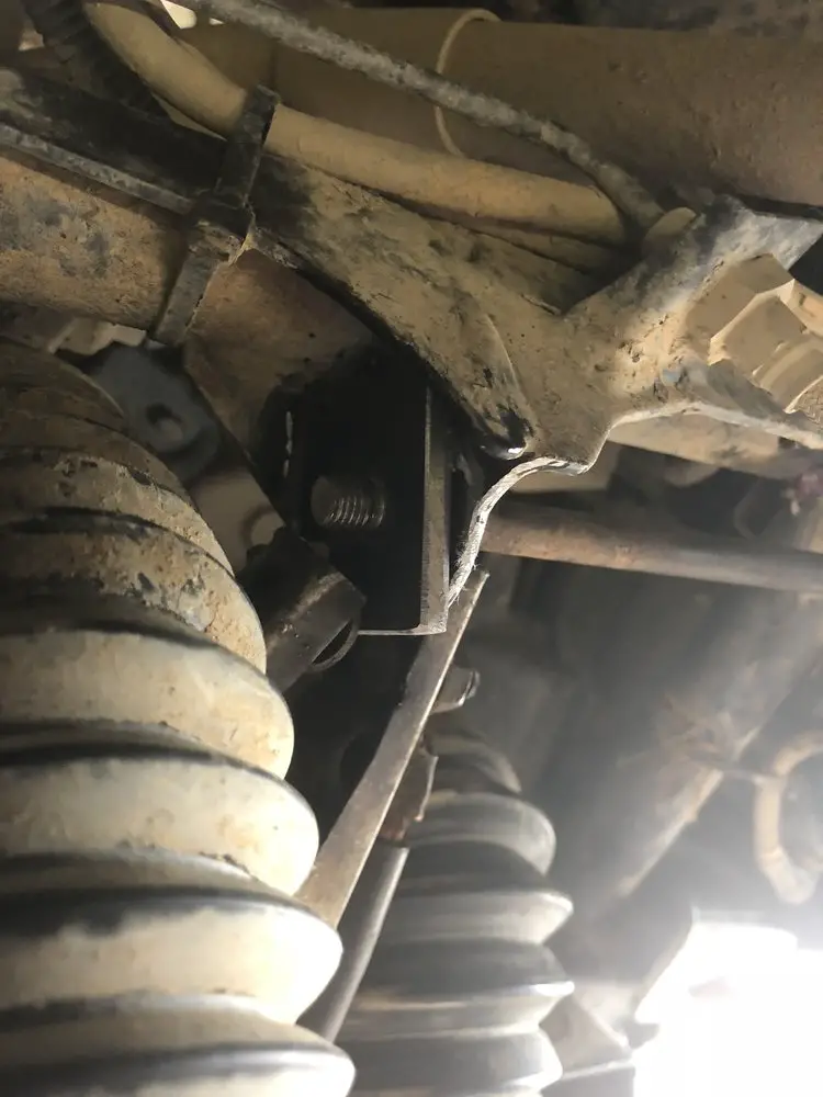

I wish. Upper a-arm (front) mounting tabs. Superatv bushings and inter sleeve seized on bolt. Bolt became piviot point. Bolt cut 20% in too. Get grease in arms boys and girls. I thought the bushings where wore out not so. Bolt was tight.

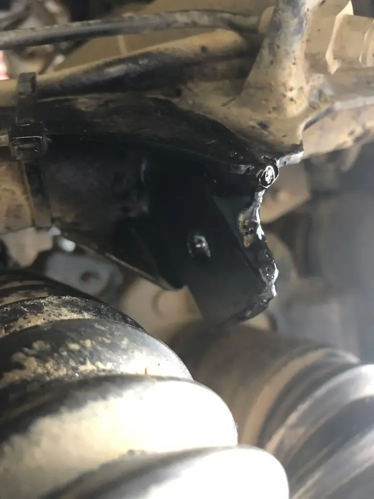

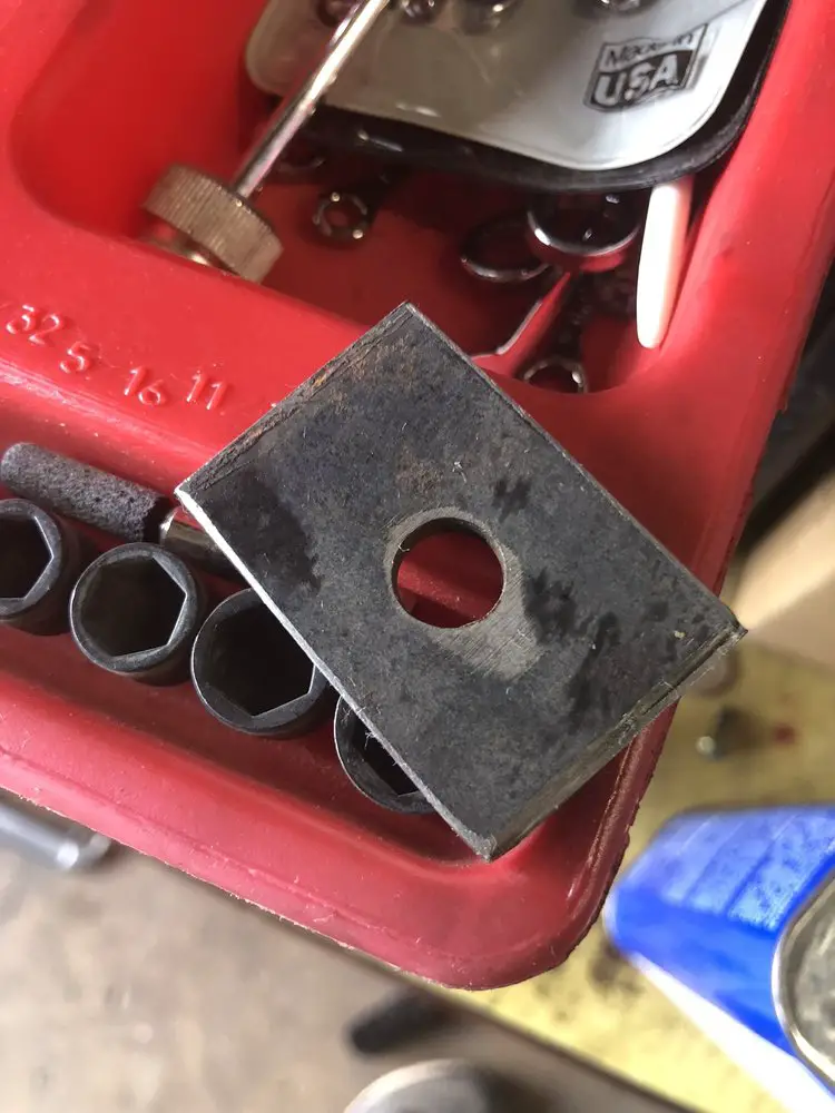

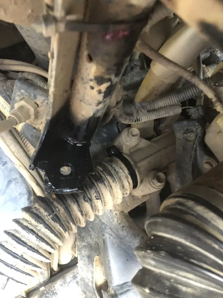

Beefy, should last a long timeView attachment 83716 View attachment 83719 View attachment 83720 View attachment 83721 View attachment 83722 The repair!
Pretty enough looks like you did a fine jobNot pretty but strong!
