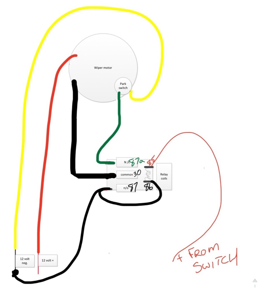

Who speaks electrical engineer?
I need help deciphering this diagram for a wiper motor, I cannot disassemble the assembly without the high likelihood of destroying it.
UPDATE
This is for everyone who wants the Wiper but not use the Honda Aux Panel.
Spifyd,
The non-North Americans switch the Negative(glad I had fuses) I wouldn't have figured it out without you pointing me the right direction. Many thanks.

I wired up my P1K this way with the relay last year with no issues at. The wiper parks perfectly when I switch off the wiper switch. Today while it was pouring out (again) I had the wiper going for a 5-7 minutes. I pulled in the garage and switched OFF the accessory switch before I switched off the wiper switch. Realizing my mistake because the wiper did not park properly, I switched off the wiper switch but obviously that didn’t park the wiper because there was no power from the accessory switch. So I switch the accessory switch ON while the wiper was switch was OFF and the wiper began to continually run whether I had the wiper switch on and off. Now every time I switch the accessory power ON the wiper runs the whole time whether the wiper switch is ON or OFF
Did I fry the wiper switch or the park relay or both or something else?
32,050
That’s weird sounds like a bad relay

I'm just about to start wiring my wiper. Should I grab the positive after the 7.5 amp fuse but before the rocker switch that goes to the relay switch?

Ok thank you. I printed the wiring diagram off the thread that shows where each colored wire connect.
Looking at the diagram I'm assuming that where the black wire connects to the yellow wire that it is also connected to a ground stud at that connection. Is that correct?

Thanks for the diagram, very helpful. How would you wire that to a five pin lighted rocker switch?

did this install 4 years ago now I'd like advise on adding delay control.is it possible,how would I wire it & what switch should I use.any help would be much appreciated.
Same question, how does the switch wiring look with just the factory rocker switch that’s non lighted? I have the relay wired and wondering how I wire that factory wiper switch

Is there any way to just hook it to a toggle switch and just turn it off where you want it to stop?
