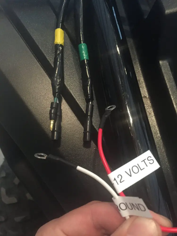

How do I get the red 12v car in my hand connected to the Honda wiring harness in the picture? It has goofy ends on it.

Cut the ends off and use an inline connector.

Green should be hot. Mine was backwards! Don't know if it was the light bar wired wrong or the harness though. Use a volt tester.

Thanks everyone. Got it all hooked up and working. And yes white cable is hot lol. Learned it the hard way lol

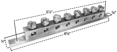

Yep, I did. I installed a ground bar to run the multiple accessories off of.

I did the same...it has come in handy.View attachment 17322
I ran 4 gauge power and ground wires off of the battery through a bushing and into the bottom of the toolbox...stay dry.
I used a fused power bar (for car stereos) and ground bar mounted in box. All led's and winch run to those. Stereo and GPS go to the harness so they're switched power. Wanted some accessories to have ability to run regardless of ignition. Didn't want too much spaghetti under hood.
Accessories are easily added by running wires into bottom of toolbox. My 2 cents.
