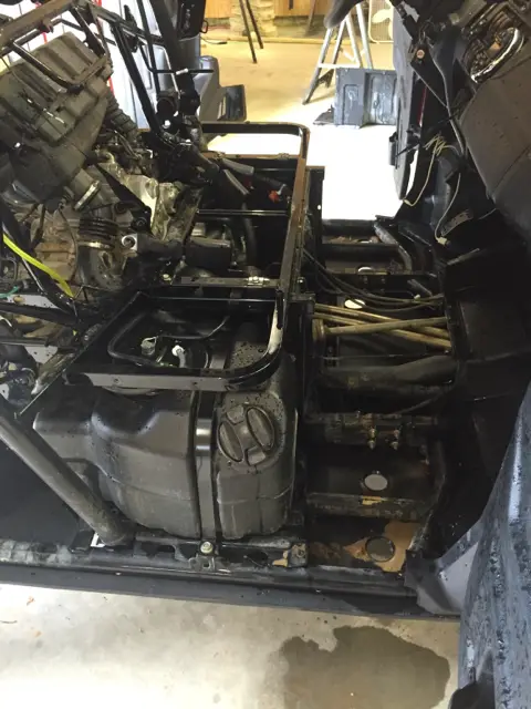

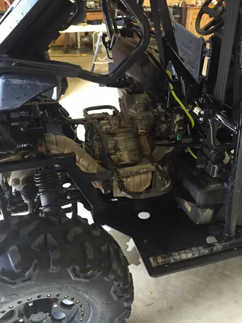

There's a solution but you have to work for it.

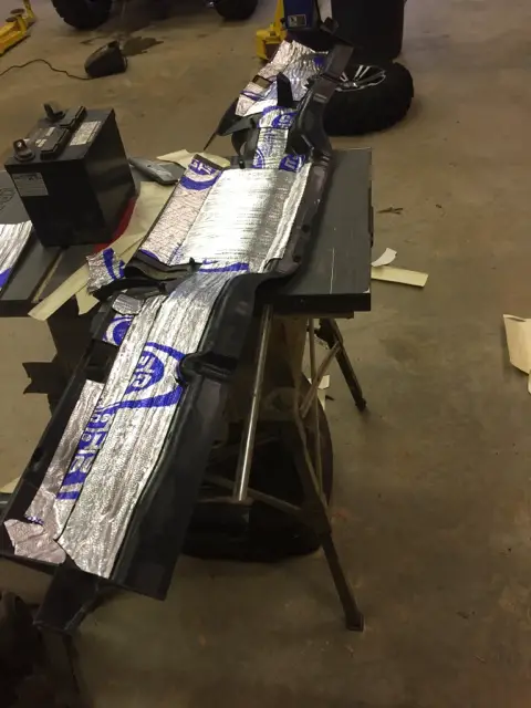

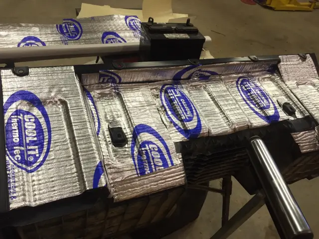

I used adhesive backed insulation and covered the rear passenger floor board. Here's a few pics. I can give more info if you got questions.
I removed all those plastic prices till my pioneer looked like this.

This is the rear passenger floor

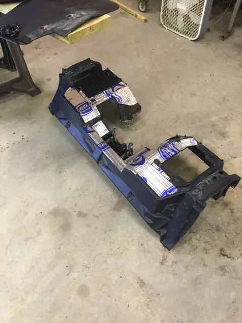

While in there, I also covered pretty much everything else

In the first pic, regarding the flex hose connecting the hard pipe and the air box, is this where you found loose bands that needed tightening?
39,129
I found the loosest clamps under the seat at the lowest part of the intake tract.
I also lined the air box with the same reflective heat barrier. Not sure if it helps but I had some left over and figured it couldn't hurt.
