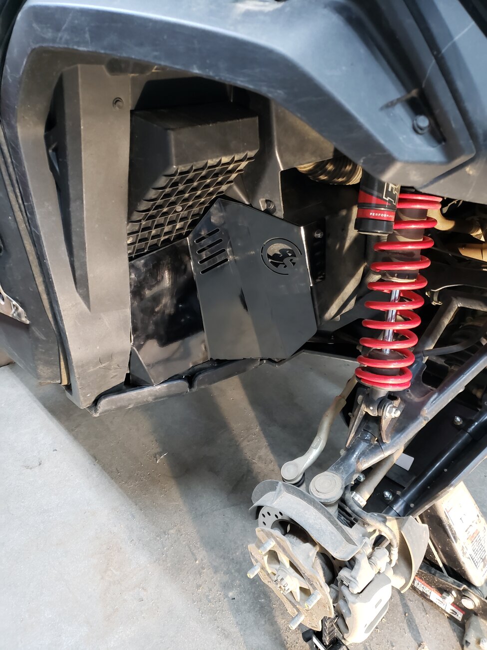

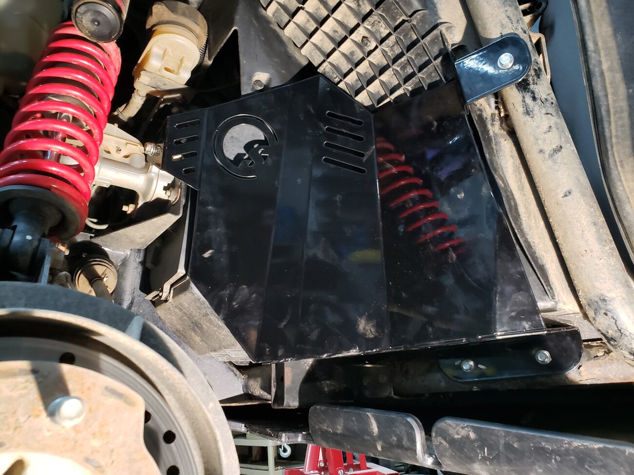

I installed the stick stoppers today. I installed the panels using rivnuts instead the provided self tapping screws. I removed the tires to gain better access. They did not interfere with my Factory ATV skid plates. I am going to cut some plate to cover the area above the top of the panels. Overall I am happy with them.

No offense taken. I wish the stick stoppers product was steel, but the aluminum provides better protection than the plastic did. The 1/2“ UHMW skid plate and A arm protection I installed provide addition protection from objects being driven thru the plastic cabin structure as well as protecting the frame and engine components. No product provides absolute protection, just addition layers of protection.

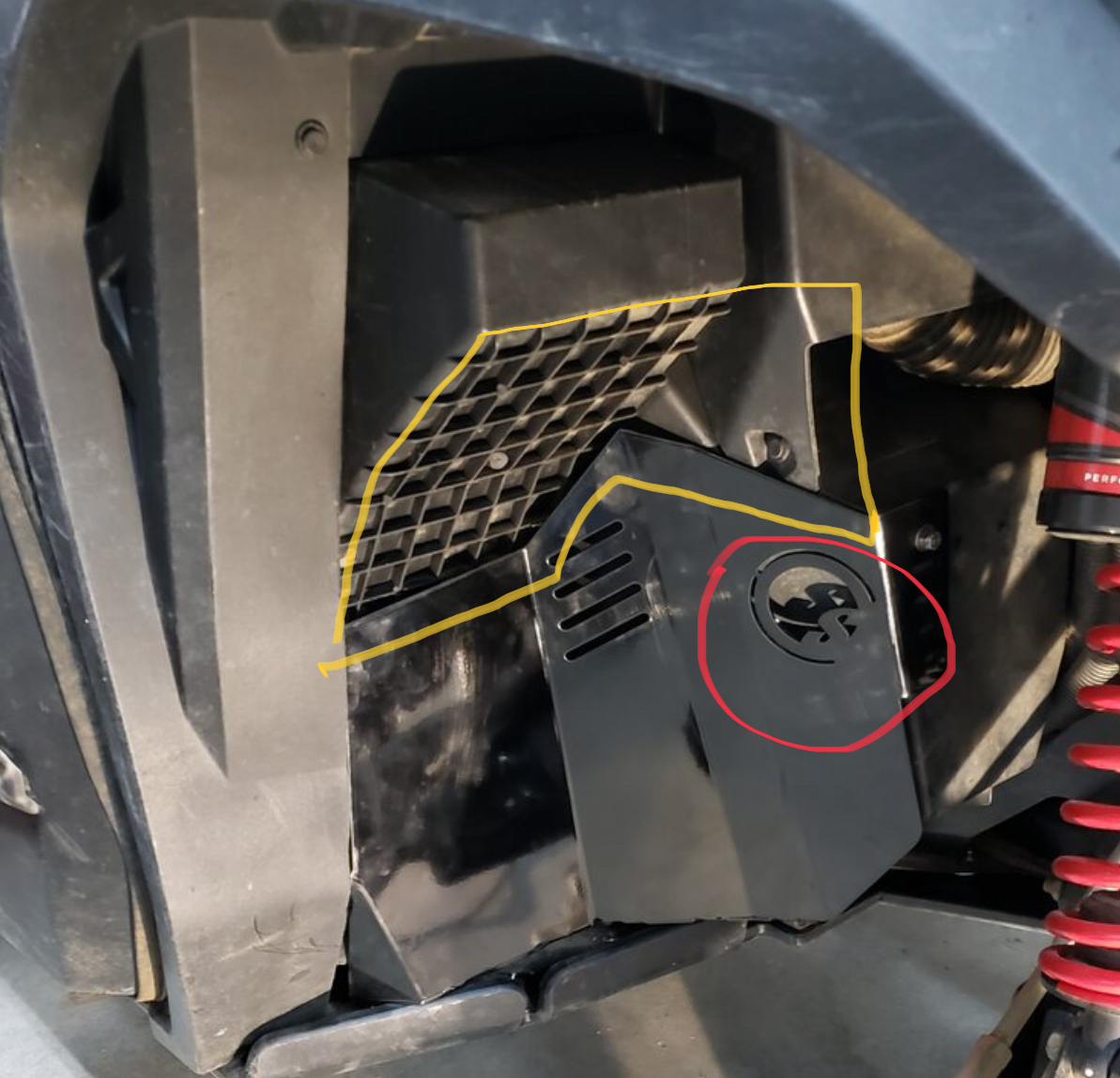

They look good, but IMO the rear should cover higher.

Definitely filling a void for a needed product @SuperATV and they look better than I imagined. Seems like extending them higher, and loosing the S logo, which creates a mud trap and a hole would be an improvement to consider. Best of luck with the new product.

You know my design dudes are going to slip that "S" in there anytime they can. 🤣 🤣
