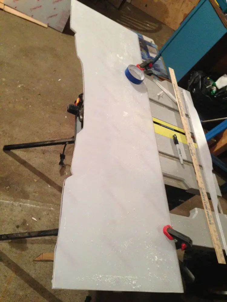

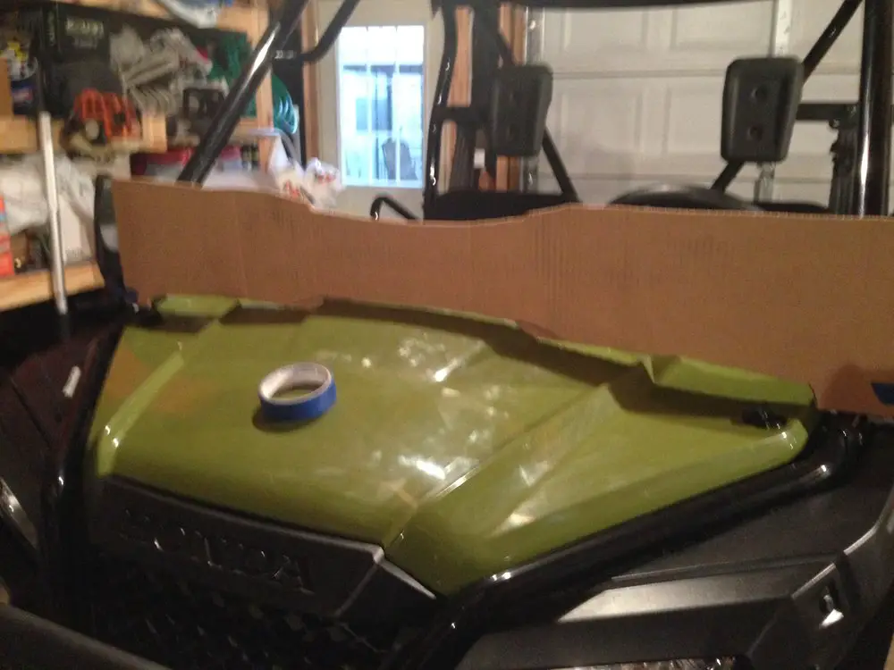

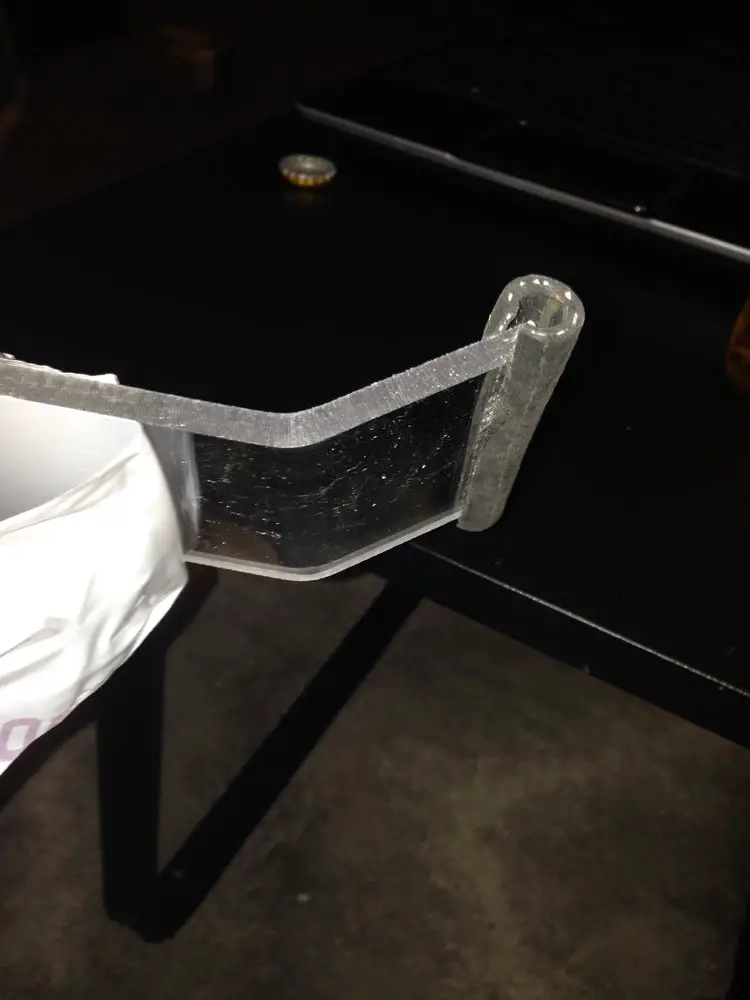

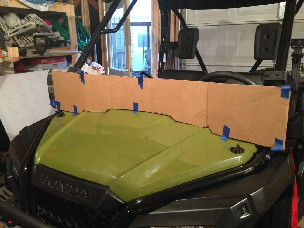

I started making my windshield, after about 5 cardboard templates I finally cut some polycarbonate.
I did a test bend in a scrap piece by heating it up and slowly bending it.
I'm going to attempt to try using a brake press and see how that works.
I'm making it out of 1/4" polycarbonate, going to use Honda rops clamps to mount it.
The idea is to make a 2 piece windshield, this part is the wind deflector half, with a top half that's removable.
The total cost should be about $40 for me for the whole setup.
IMG 0206 IMG 0226 IMG 0227 IMG 0228
View attachment 44493 View attachment 44494 View attachment 44495 View attachment 44496

Lexan reacts just fine to a cold bend, 1/4 " will easily bend with no heat needed. Working on a windshield myself with the top half folding up and laying on the roof top. I'll see if it works out.
JTW
Reeeeally??? I want to see a video!
Jshell3
My 1/2 windshield on Blueberry P500 was Lexan.
I watched a demonstration where the guy put it in a vice and hit it w a sledgehammer over and over.
Bending it.
I was impressed.
I knew it wouldn't crack from being tightened down, anyways.
