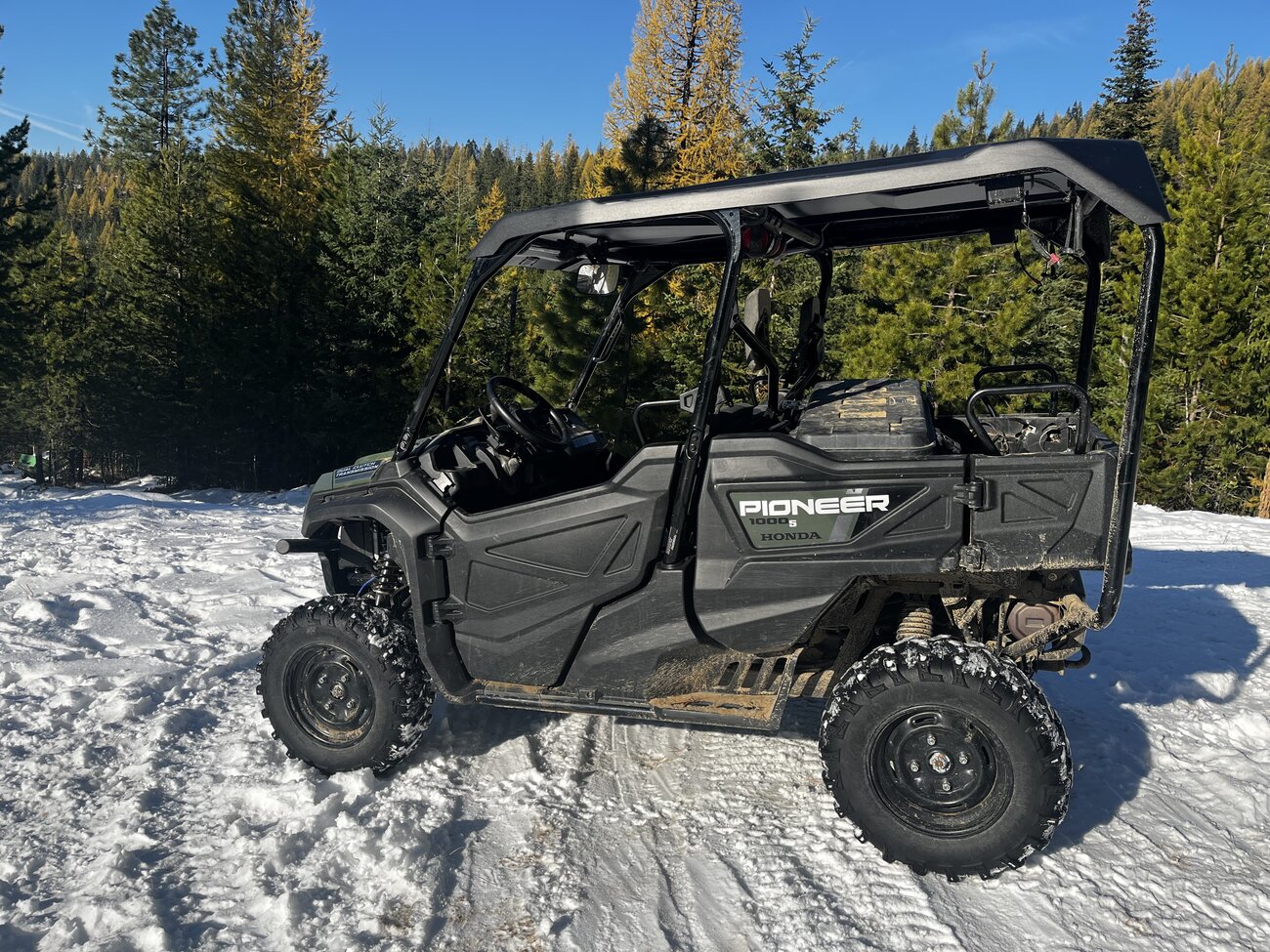

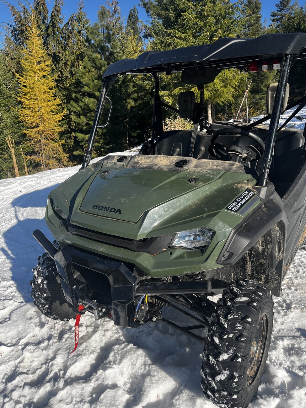

Got my Pioneer a few months back and starting to build it out. 700 miles on it so far and it’s been awesome.
So far I’ve done:
1. Honda hard roof
2. Badlands 5000 winch with KFI mount. Worked great, direct fit. Used the factory switch plate with “knockouts” to mount the rocker switch. Thinking about what to do with the remote winch cable, in case I want to winch from outside the rig. For now it lives under the hood. But this space is getting used up. May wire it thru the glove box?
3. Fire extinguisher with roll bar mount
4. Rough country poly carbonate windshield. Just went with the solid but I may change this to something flip up or glass… idk yet. Went cheap and basic and simple to start.
What I’m working on right now:
1. Dual battery system. Working on now and waiting on a couple parts
2. Super ATV heater- have it installed but haven’t tried it yet as I’m waiting to hook up to the accessory battery. There is NOT a lot of room under the dash to mount the defrost vents. The passenger side is fine but the driver side is very tight. The windshield rests just on the edge of the vent. I’m not super pleased with it but I think it’ll work. The lack of space under the dash as well as the lack of flat space on top made it tough.
3. 12 inch LED light bar on front
4. 2 4 inch pod lights which I think I’m gonna mount off the back.
5. Hand crank windshield wipers
What I’m planning for in future:
1. Camso track system
2. Eventually new tires once stock ones wear out.
3. Cab enclosure system- maybe something homemade with canvas and sewn in windows with clear shower curtains. Grommets and D bungees to the roll cage? Maybe plywood with some poly windows, may just buy something idk yet??
That’s it for now but once you get started… ya can’t stop

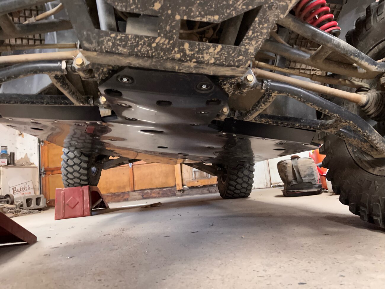

Good start 👍......... May I suggest a real skid plate. The factory G-string leaves a lot to be desired and kinda just plain stupid/dangerous. Something like the @SuperATV skid or many others around is highly recommended. There's also a DIY drawing floating around if you want to tackle it your self.

X2 on this....a real skid plate is a must on these machines...I have the Superatv one and it's great, covers everything underneath and is probably the most affordable option out there. They run good sales a couple times a year, I think I got like 25% off when i bought mine....best of luck....

10-4 will look into those. How heavy are they? I assume you take off the factory one and then it uses the same mounting holes? Can you still get at your drain plugs?

Yes they are kinda heavy but not too bad, and it's down low so nothing to worry about. Yes, you take off the factory one and put it where it belongs.........in the trash 😂😂. Uses all the same mounting holes plus nee ones you have to make to cover what the factory flap didn't. Yes, you can still access all the stock drain holes, and you can drill anything else as needed (more drain holes, vents, etc) because it's easy to work with material.

Heres a link to the satv one...hes a vendor on here too....might get you a little off the price if you send him a pm...at least then you can see what it looks like on the machine....there are several skid plate options, this is just one example. The point is any aftermarket one will be waaaaay better than the factory junk....

One thing I forgot to mention on the skid plates, that I never thought of before I read alot on this forum. There are basically 2 types of skid plates, the uhmw (heavy plastic) or aluminum. It seems most members on here have the plastic type. Reason is, if you hit something hard with the aluminum type, they can dent and are next to impossible to remove and reinstall if you ever have to take it off again. The plastic ones dont dent. I'm sure they can crack but it would take a hell of an impact. The satv one is 1/2" thick. Anyway....good luck
