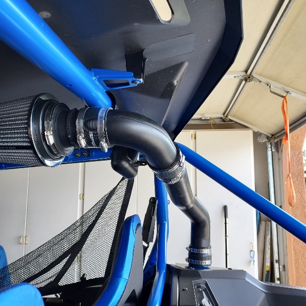

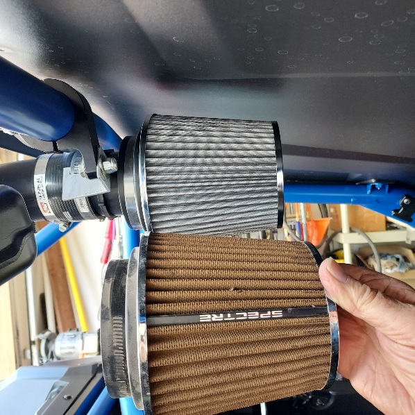

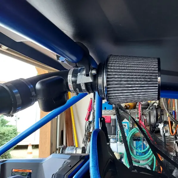

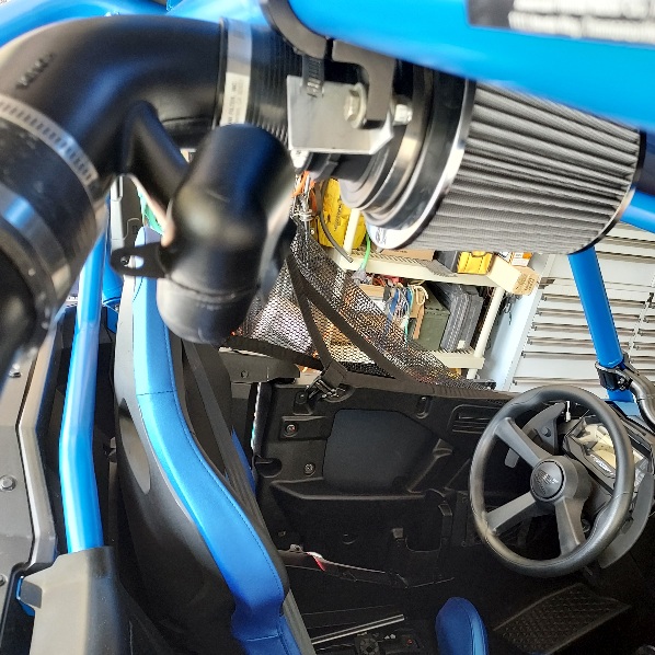

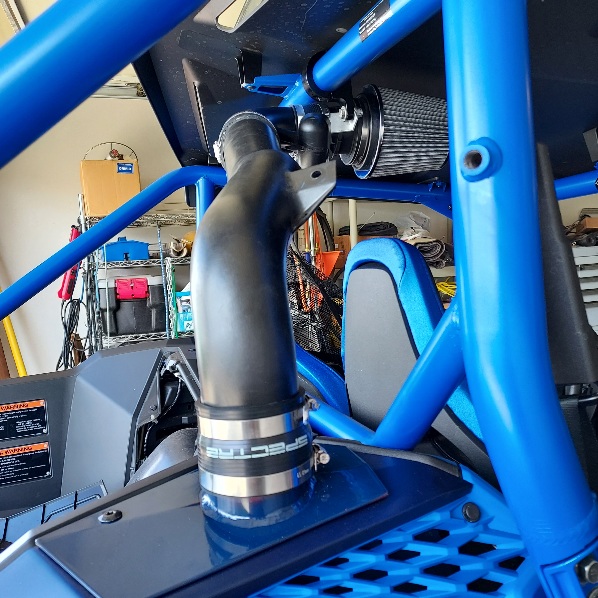

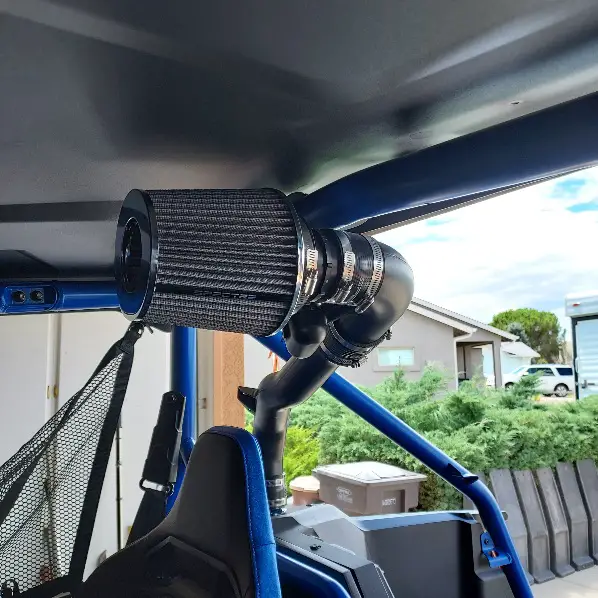

The 1080 snorkel pipe made it a lot easier. I used the 90-degree section of the stock ant farm pipe. The other pipe was from the Pioneer 1000. I get 8,000 to 10,000 miles out of the filter then just replace it. If you ride in heavy dust its ok for about 5,000 miles. It's a PITA to clean and reoil it. The under-roof location gets cleaner air and rain is no problem. The inside of the dirty filter is as clean as new, so it does a great job.
View attachment 399326View attachment 399327View attachment 399328View attachment 399329View attachment 399331View attachment 399333
