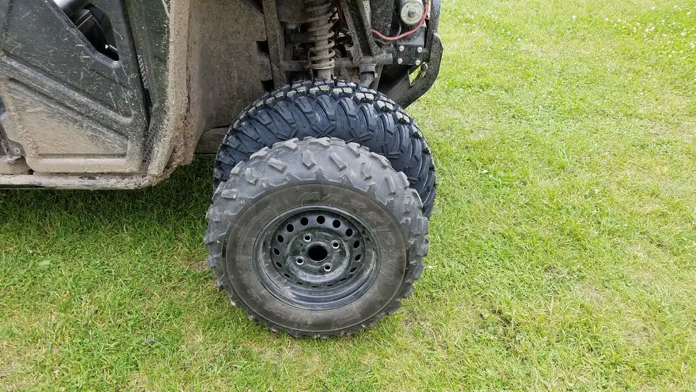

27" Tusk Terrabite radials on 4+3 ITPs here, we ride a lot of hard trails & sand, these do perform better than I expected in the mud.View attachment 68561

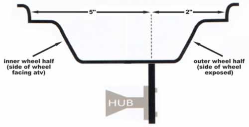

thanks....I read you as saying the P5 did not seem tippy with the stock tires, and does not seem tippy now with the larger wheels...that's pretty much what I expected given the increased tire weight offsetting the added height.........what does a 5+2 wheel mean? can you still get through 50" gates on the trail?
I made a mistake earlier, my wheels are 4+3 so they sit out a bit wider, I highly doubt I'd get through a 50" gate but we don't have them around here so I've never measured my actual width. I'd guess 53" or so, might be able to measure this weekend if you'd like.
The 5+2 or 4+3 is the offset, both are 7" wide wheels. For example on a 4+3, from the inboard edge of the wheel to the mounting flange is 4" and outboard edge is 3" from the mounting flange. So a 4+3 will stick out 1" further than a 5+2 and make the machine 2" wider overall.
5+2 rim = 7in wide rim. 5in from inner edge to mating surface, 2in from outer edge to mating surface. 4+ 3 is similar but sticks out 1in further than 5+2 (2in overall wider stance)
Stock wheels are 4.5+1.5 if I'm not mistaken. A 5+2 rim sticks out 0.5 in further per side than stock rims (1in overall wider stance). I don't think this makes them stick out wider than the widest part of the body, so you should still be good for the 50in trails.
hahah........I am an old guy, and I kept looking at that picture in wonder at what I saw, until finally the right perspective snapped into place, and the drawing made sense......thanks for the explanation.......
