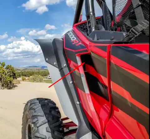

This filter does do one interesting thing though. It moves the intake to the upper fender opening and looks like it will drastically reduce the swirling dirty air introduced from the tire through the fender...
1626807327082
It puts the intake position here...
1626807557085
A little lower than stock but a much cleaner spot.

Relocating the intake to the side panel is an interesting take on the dirty air problem. However, this will cause a problem while washing the machine shooting mud and water into the intake tube. I have an X model and this side scoop gets full of mud.
I agree. Those scoops on my car are always packed with dirt and mud. The front tires on the R model are responsible for about 80% of how dirty the Talon gets riding/racing, I'm sure the X model is similar. Keeping it away from that scoop area and away from the inner fender well would be ideal.

Moved the intake from under the fender to a spot more likely to gather dust and mud.
The Jackson Turbo intake is pointed almost straight up into the fender and still collects mud and water. Even after we blocked off the two foward facing vents, water still finds its way in. They've since updated the instructions to drill holes in the bottom for drainage.
With thr K&N intake relocated to the side vent, any water that hits there will be sucked directly into the filter. Its the Pioneer underhood thing all over again. They only care about desert and out west riders, nobody builds stuff for east coast guys where it actually rains more than twice a year.
