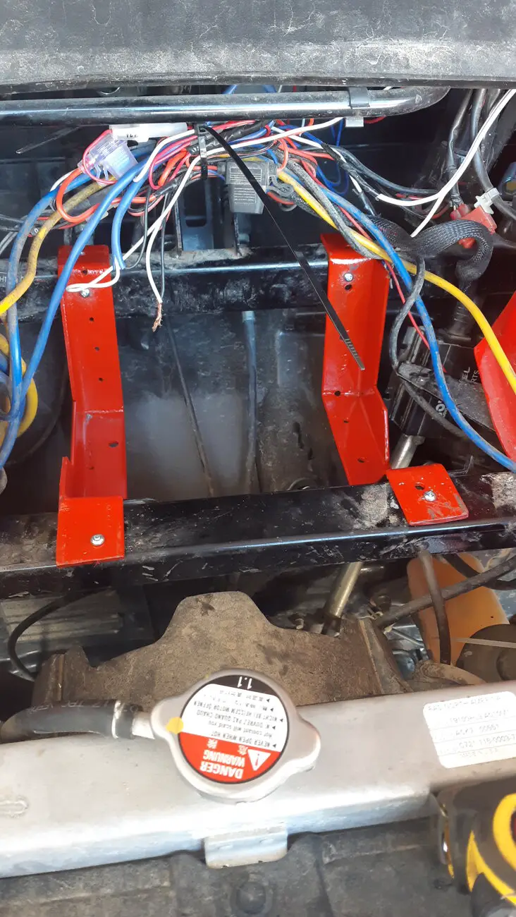

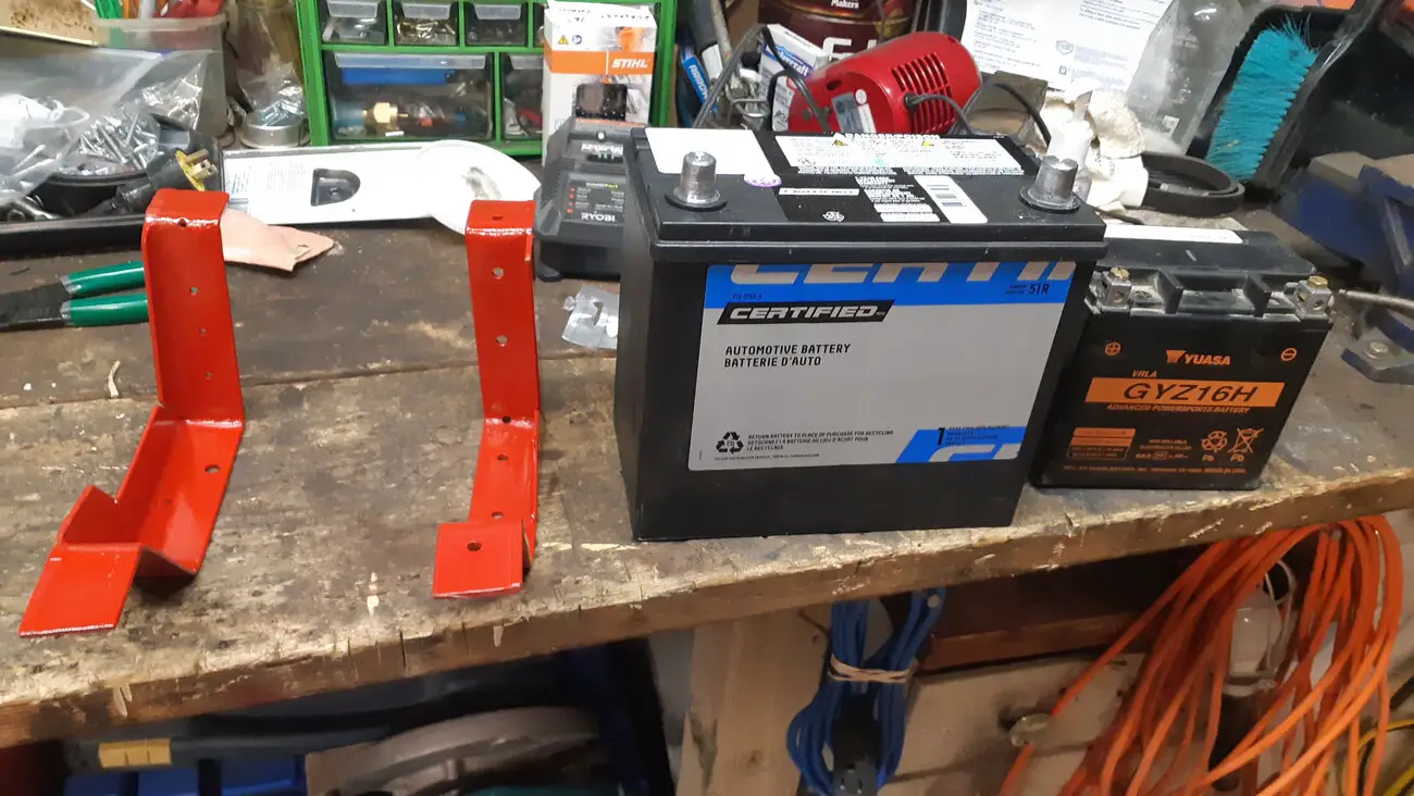

Yes original battery here in Canada is 16ah and I think it is 14ah in the states. Either way it is TOO SMALL. In my case larger battery helped some. It seemed to be starting better at colder temps but then just wouldn't go again at -15c when it had gone at -20V a few days earlier.

I can definitely feel your pain, and know it is very unnerving when it doesn't start like it should. I thankfully enough never had to deal with it anywhere then my drive way. If it didn't start early in the morning, I just had to wait until it warmed up a little then I could get it going. I went through the thread and saw your battery setup, but was just curious how you had it run. Does your secondary battery run to an idolator or back to the main battery? Also curious if you had a battery maintainer to recharge your battery? You talked about plowing so didn't know if it was completely charged after you were done.
I removed the old battery completely and just use the larger battery in the picture. 508 cranking amps think. Fully charged, sat over night @-20c, battery fully charged when checked at -15c the next day. Turned over like a banshee but didn't fire. Let sit two hours then she went first try. Nothing worse than intermittent issue but generally it is iffy whether it goes below -15C.

Actually that was 410 cranking amps in the new battery. The 500cr amp was too big for the under the hood.
