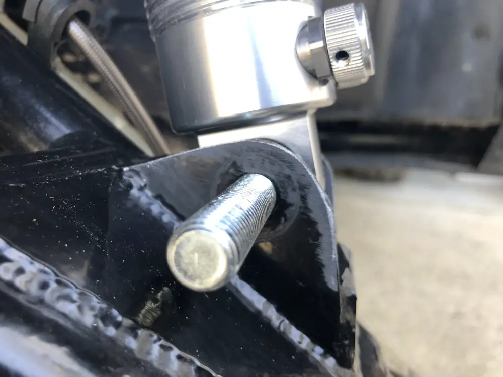

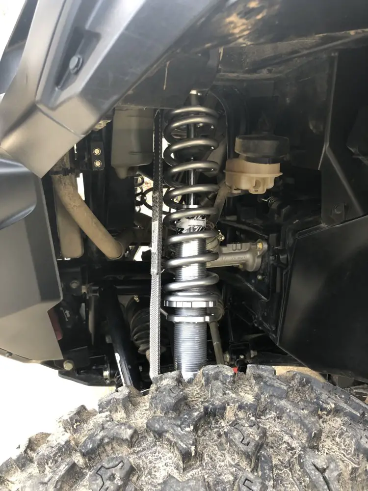

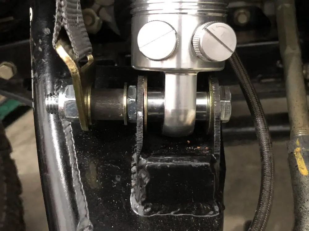

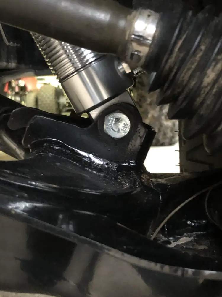

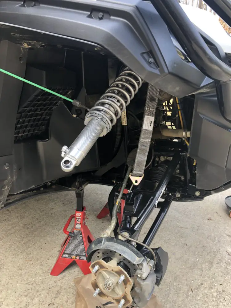

Got mine on over the weekend. Not making judgement yet. However Craig at 814 is awesome. Answered all my dumb questions and easy to contact. Right now my front end seemed to get the 2” of lift that most stated. However the rear didn’t. I was told to ride it and see where it settles so that’s what I’m going to do before making an judgment. Install wasn’t bad. Few hours and mainly it’s becuae of the grinding and checking clearance. As well as getting the bolt to bolt measurement right by setting the preload can take some time.
View attachment 108487 View attachment 108488 View attachment 108489 View attachment 108490 View attachment 108491 View attachment 108492 View attachment 108493 View attachment 108494
What length of limit straps are you running
Because a lot of people are saying 19" but a stock shock is like 19-5/8" on mine fully extended

  2. Other Brand
The straps stretch under load so they need to be shorter than the stock shock fully extended.
