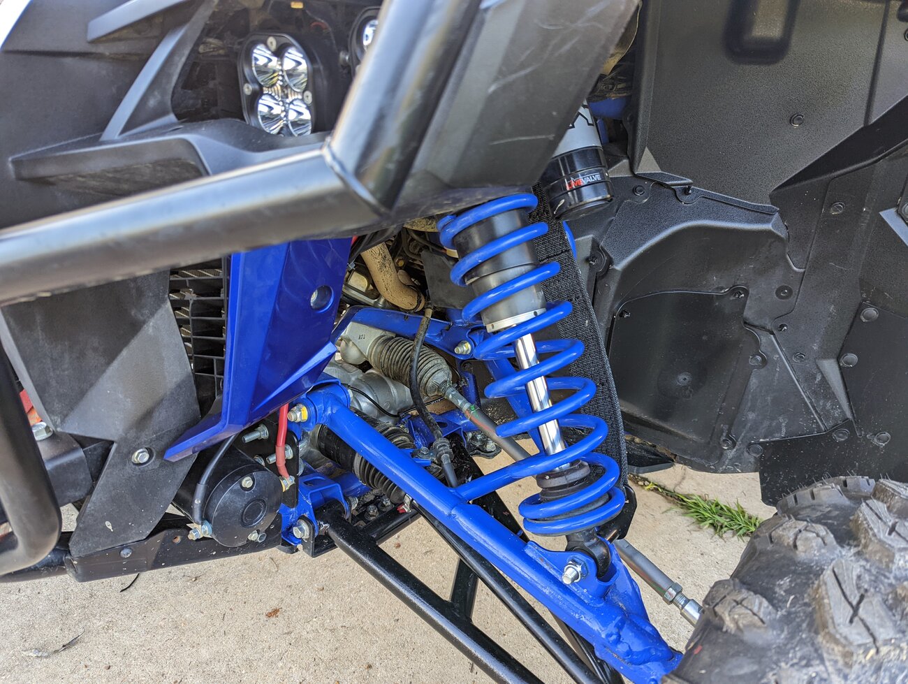

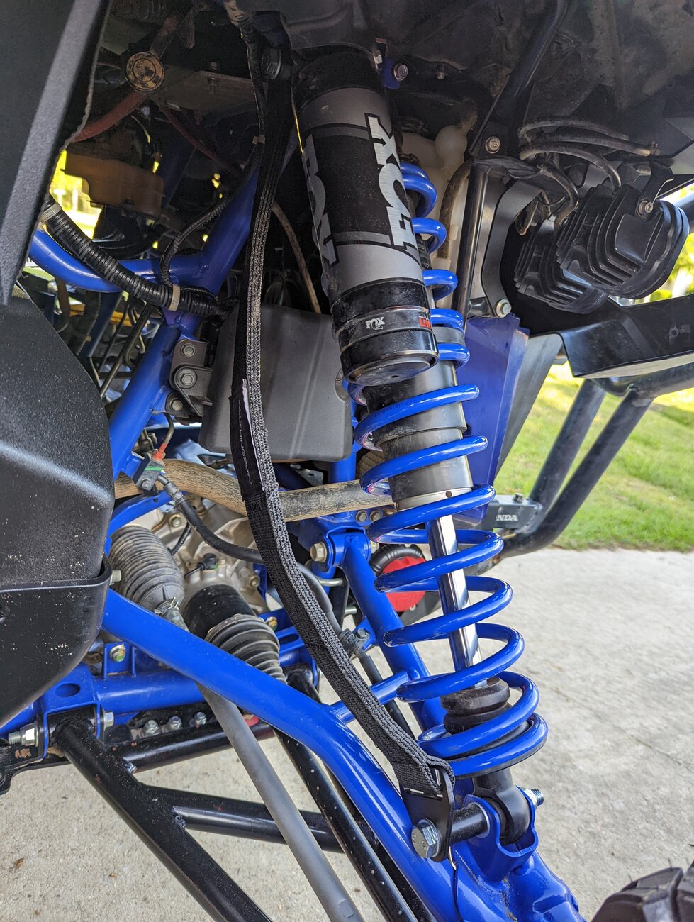

Not too thrilled about the AllthingzUtv limit straps. Lengths are correct but I'll need to bend the eyelets, get some washers, and a longer bolt to make them fit properly. Only did the fronts for now.

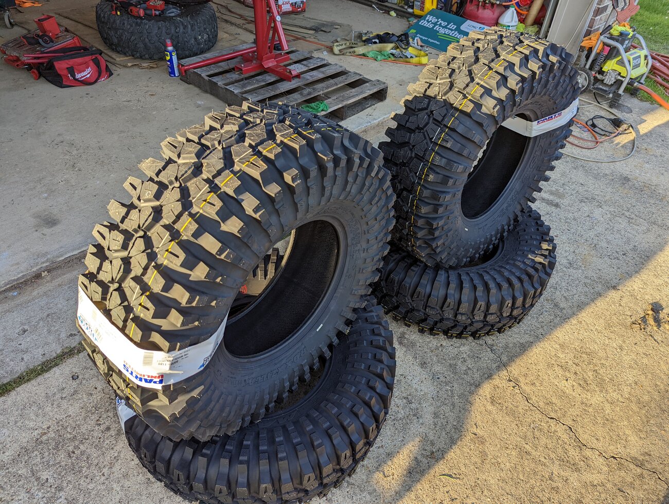

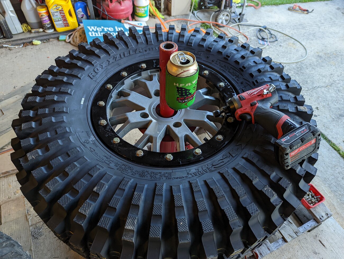

Brown Santa dropped off the Zillas about an hour ago so getting them mounted up now 👍🏻.

No 35s???
Why the limit straps?
Definitely no 35's haha.
To hopefully stop the ungodly clunk when the shock rebounds and slams into the bottom of the shock body. Lot heavier tires only going to make it worse. I think those terra hooks are 37lbs or so and the 32" Zilla stickies are 43lbs if I remember correctly.

I’m happy to report limit straps will stop the KLUNK. I got mine from Shock Therapy because they were the only ones I knew about. ST also said they’re really only needed on the front, but mine is an R, not sure about the X. I have several thousand miles on them and just recently had to tighten them a bit, the Klunk was returning. Fronts only.

Good to know. I was going to buy the ST kit but had read where a number of people were selling it after having shock work done since it clamps to the threaded portion of the shock body and would no longer fit when they backed off the pre-load.

I concur and only needed on the front. Built my own a couple years ago before anything was available. My home made are basically identical to the All Things UTV units (except I installed mine of the front of the shocks) and have worked perfectly for a couple years.
$90 per axle is surprisingly reasonable considering the straps are over $50. By the time I figured out and sourced the bolts, spacers and a 12mm drill bit (couldn't find 12mm spacers), I was into mine around $75 and a bunch of time. Had I found those, I would have jumped on them.

I was going to mount on the front but the passenger upper bolt looked like it would be hitting the radiator reservoir. How did you mount them? I'm going to pick up some more spacers/washers and correct mine this weekend.

My upper spacers are shorter then the bottom. I used the shortest spacers that would work, 1" top and 1.25" bottom (1.5" bottom would be better).
The straps do contact the springs when extended but I am OK with that.
