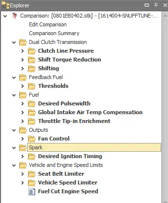

@snuffnwhisky worked a little magic. There are a few of us running it now on the Talon. Here's what he updated versus the stock Talon tune:
1650208827096
It's A LOT better on the bottom end when you are slow crawling. Got rid of most of the torque management so it doesn't bog down when you try to bump up against something and go. I haven't had a chance to really rip on it since I had the kiddo on it's maiden voyage, but it was noticeably better in the slow rock sections.
@CumminsPusher this is what I was going to call you about. Snuff is brilliant, I copied his valving for my Elka's, works great even on a P1.

I did a lot of Dragy runs and datalogging on Remi's machine. 15% faster to 10mph and 5% faster to 60 mph, all stock with 31" carnivores (KRX Takeoffs). I do need to get the other Stock files. If anyone has a PV3 and can email me your stock file, it would be great. I currently have 1614003, 1614004, 1614005 & 1614006. don a@t nexaninc d.o.t com
That aint no joke!
when @joeymt33 and I took off in low with mine from a stop, the G’s were insane and sucked u into the seat for 3 whole seconds easly.
todays run I got to 55mph before a turn so I had to back off lol. But n the sugar sand it was still quite faster than what I remember in a stock set up machine. shifting is also improved and smother from gear to gear and going into gear.
Snuff, you once called it a RIPPER
when u gave it back to me. That is every bit true and i use that to describe it when Im asked.
Will I need a PV3 to do any of the tuning from you or is it just a flash? If so I can pick some up and send you 2 files off mine....
U will need a PV3 to flash the machine. It can be yours or someone elses but a few more steps if someone elses. Got to buy a license from DJ if using someones PV3, $225.
