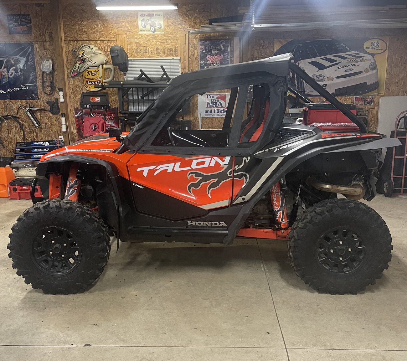

Put the 1.5" risers in today. Much improved line of sight
Did you make those or are they a kit? Got a link if so....I think those would work for me too!!

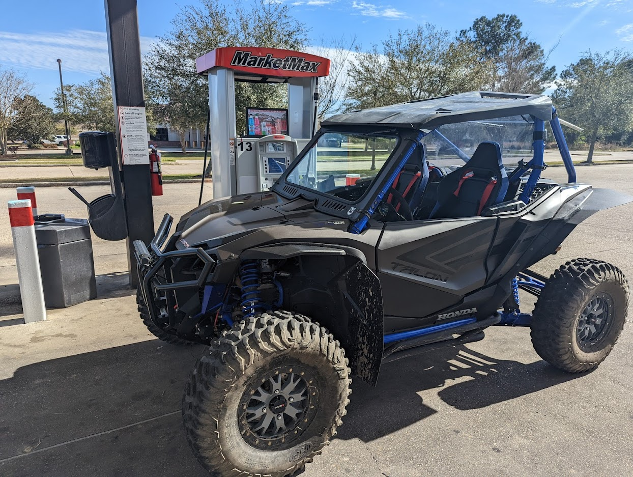

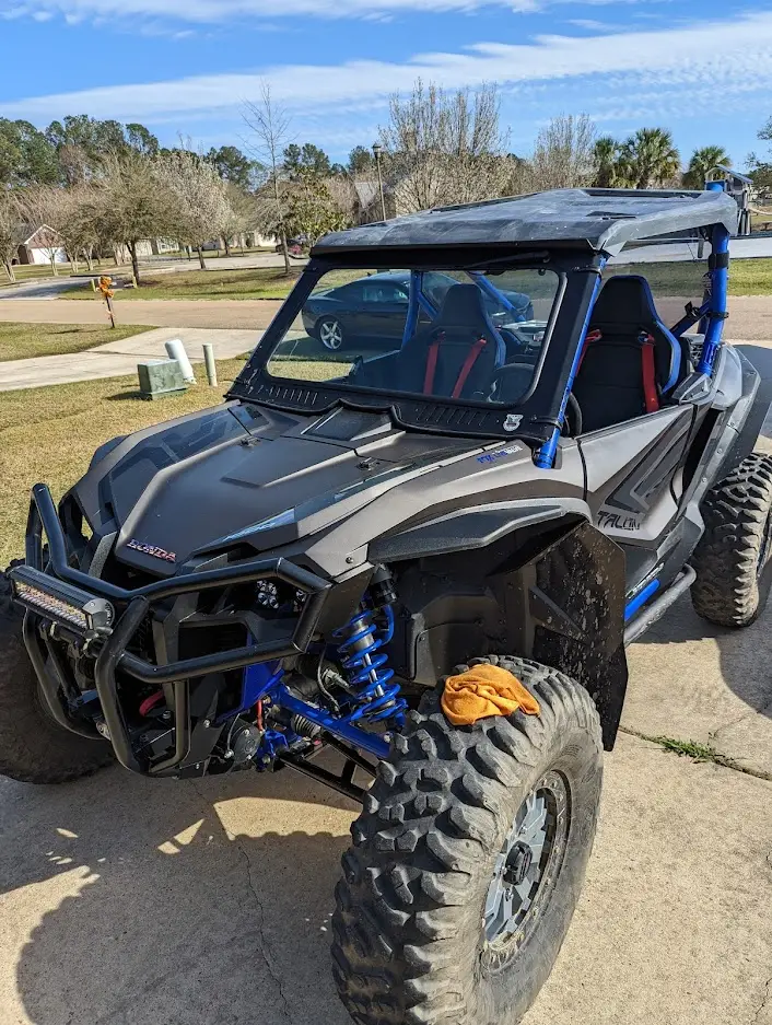

Sooooooooooooooo much better with the glass windshield! View is perfect now with those risers installed. Can't say enough good things about @SuperATV shipping, ordered it yesterday morning and it was delivered at 10:30 today!

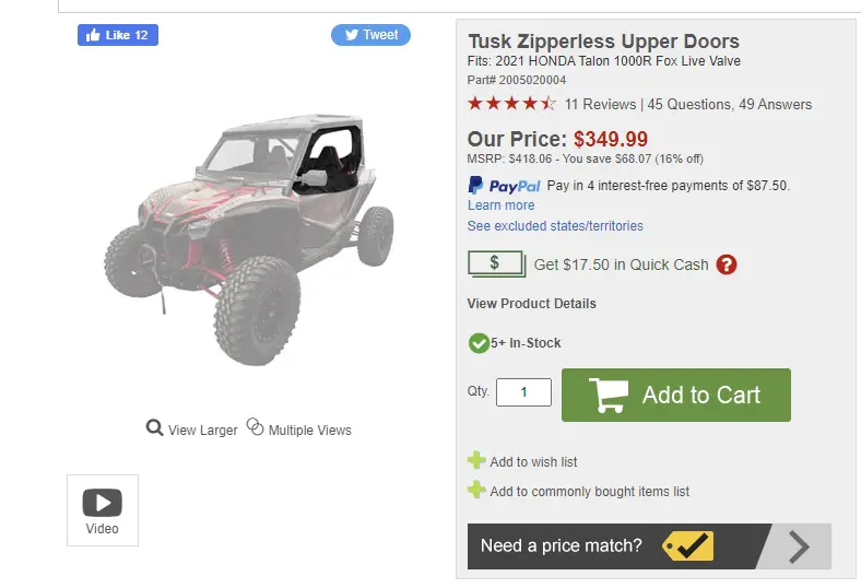

Ordered these today. Been looking for something "cheap" that would work with the SATV glass windshield. Couldn't find any reviews or others that have the same so I went ahead and ordered. I think it'll work out....

I will be interested in hearing how these end up doing for you. I went through 2 of the Honda ones before I gave up and told my wife to bundle up!!😀

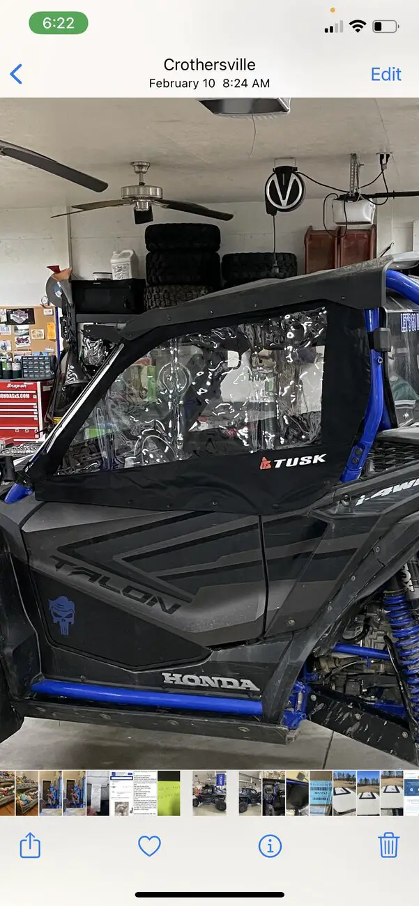

Let me save you some grief, send em back!!!!
I ordered these not long ago because I liked the idea of no zippers. They want to fly open around 40 to 45 mph. There are 4 peel & stick magnets that go on the lower fender & door on each side. I had problems with these coming off. I ended up ordering different magnets that screw on, this helped with that issue but the doors still want to fly open. I used a small bungee to keep the doors from completely busting loose and flopping in the wind, but this still allows them to break free from the magnets at speed. I argued with Rocky Mountain about their design issues & they admitted fault. After it was all said & done they took care of me. I have them on my machine now and they’re good for the woods but that’s about it. If it wasn’t for the 20 holes I put in my machine during install I would have loved to walk away with a refund, but like I said they made it right & they work half a$$ with a few mods.

Well s*** where were you when I ordered them?! Lol I appreciate the heads up.
