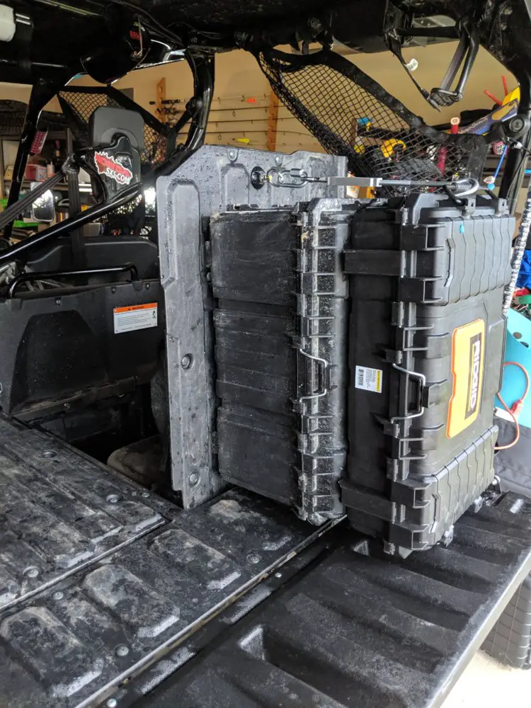

Got tired of fighting the ratchet straps on my Rigid boxes so I added some quick disconnect mounts and used turnbuckles. Came out pretty good! Everything came from Home Depot:
IMG 20190730 181540 IMG 20190730 181538
IMG 20190730 194948
IMG 20190730 190218 IMG 20190730 190309 IMG 20190730 194742
I'll probably get a longer threaded rod with hook for the side of the turnbuckle that has the open hook so I can do away with the link on the top box.

Here's the boxes with the turnbuckles installed and the seat flipped. I grabbed two 8" clothesline hooks so I could get rid of the top link I was originally using. I'm debating on adding these quick disconnects to the sides of all of my Rigid boxes so I can still get in them without having to undo the hooks for the turnbuckles.
IMG 20190801 190253
IMG 20190801 190403

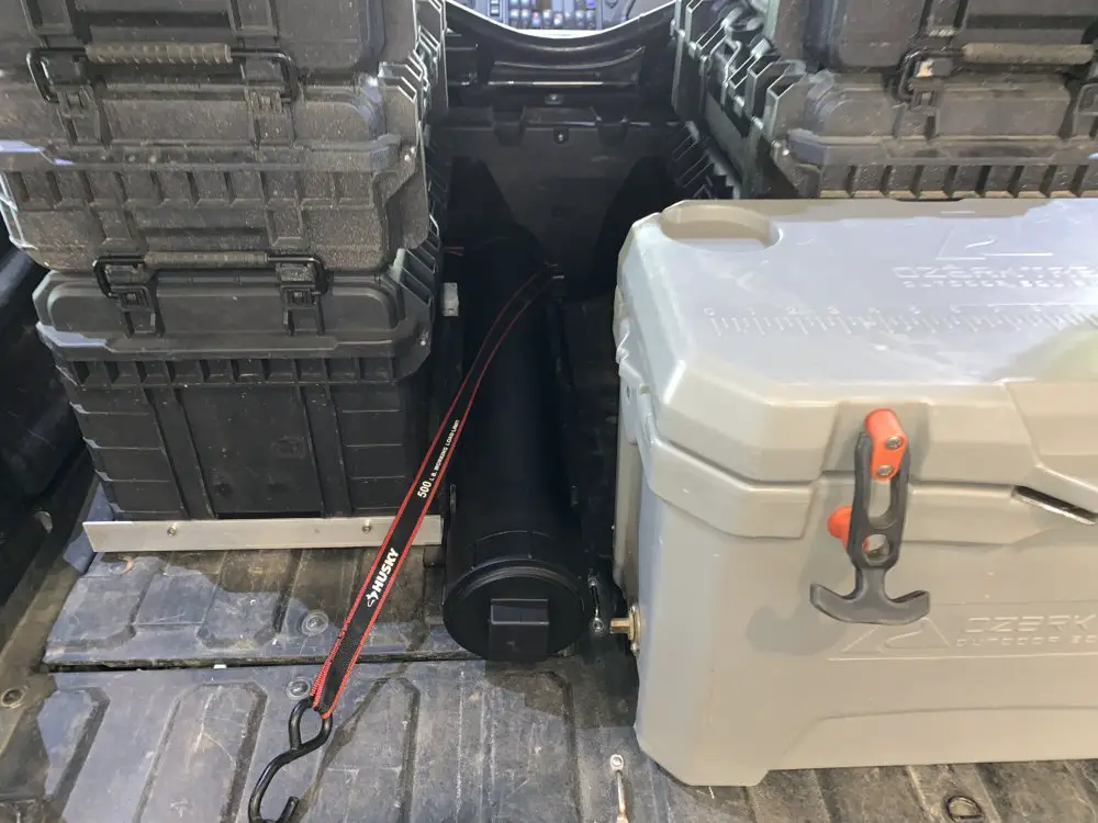

There’s several ways to anchor them and get into them that people have used and @knuckledeep is making a base mount too.
This is before I did turn buckles for the cooler. The aluminum angle is bolted to the bed using nutcerts. Stayed through Tackett and Takeover this year.
75278F59 9717 4BA2 9F64 4B41FC767F4B
I looked at yours and had all the stuff in the cart to do them that way when I found these little quick disconnects for about $4. I like that they are flush with the bed ridges when the clip is removed so I don't have to worry about removing anything, just pop the clips out and toss the whole thing into the box.
Like I said more than one way. My way fits my use and was cheap for me. Cost me more in time than material.
