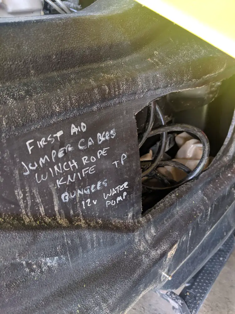

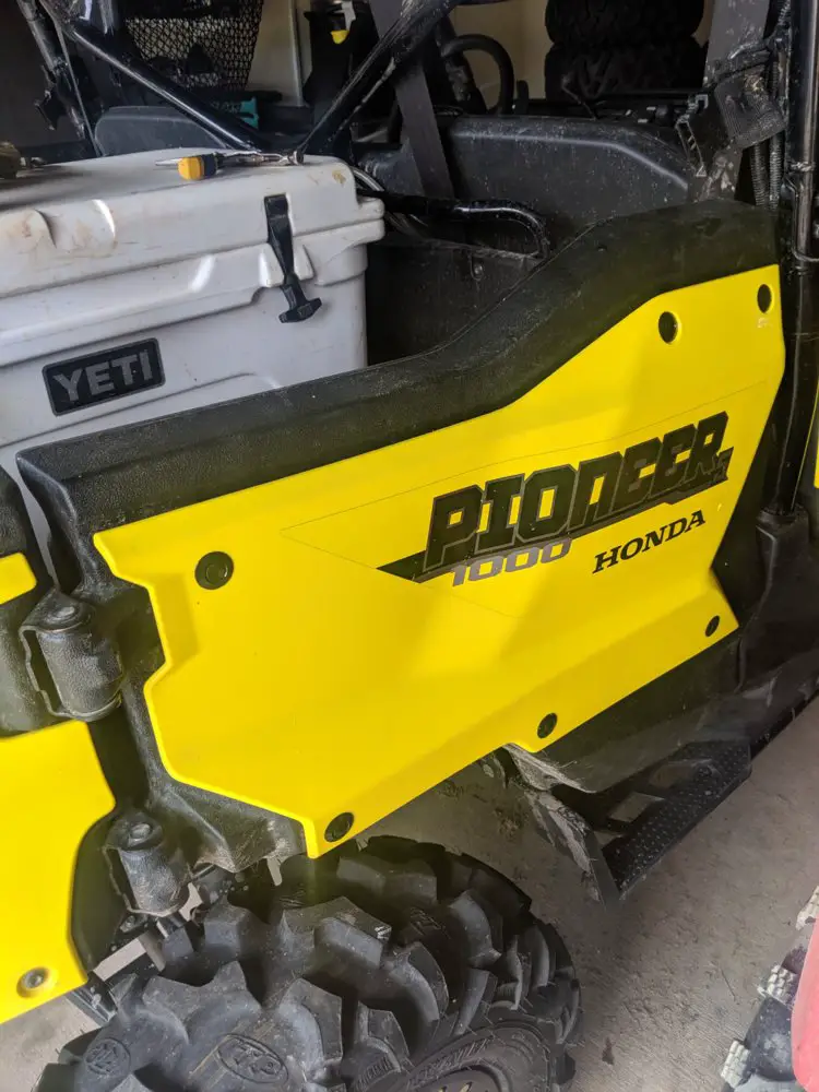

Went ahead and did my other door mod today before it started to rain. Moved some stuff around and wrote on the door what was in each.
View attachment 150042 View attachment 150043
I need to do this! I added the panels to mine since it was originally a base model. I believe the fasteners are different, guess I should look into what I need to make it work.
