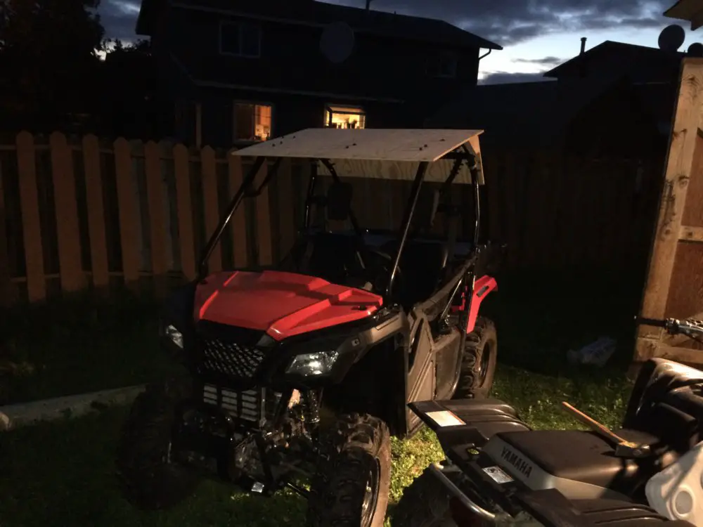

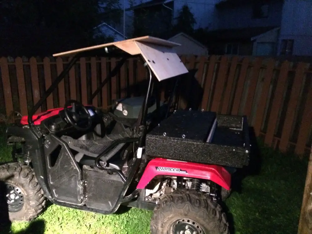

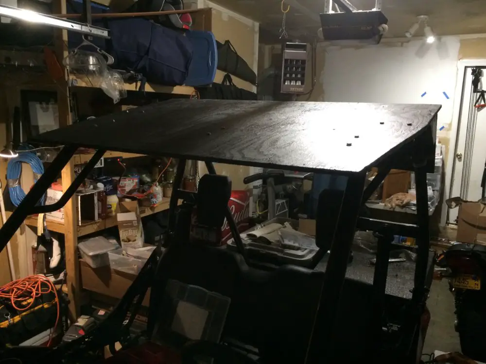

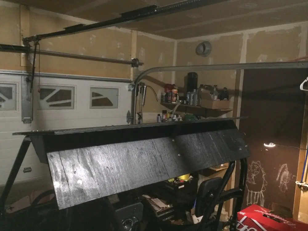

The roof worked so well I trimmed it up a bit and painted it black. I replaced the wood screws with stainless bolts and lock nuts and added a small gusset in the back area.
IMG 8157
Ignore my garage, its a disaster and there is just $h!*t everywhere. Too much working and no time for anything else lately.

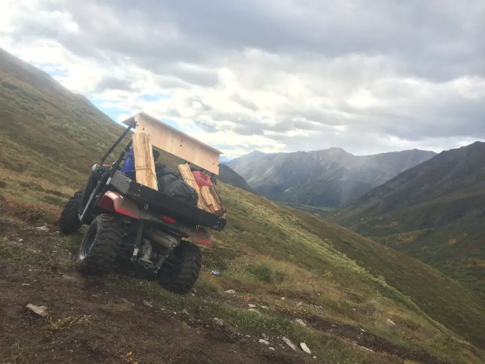

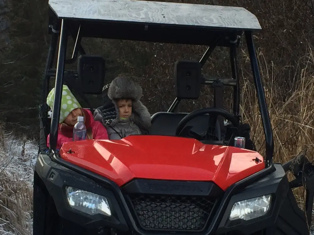

Had to build a quick roof for a last minute moose hunting trip. No moose, but it was a good time.
I went cheap because the roof was only supposed to be for this one trip. I lined the pipe brackets with some adhesive backed foam and put additional pieces between the wood and ROPS. It held up pretty good through the trip, made no rattles whatsoever.
So I'm a bit anxious to remove the rear stabilizer bar because on the way up here I spun out, getting slightly sideways. It only felt like maybe 30 degrees or so from straight uphill, and the front wheel started to come up off the ground and I thought I was going to flip backwards.
So I used about 4 gallons of gas (full tank) on this trip. My buddies Viking also used around a full tank, which I think is 13 gallons...
Yep, loose that ASB. Beautiful country you guys enjoy up there!!!!
