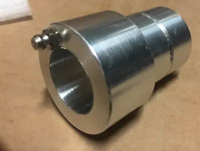

Sooo, I just got this in the mail (bought it by accident) originally had one like TripleB mentioned in my cart and for some reason ended up buying both 🤦‍♂️
The 40mm @05Willys linked DOES NOT work, the phucker won't go in 🤬 sorry bud. I guess I have to wait 'till Monday to try the one TripleB linked.

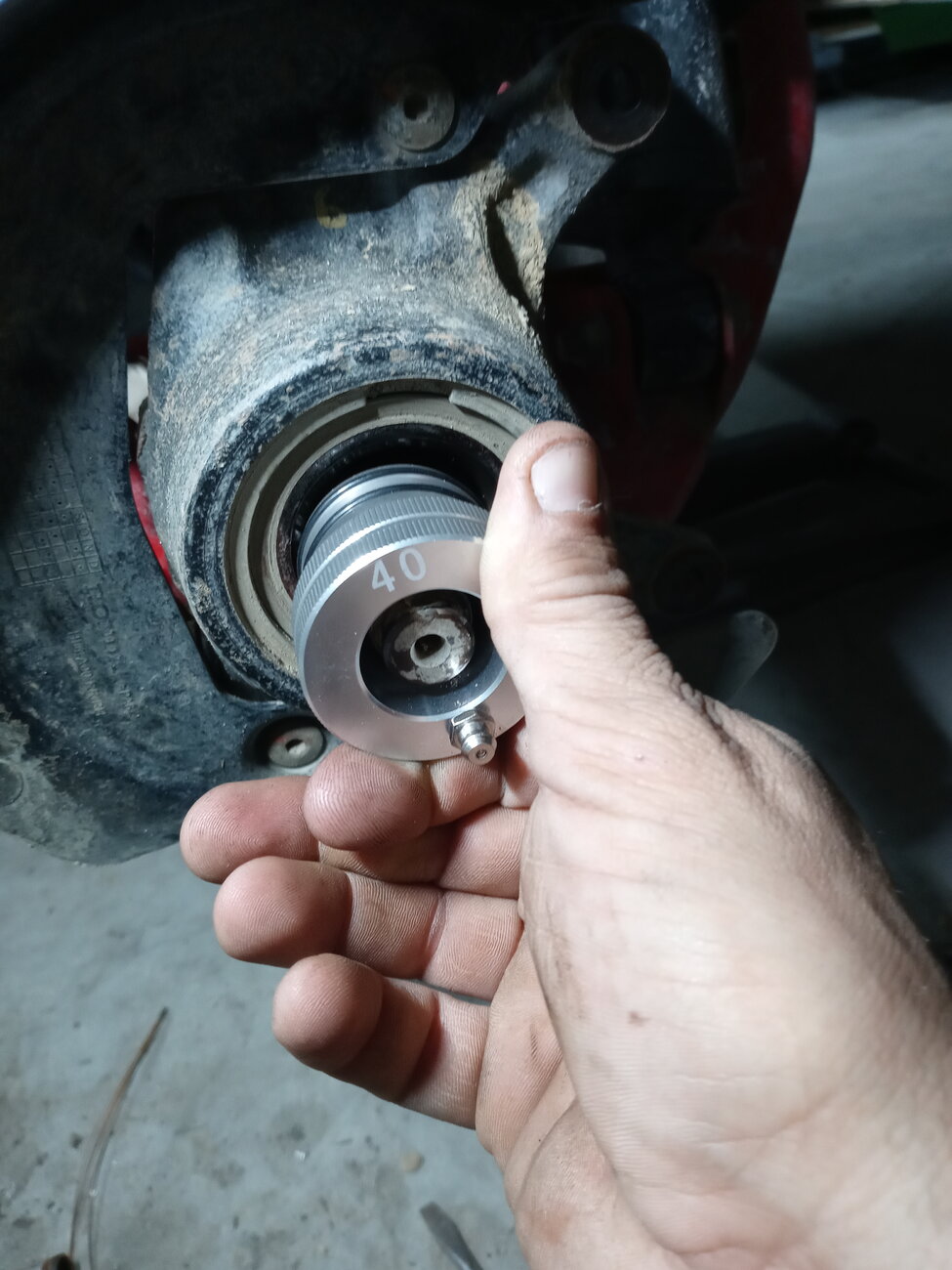

I just looked up the invoice for the one I bought from Machined Integrations (works great.)
Pioneer 1000 Over Axle
Variation: MI-OTA-1150-40MM - Over Axle Greaser
SKU: MI-OTA-1150-40MM
It's 40mm, and fits perfectly - so at least that part is right.
Thanks for the update. Is the issue with the ID, OD or both? May have to bring mine to work and modify. Or just buy one that works.🤔 Nah, that would make too much sense. LOL

The ID is too small, can't get far enough to know if the OD works or not
The one I bought, haven't tried yet, is the two O-ring short version and looks like yours. OD is 39.91mm. There are two ID's. The first larger, at entry end, is 28.83mm, while the majority of the inside is 26.60mm.
If you have a caliper handy to measure yours, and/or tell me what the ID should be to fit, I'd appreciate it, so I can "fix" mine in advance of needing it (my machine tools are a ways away at the airport).
It's THIS ONE on eBay for $11.00 w/free shipping. I can't make one for less . . . but if I need to open the inside a bit, I can do that easy.
Yup, that's the same one I got. I'll try and get exact dimensions in the a.m 👍

So the MI one looks well built but it does look like you need to remove the half shaft to grease. is this correct?
still looking for one that does not require Half Shaft removal and will slide over.
Assuming you're referring to the axle as a half-shaft, it does slide over.
You remove the brake caliper, then the axle nut. Pull the hub, then the greaser goes in over the axle shaft.
Awesome. thank you for the info. the video on the MI site doesn't seem to make that option clear.

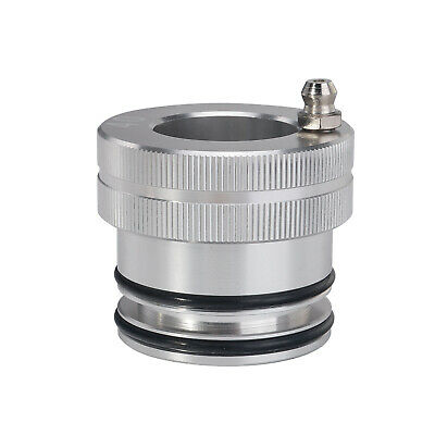

for fun and because i don't have enough tools:
I've ordered the one noted in post #5.
Also for fun, ordered a different one.
i'll do a comparison when i can.
S l400
40mm Wheel Bearing Greaser Grease Tool For Honda Pioneer 1000 Polaris Ranger 800 | eBay
Double O-Ring seals to keep the grease inside your bearings, which also spread the inner bearing races apart to allow a gap for the grease to easily flow inside. This grease tool will replenish the grease your bearings need, as well as push out contaminants.

You'll find the seals are an unnecessary addition. The one without the seals works very well and it's a slip fit into the bearings. You won't find any excess grease on the tool after use
