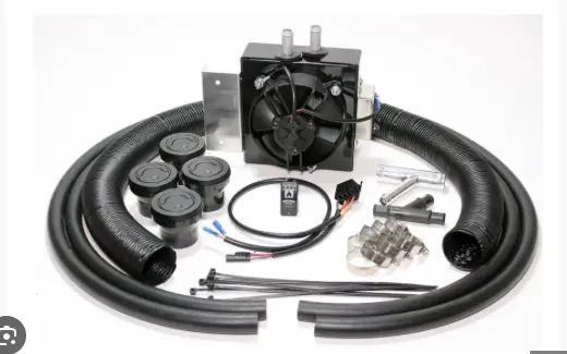

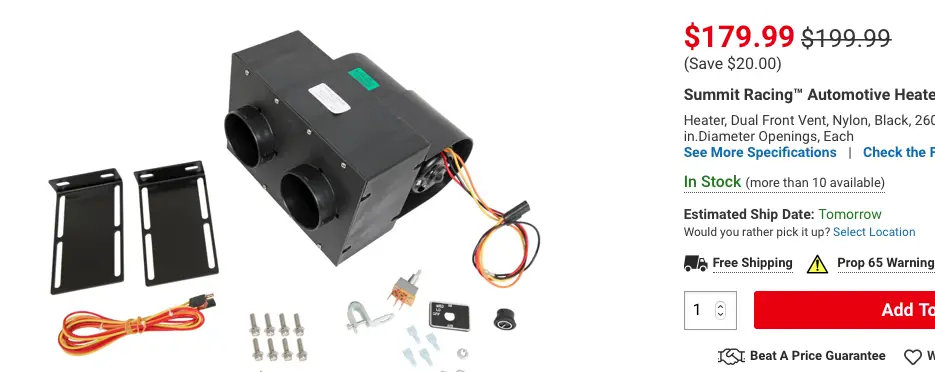

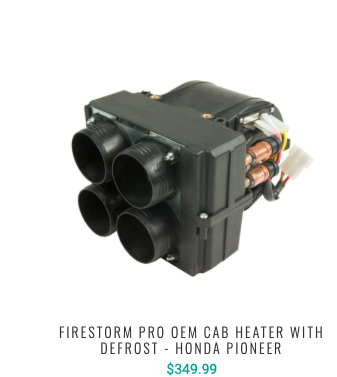

So for me I think I have narrowed it down to the summit racing heater or the Firestorm, Inferno. I know that right now for black friday the firestorm heater is on sale on amozon for $279 from $350. Can anyone way in on this issue witch one to go with, and how well they work? The firestorm has more vents but not sure witch one has the most heat output or BTU's Thanks

I used the inferno but I looked hard at the summit. The summit had a much higher btu and blower. I kind of wish I'd of tried it. It was cheaper but not a whole lot by the time you got everything you needed to complete the install. I will tell you, if you have a windshield you should mount some type of defroster vents to blow on it or you'll be ragging it all the time. I heat works OK if your going slow. If your moving down the road and it's 20 out, you can't seal all the air leaks in these things the way they're designed.

I'm satisfied with the Inferno installed in my Pioneer.

As far as defrosting vents….I learned the hard way you don’t want them if you’re mounting the heater core under the seat. They don’t work worth a dam anyway because of the huge pipe run ( if mounting heater under the seat) and you risk the duct getting wrapped up in the drive shaft and taking out the subtrans seal ( happened to me). You’ll get way more heat output if you put all 4 vents on the floor. Maybe the in dash version is better as long as you’re not passing ductwork under the floor.
