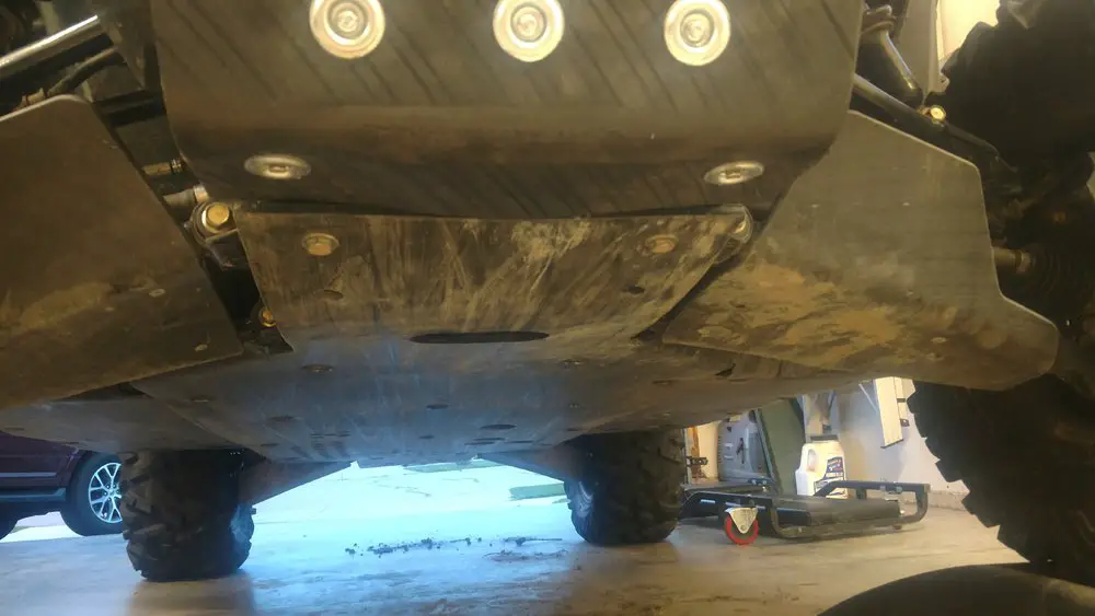

I think 3/8" is more than thick enough. I like the center single piece of the factory UTV, I made my skid similar to theirs. The big thing is having enough fasteners. If the span between fasteners is 12-16" you wont see much for flex in the skid plate. I've used mine as a jack point with no issue picking 2 or more tires off the ground. I've also hammered it on rocks with minimal damage. Certainly damage that would have been much worse with aluminum and not likely avoided with another 1/8" of material.

600 miles since January and I'm really happy. They are awesome in the snow. You can basically get buried climbing snow banks and the pioneer turns into a sled and slides off ice and snow obstacles. Last weekend I hammered rock climbs and had all 4 tires off the ground several times and rocked the machine on the skids alone. Hardly a mark on them.
