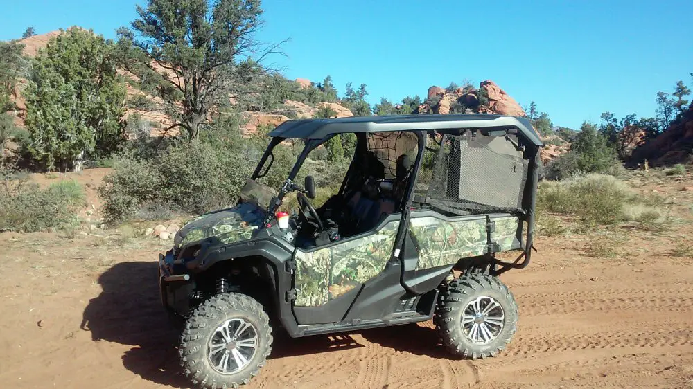

I had a great weekend ride so i will gladly share. IView attachment 11042 did a 102 miler in the mojave desert on saturday. no issues at all. machine ran so good. i use lucas addative to fuel 2 oz per tank and noticed 24 mpg on my trip. i am very happy with this . i now have 530 miles on my SXS.
Have you had it up north on the Paiute trail yet? I'm buying mine this month and can't wait to get it down there this summer. We're planning on doing Sand Hollow in April and then an entire week on the Paiute this summer.
when i purchased it in October 2015 i took it up to my mountain property above Salina creek and rode for the break in period for a day . i can't wait any longer for the snow to melt as i have some serious riding waiting for me this spring and summer. rode some of the arapeen trail system on skyline. 1000's of miles up there .
