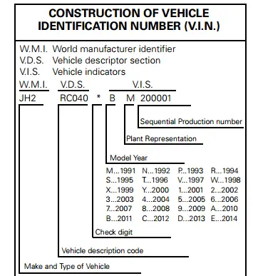

Sorry I don't know how to decode the VIN but mine is, 1HFVE042XG4000292
Interesting. In your VIN you have 042XG where I have 0461G. Wonder what the differences mean.......
Waylan
This is a little old, the Big Red and P700 are covered but not the P500 and P1k:
http://powersports.honda.com/documents/support/2011-2014 VIN Guide.pdf
Also it is short on detail, There is no list for the vehicle description codes.
I would guess the different codes are for 3 seat vs 5 seat, what grade, not sure if color is included.
So basically I have nothing....
Here is the 2016 Honda Pioneer lineup model # vs. VIN# series.
NOTE: the Model with AC is the CA models.
For example a Silver 1000-5 Deluxe the model # is SXS1000N5D3A with VIN# starting: 1HFVE04P-G4000001 - etc.
The Camo model is SXS1000M5PA etc. etc. letter & # combo specify its color and model type 3 seat 5 seat EPS deluxe or not.
