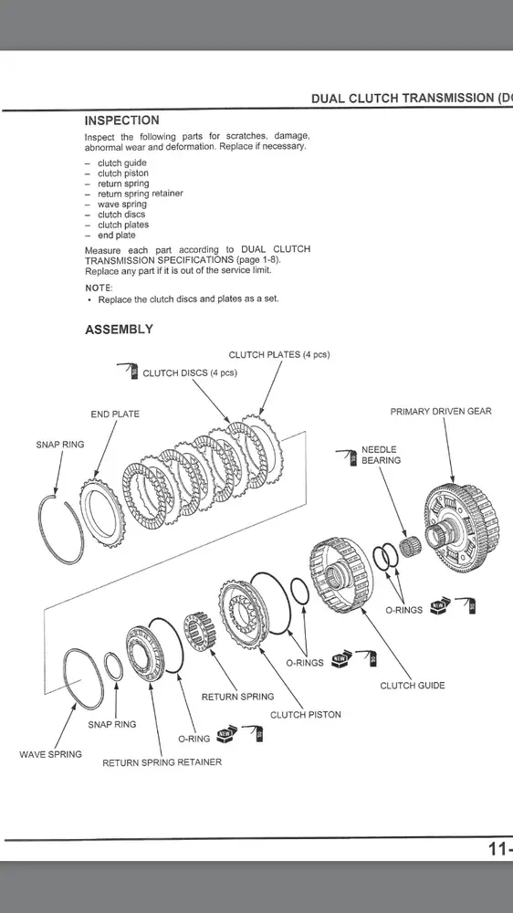

exactly!!!!! but without actually seeing the clutches apart i can only guess but im still leaning towards the springs if honda used the identical clutch set as in the africa twin then it was designed for something almost 1/3rd the weight i do know for a fact the more pressure faster on a clutch = less slipping longer lifer and stronger faster shifts and it doesnt matter the application its just the truth about a clutch
If I remember correctly. The African Twin has 3 clutch plates, the Pioneer has 4. This was thought to improve durability.

The coil springs in the clutch pack are to disengage the disk when oil pressure is released. The clutch basically works the same as one in an automatic transmission. With it being like a hydraulic cylinder pushing against the clutch pack, the force is a lot greater than what a spring can do in a regular clutch. If the piston is 4" OD with a 2" bore at 100 psi of oil pressure gives you almost 1,000# of pressure on the clutch. I believe a hopped up Harley clutch is 300#-400# on the pack.
