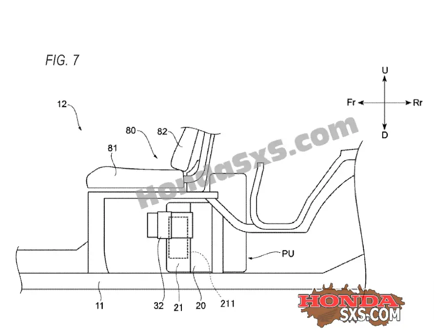

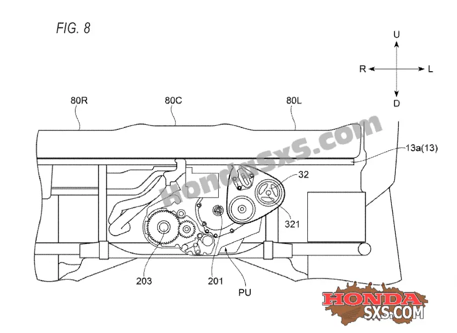

HondaSxS.com has obtained leaked photos revealing the HVAC system that Honda plans to release in the upcoming year. Unfortunately, it appears that the beloved Pioneer may be getting a belt, although some information suggests that the compressor may be shaft-driven, contrary to what the images display.
The exact release date is still unknown, but it is highly likely that it will be announced next year. Our best estimate is for a 2025 model release, as Honda typically unveils at least one SxS update each year, and this seems to be it.
However, this update will only be significant if Honda also delivers improvements to a fully enclosed cab system. We all know that the previous enclosures have been quite inadequate.
There is an upcoming dealer redline announcement. Cross your fingers this is it.
Thoughts?

Can someone tell me more about these pictures? I'm not sure what I'm looking as far as HVAC system

Well you have a condenser that has the compressor that compresses the refrigerant to an evaporator and fan blows against the evaporator for cooling. The condenser that has a coil itself called the “condenser coil” also needs to have a fan to cool the hot gas of the refrigerant cycle so it dosnt boil coming back to the compressor thus causing no to poor cooling or worse, catastrophic compressor failure. They will also be equipped with a high and a low ambient pressure switch.
In the pics its difficult to tell exactly how they have it configured cuz the cycle and the parts are not a labeled legend with the numbers, but it looks as if the evap coil and fan is the small box at the front under the dash and the compressor is located where the pully and belt is.
A compressor either needs 110 to 240v or a pulley/clutch system to make it work. Now you know why it takes alot of elect power and HP to make one operate effective and efficiently.

I’m a refrigeration tech. Cooling the condenser is where this will fail. Improperly cooled condenser causes improper pressures which cause poor cooling and strain on other components.
