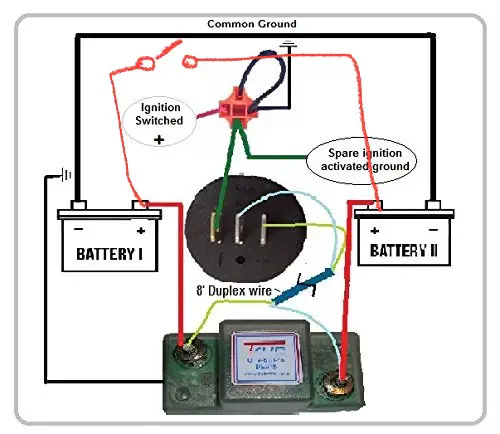

If you wanted something under the hood like you said, you could use a turn switch like this.
Wire it in like this.
Emergency bypass

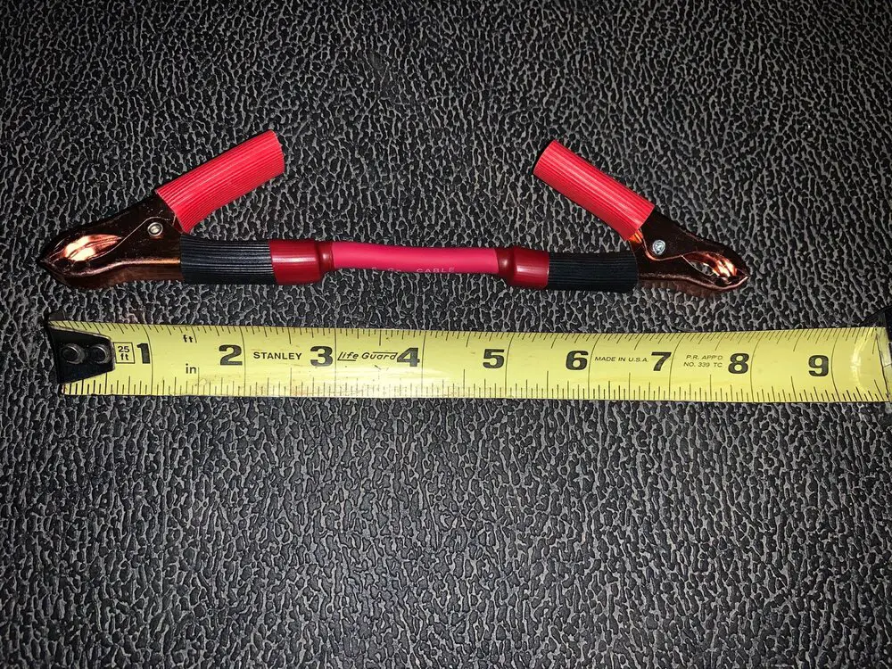

Similar to Hondasxs, I made this short jumper wire to go across the Isolator Terminals.
Easy to store. One person can install it quickly, no tools needed.
Nice job . . . but I see you overlooked a potential problem. You have the red wire hooked up to the negative (black) side of each clip handle. That could easily confuse most dumber electrons (or even queer electrons that blow fuses) to cause a high resistance connection or even the dreaded "reverse polarity, high resistance short circuit"!

Nice job . . .queer electrons that blow
Blow watt ???
The old clips were bare copper. I found some vinyl tubing, shoved it on there and held it in place with the black shrink wrap. I was out of red. Then a few days later i purchased more red shrink wrap and installed it on the outer clips.
That’s why I mentioned “across the Isolator Terminals”.
I appreciate your attention to details. I surely wouldn’t want to confuse anyone.
It’s so easy a caveman can do it !
When I do loan it out, I require the individual watch a 13 minute instructional video and sign a release form.
Can’t be too careful these days.
Thank You Kind Sir !
