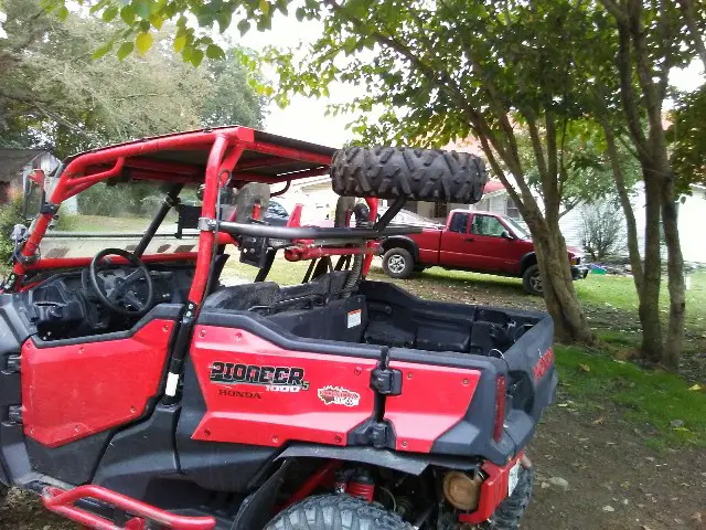

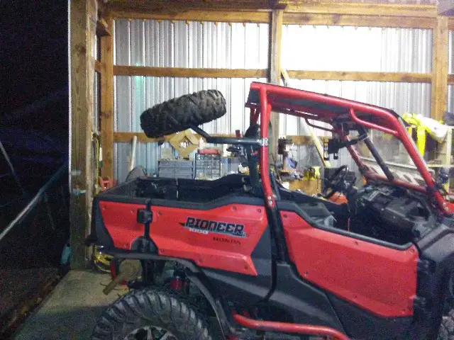

Thanks bud. Been meaning to attempt this for a while. Frees up bed space, protects tire (except rollovers lol) and still have rear vision. Heres earlier pics before i added some angle to it.
