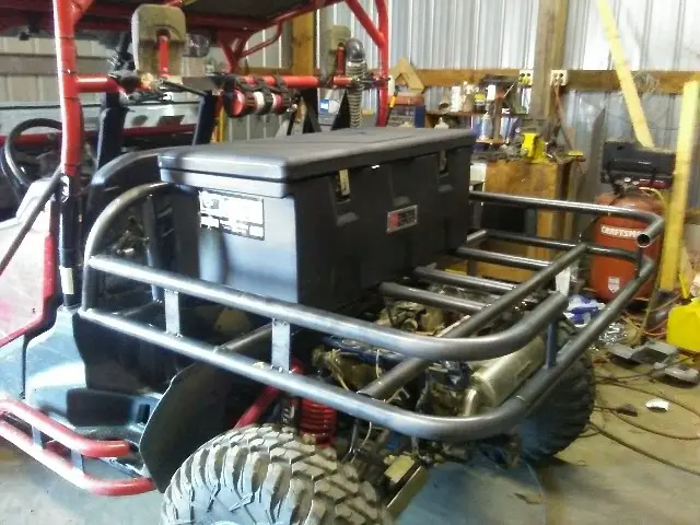

Debating on floor material. Thwn i noticed a 5x10 sheet of 18ga in back of shop. No sense in buying some exotic plastic when material is already available.

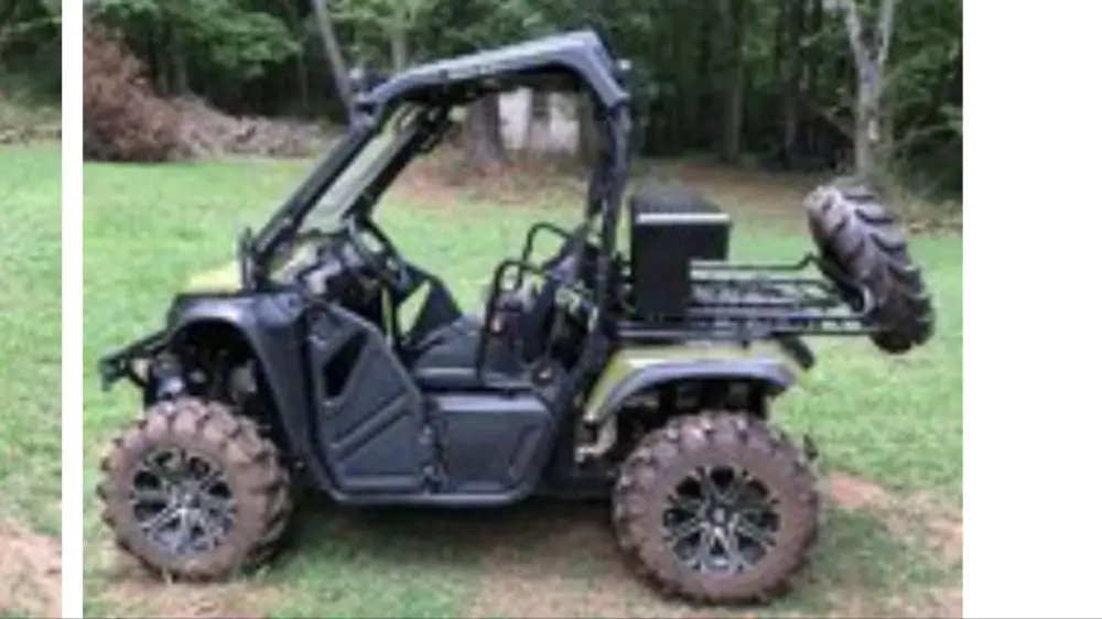

@Delton I’m starting to think what your doing is transforming you P1k5D into a P5:confused::p
89420152 16CE 4867 916C 98B8E5E6E5CD

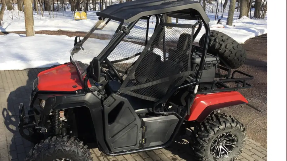

Really like the way this spare tire is mounted on these P5 ‘s would look cool on your P1K5D

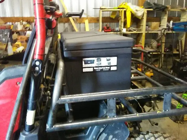

Gotta figure out how to mount rear section of my mudflaps. Got a very cool taillight mount coming soon too.

Finished welding tubes and boxed in latches. Tacked in front section of floor and test drove for rattles. Slight rattle so i went back and plug welded floor to support tubes. No more rattle.

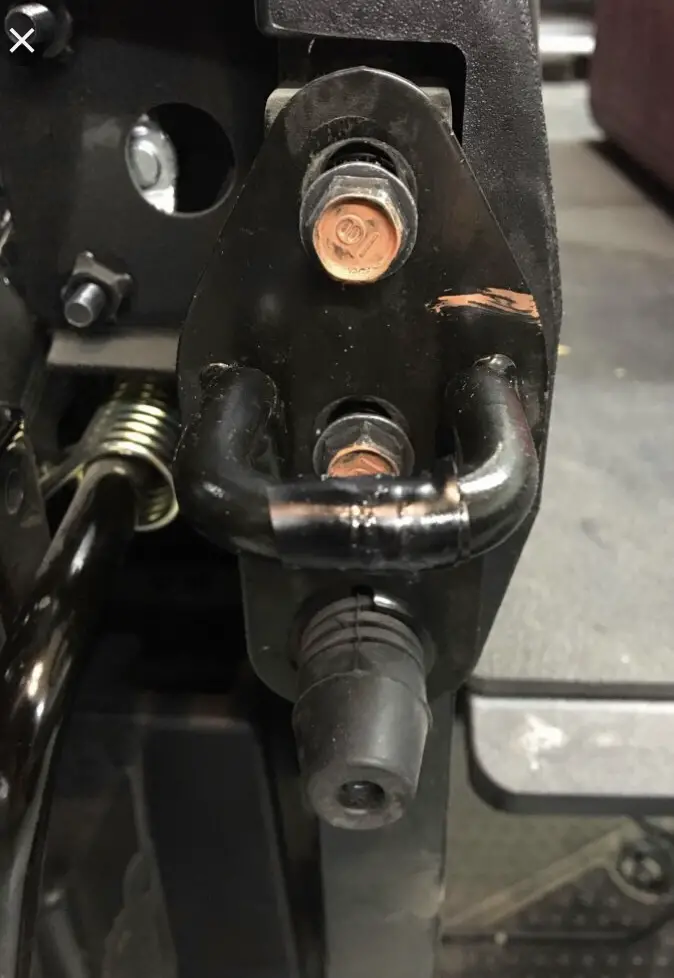

Added some anti-rattle devices this morning.
This may be the most valuable bit on information I've seen on any build so far. lol
Everything on my pioneer rattles!!!!!!! The bed, the doors, and I can't adjust the locks to hold any tighter or else they just don't grab.
Great idea, and nice execution!
39,130
Wrap electrical tape around the the striker and that solves the door rattles.
380edd9b4437b7233db7fa2e6126ce15
For the dump bed, I moved the striker up by loosening the two bolt and that made it shut tighter. Sometimes I have to push down on the bed and push down on the bed dump and latch handle to get it to shut.
BearWoods
BearWoods
Dec 14, 2018
92
260
53
East Stroudsburg, PA
I was wondering why my door latches had old electrical tape remnants on them.. I guess this issue plagued all of the pioneers.
Also, I did what you suggested on the bed and it does work as described I must push the bed down and push on the handle to get it to close.. but it's pretty tight now. Thanks
Theres a very fine line when it comes to stopping rattles at bed latch. Too loose and it of course rattles. Too tight and bed flies open at 50mph going down the road (ask me how i know this). Those spring loaded feet work well against rattling. Plus theyre self adjusting. Just gotta be sure and slam it down hard. I played with several springs. Cant remember exactly where those came from.
