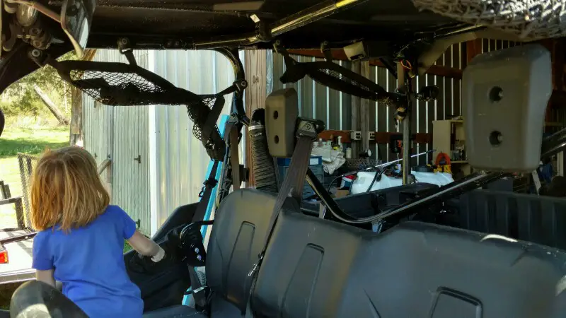

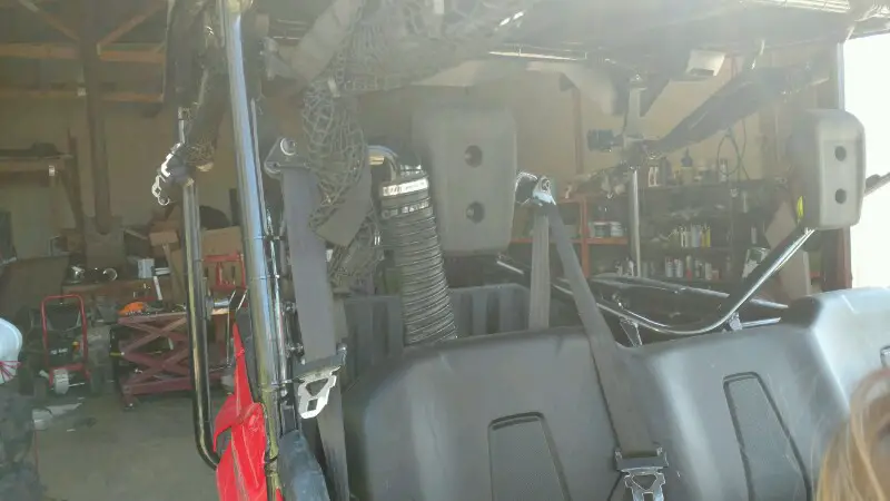

Also got the snorkel installed. Pretty easy installation. Love how its almost invisible. It's camouflaged against the passenger headrest. Put my hand over the inlet and killed motor like it should. Alot of vacuum when I tried to remove my hand. So it's working like it's supposed to. I'll post some install photos in a separate thread. There is some intake growl under a load but I kinda like it.

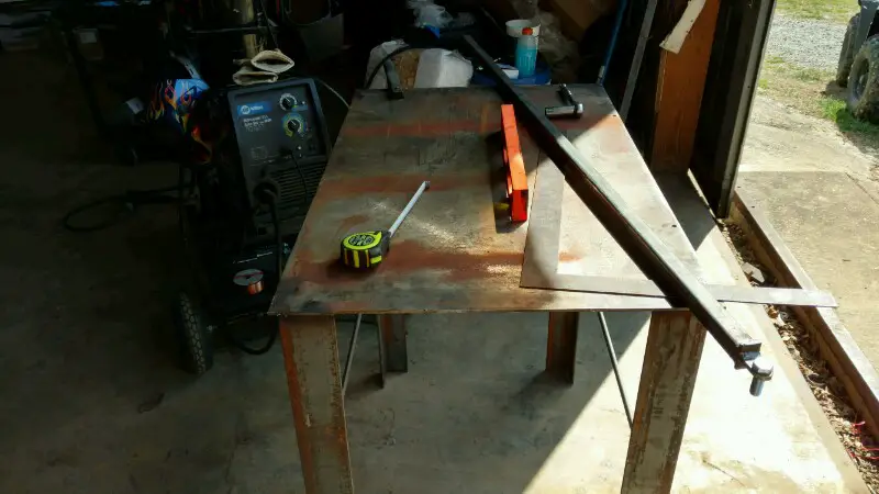

I've had the material to build a small welding table for a while just never had good reason to assemble it. So today I stuck it together. Got a couple projects in mind and it'd really come in handy
IMG 20160323 143857743 HDR 800x450
Wanna guess which project is first? Lol

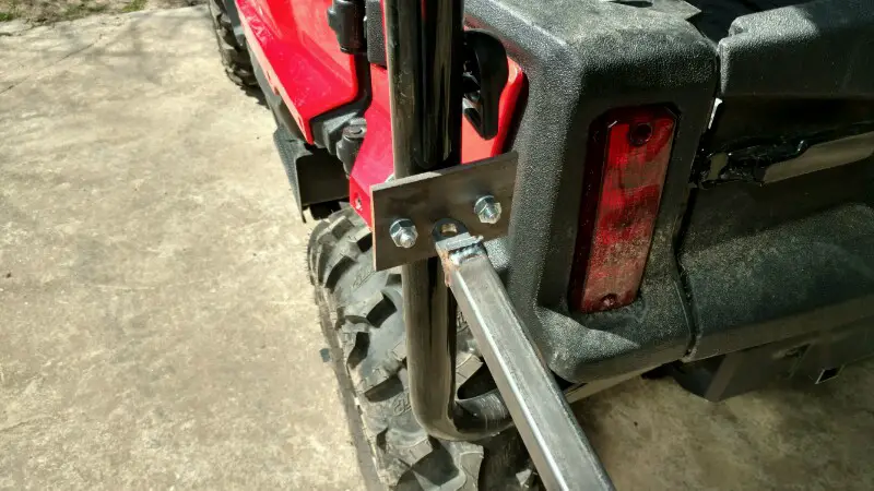

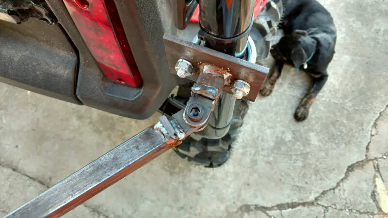

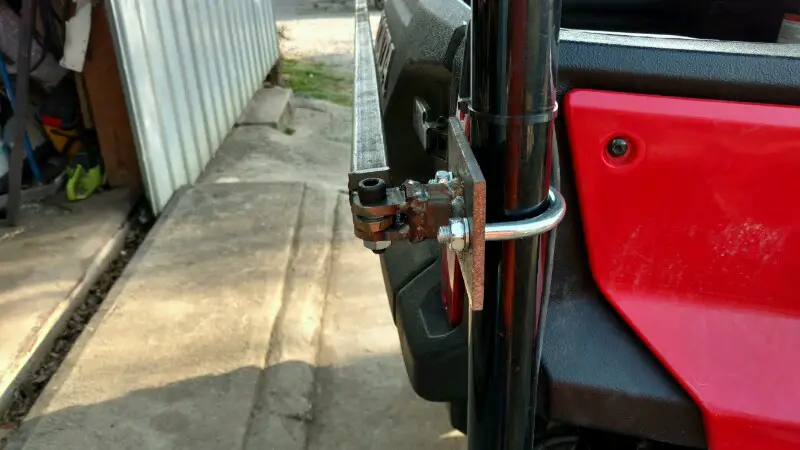

What I've got so far. Its been awhile since I've started from scratch. Forgot how time consuming it is lol. Running 2 1" square tubes with supports between them should be plenty strong. Who knows I may come out in morning and throw it in the trash lol.

Looking good! Don't throw it away... If that gives you trouble, try welding a 3 to 5 inch pipe to the end of the member that carries the spare tire. then spread the ears apart on the mount so the pipe could fit in between (consider using 2 u-bolts at the ROPS). pin the pipe between the ears with a longer bolt with bushings inside top and bottom of the pipe. The load of the tire wants to rotate the bolt... a longer bolt makes a better lever and because of this will see smaller loads at the bushings. this should give you less binding and smoother operation.

That's a good idea. I wasn't too concerned with using the bolt as a pivot considering I won't be swinging it very often. And yes, definitely using 2 separate bases on the ROPS with Ubolts. May run to hardware store tomorrow and get some bushings for the pivot bolts. OR could also use couple of heim joints. Weld a nut to end of the tubing mounted to ROPS, then screw in heim joint with a jam nut. Then run a bolt through the joint. That would make it easy to adjust upper and lower support tubing so they line up before welding in supports. Man I miss my old maint supervisor job. I had access to so many resources lol. Wished I hadn't thrown away that huge McMaster Carr catalog lol. Guess I can always shop online. Thanks for the added option! It usually takes me a while to get to final form. When I get an idea I build it instead of drawing it out. I like a hands on model instead lol.
