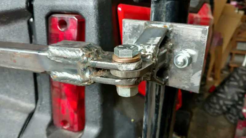

Done with the pivot point problem. Went and got some bronze flange sleeves. It should swing for a long time before needing any attention. Don't like the wiggle of the Ubolt on the base so I'm going with 2 each base. Last day off so I'm quitting to spend time with Emilee ( yeah she's got me wrapped around that pinkie but hey, nothing wrong with that). All that's left is making a duplicate of what I have now and welding some cross supports. Then I can start on base for tire mount and small storage area. Putting the tire closest to the bases for strength. Storage will probably be a small area of expanded.
View attachment 12389 View attachment 12390
o no the honda red is coming off!!!!
Reactions: Delton
Lol yeah it's almost done. No biggie let it come off lol. Need to use better paint and prep the letters better. The pressure washer got to them
use some adhesion promoter!

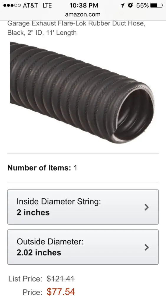

This hose may work. It it rubber and can handle heat and is metal reinforced. And there are larger sizes if that would be needed. Looks like with the fittings needed if some one wanted to build their own it could be done under $100. Not sure how long of a hose would be needed but this comes 11'. Should be long enough for at least 2 snorkels I would think.
Amazon.com: Garage Exhaust Flare-Lok Rubber Duct Hose, Black, For Use With Fume: Industrial & Scientific
Nice try with the hose.... my buddy order some we try to squeeze down the metal poked little holes on the rubber he ended up just ordering the same Snorkel kit I got
Sometimes it just pays to bite the bullet and pay up lol.

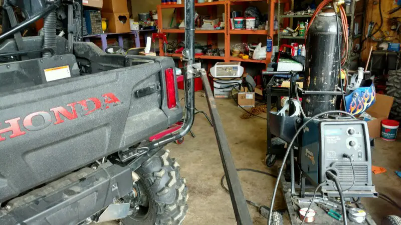

Made the other support today and halfway got it mounted. I'm really digging this thing. It's actually gonna be a nice rack lol. I ziptied it to the other side just to get a sneak peak of how it's gonna look. With it attached at both ends, it should be very sturdy piece. Bad news is gotta go back to the hell hole tomorrow and earn my keep. Got my fingers crossed I have Sunday off. And maybe even cut out overtime on Monday.

Woke up this morning wondering if the 1" square tubing will be strong enough lol. Guess I dream about this crap too lol. I've got several sticks of 1.5" square. May make some supports out of it and see how it looks. That spare alone is alot of weight to be swinging around.
View attachment 12443 View attachment 12444 View attachment 12445
Subscribing... :D
