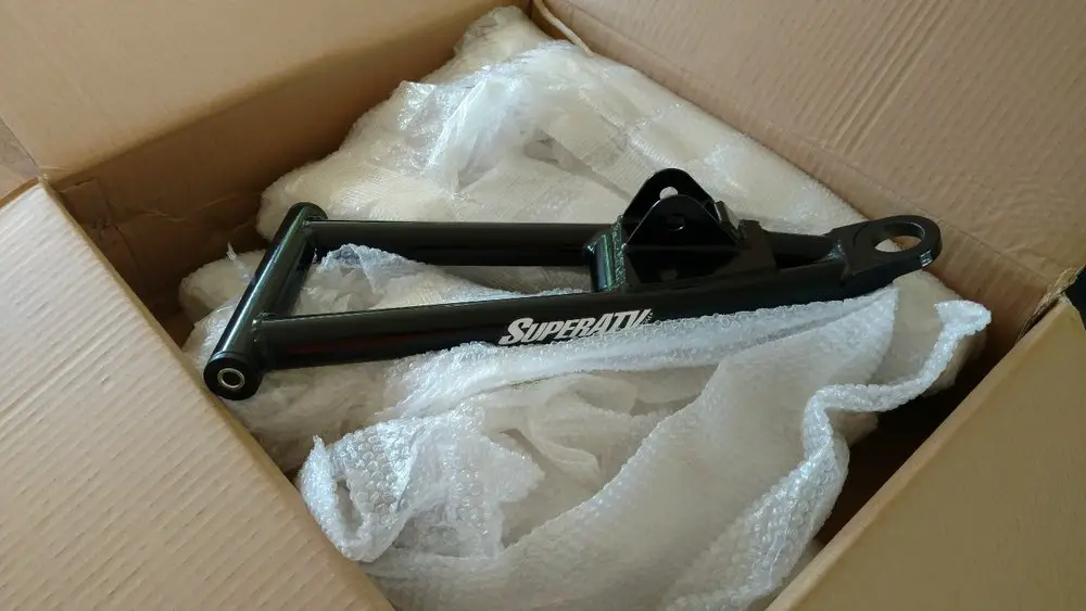

Started playing around with my frontend this morning coming up with a game plan and made an interesting discovery. The mount that I ripped off is different from the other 3 mount locations. It's only gusseted on one side. The rear mount has support on both sides.
Pic of front upper
IMG 20170509 091754164 1336x752
Notice it's only gusseted on the bottom in this pic?. Here's a pic of upper rear...
IMG 20170509 091807188 751x1335
There's no reason the front shouldn't have that extra support. Wouldn't interfere with articulation at all. Guess that's where I'll start.

Got an update on shipment of arms. They'll be here today instead of tomorrow. Normally I'd be thrilled but still waiting on other parts. I won't tear into it until everything is sitting in front of me. Gonna remove bumper and radiator for room and to protect from the heat. It'll be right before she runs over her next mud bank lol.
