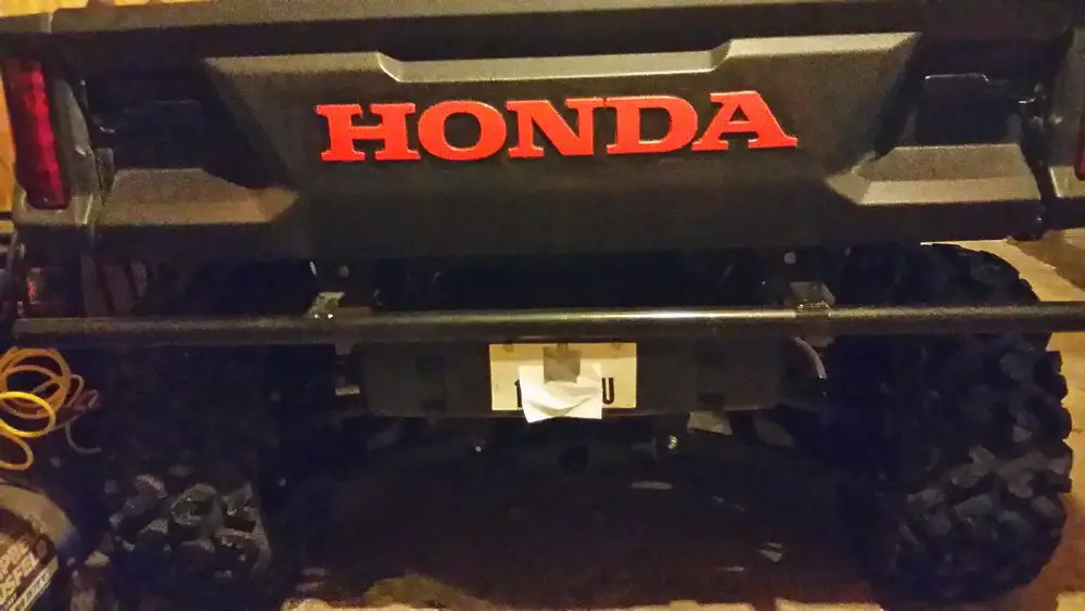

I got a p3, so I don't have the back roll bar, I made a bumper out to of 1 1/4" pipe l that dumps with the box and Made a bracket for plate, made far enough out b to clear muffler we hen box is dumped,

Very nice job. I assume you attached your new bumper to the upper two holes beneath the box with your bolt nuts being attached from the rear (very little room behind those 2 holes). How many inches did you have to come out to clear the muffler? I wish you'd have made an extra one to sell to a fellow Wisconsinite. LOL
I may lean on a friend to help me attempt to duplicate your solution when the weather warms up. The dump box had me perplexed, but your solution resolves that problem very effectively. I'm curious why your "HONDA" letters are red since mine are not painted at all. (I may attempt to contact you off forum to drain your brain a little further on details of you modification if you don't mine.) Thanks for the post.

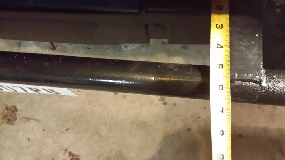

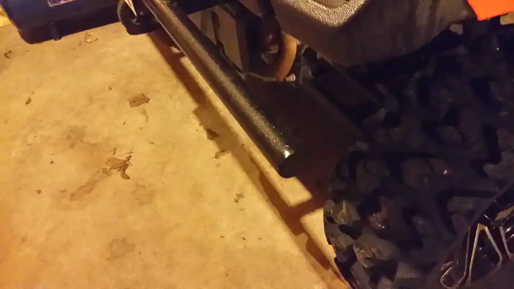

I made o out of 1 1/2" x1/8 angle, the short piece welded on the end bolted to the frame below the box is 2" angle, I made a cap on the end of the pipe. Also I put spray bed liner on the pipe, paint would chip off from stones from the tires. I wouldn't use the bumper to hook a chain on to be pulled out, don't think it would hold up to that, I put on mainly to protect from backing into something, or someonre bumping into you. It's just held on with two bolts, make sure you put lock washers on them. (I almost lost itnonce) haha. As far as the HONDA letters I just scuffed it up with some 150 or 200, and brush painted with a small brush. hope that helps also,notice I dropped it down enough so the tailgate will open, and not hit the bumper.

Thank you so much. Your pictures and information will save me hours of tedious experimentation, and you sure did a nice job. I'll probably wait until it warms up a bit before I make the bumper / plate holder, but I will indeed take advantage of all the information you provided. I owe you one for sure. I was originally looking where to put the I.D. plate, but this solution will also provide some bumper protection which may serve me well too.

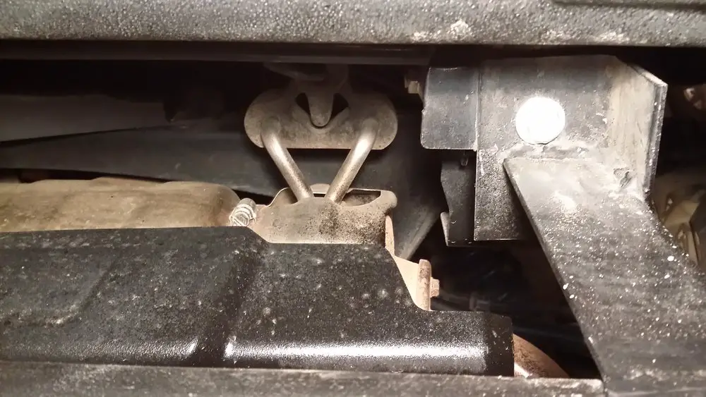

I just added my plate Friday and went with the muffler shield. I was warned about melting a plate and think I'm okay as my plate is metal. When I took out the 4 allen bolts, I found there are two layers of metal heat shields behind the plastic one. And, the plastic outer shield does not seem any different than regular plastic, so how is that not melting if things get so hot back there? If the heat is enough to melt plates, hot is this basic plastic guard holding up just fine? I don't know, but behind my plate I stacked two washers to give it a little distance for air to move. I will continue to check the heat of the plate while riding as outside temps go up. If I do find it to be warm, I will change to longer screws and add a spacer, to create a one inch gap or so. But here is how mine turned out.

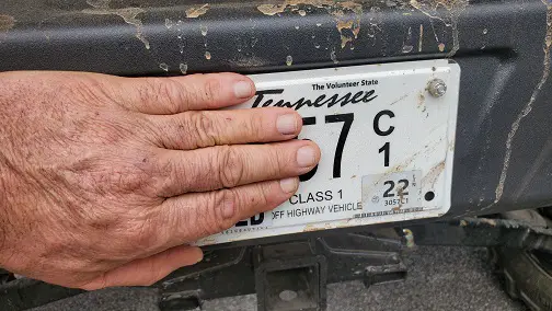

Melt the plate? I was seriously scratching my head on that one. This is five seconds after getting my machine good and hot.

There have been reports of the plastic license plates getting hot enough from heat transferred through the screws to melt the plastic plate. I put my metal plate there as well, I don't see any issues withe the metal plates. In Wisconsin, we are issued our DNR stickers that go on front. Then you are responsible for getting a plate on the back end, but it can be whatever you buy that is the correct size. So plastic or metal, it's up to the owner, just stick on the same letters/numbers as the stickers and you are good to go. Mine came from Amazon already made.
