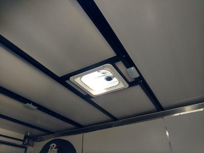

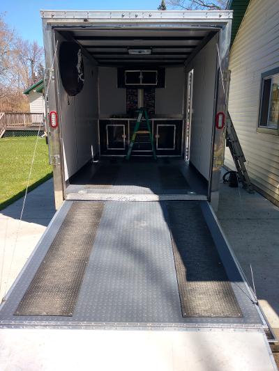

Trailer's coming along. Put in the new flooring, installed it on the ramp too. Turned out nice and looks way better than what I had in there. Finally got the roof vent, took a week longer than it was supposed to. (FedEx is buried right now) Fabbed a frame, painted and installed it but couldn't cut the hole due to a chance of rain. Skies are clear today sooo...will post some pics tonight, if I don't f*** it up. 🤞

Vent went in pretty easy, used butyl tape and Dicor to seal it. Noticed when i went up top that there were pockets of water sitting up there. The ceiling joists are flat, no arc at all and the aluminum roof wants to sag in between them. Would probably never leak in my lifetime but it's still stupid so I'm going to add some 2x2's down the center. May not even eliminate it but should help.
For anyone putting this coin pattern flooring in...had to put a seam on the ramp and discovered their pattern doesn't match from side to end. It gained a full coin in 6.5'. Ended up matching pretty good on the ends where it shows, the rest is hidden by the traction mat.
I'll put the Maxxair on this weekend after the Dicor sets up.
Trailer Vent
Trailer Floor
