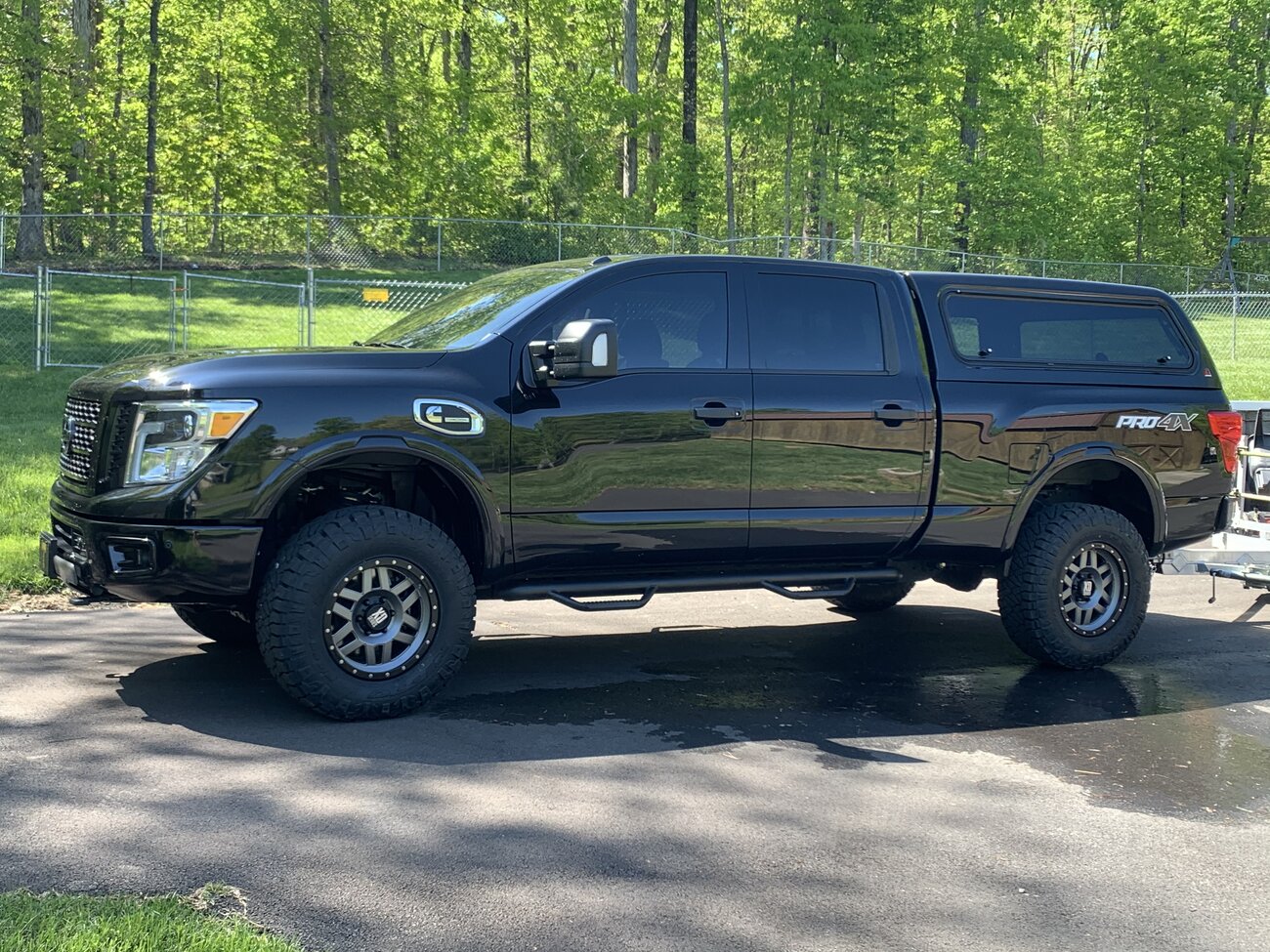

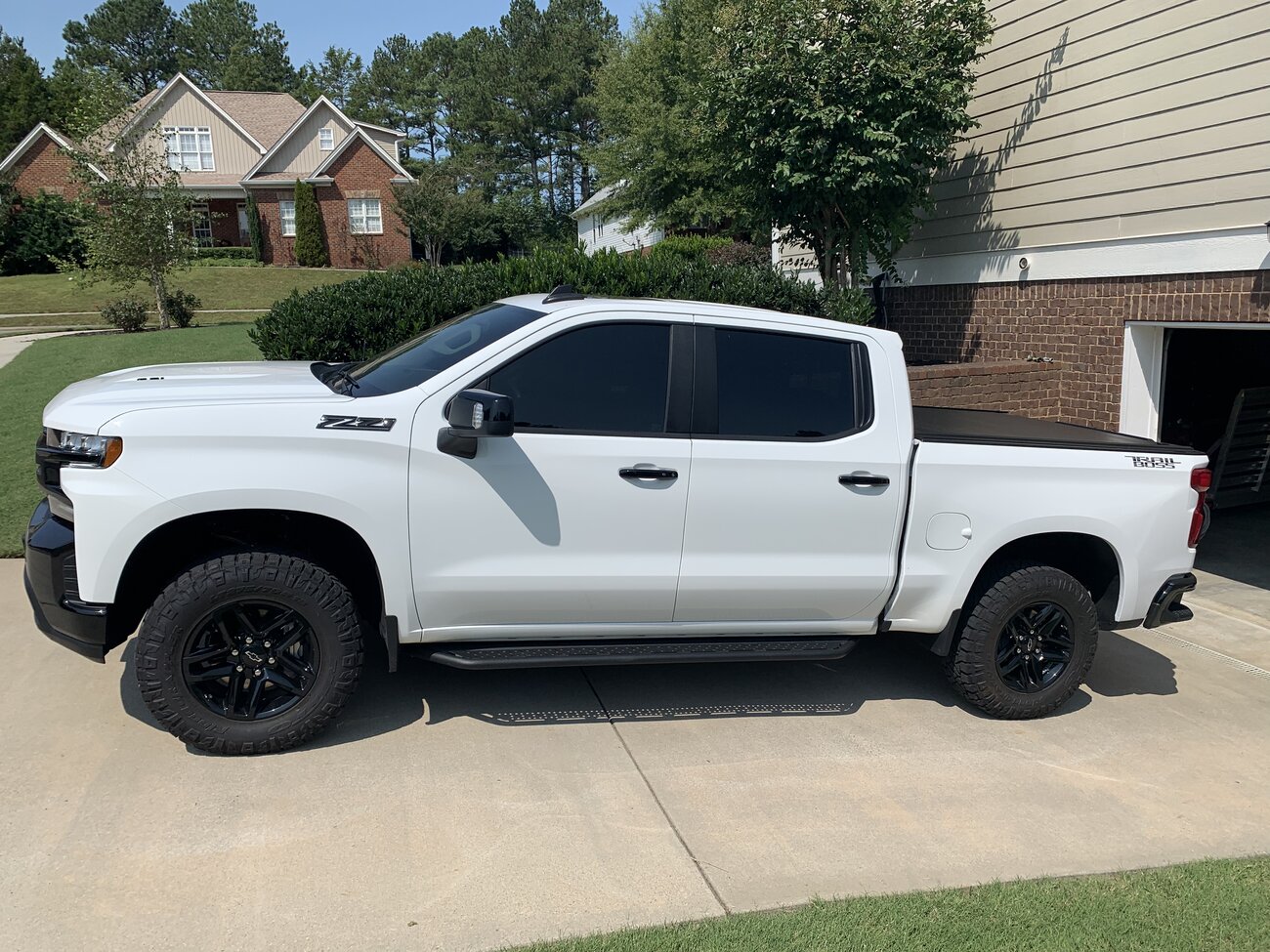

I spent almost 5 years with a Cummins…the catch was it was the gimmick Cummins. I deleted it and put my touches on it, but I worried constantly. Broken cranks were a thing of concern, and I had developed a slight turbo issue that tripped a code. My tech at the dealership said put it back stock and we’d fix it under warranty but then found out that the turbo (among other parts) was on back order. He then said one came in with a broken crank and suggested that I get rid of mine while I still could. It was a great riding truck and for the most part trouble free, but I wasn’t going to risk a $15k long block with no warranty left!
It’s replacement is MUCH more fun to drive with the 6.2! View attachment 347542View attachment 347541
Ya but that was the v8 Cummins. When word first came out on those I was so excited, Cummins in a Nissan which I like too. Then saw all the problems and it didn’t really have power or mileage. Was hoping for more.

Agreed. I loved the truck but it wasn’t what I thought it would be.

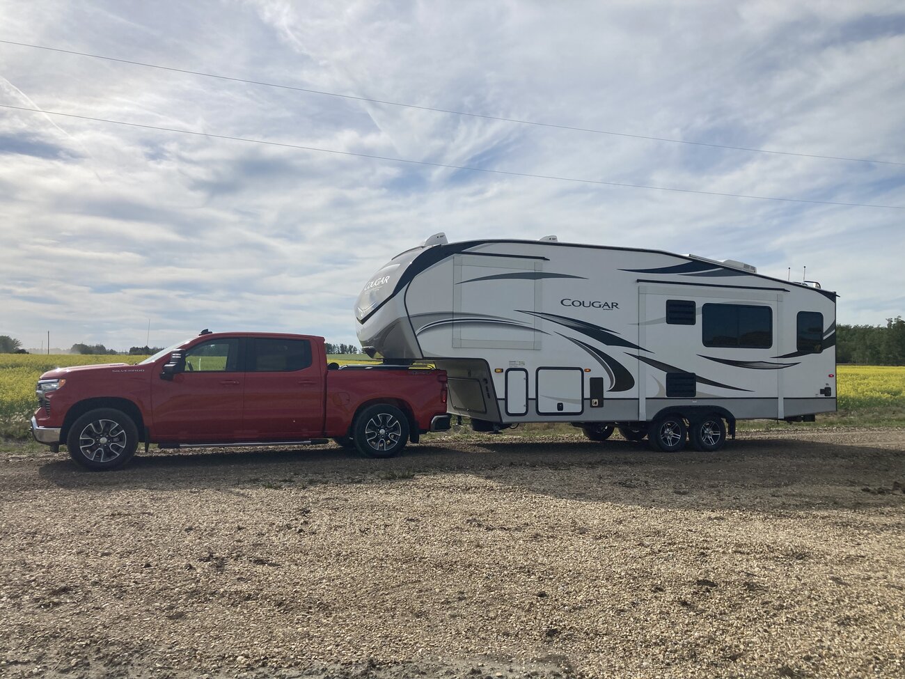

You will be more than satisfied with the GM 3.0 liter Duramax Diesel mated with the 10 speed tranny co developed with Ford. I owned an 18’ and 20’ F150 with both 10 speeds and very happy with the towing performance.
GM added the Max Towing Package to the baby Duramax. My truck door jam sticker states the towing capacity of 12,900 lbs. I pull a 7300 lbs Keystone Cougar along with some other trailers for the toys. Very impressive power, torque and FUEL mileage.
Here are some simple stats:
GM 3.0 Duramax in city 8.5 L/100km avg and 19 to 22 L/100 towing the RV using stock oem ply rated tires.
Ford 3.5L EcoBoost in city14 L/100km and towing the RV ranged from 22 to 28 L/100km with upgraded load range D
I am awaiting on my Timbren bump stops for the Chevy and was really impressed with the Timbrens on the Ford. Chevy saga way more than a Ford with the equivalent Max Tow Package.
A bonus: 2022 Refresh Chevy discounted the diesel to the equivalent of the big 6.2L gas and added the Max Tow Package increasing the tow limits substantially.

Thays perfect example why 5ers shouldnt be pulled with 1/2tons, particularly TH’rs and an In tow trailer. Its not the power plant and Tranny, they have come leaps and bounds There. Its the rest of the suspension, axel shafts, barings and the brakes and Rotors. I love how they say Max tow! Yup max tow alright lol. Long term Max tow as in the max u can tow on those component's are hard as fuc on those components. A buddy just learned that the hard way. When I worked on Heavey Truck in the transportation dept at A big 3 deveopment facility, Its quite amazing the jump in caliper rotor size (for stopping) axel shaft size, Frame size (equally important) and mass of the truck just going from 1/2 ton to 3/4 ton even bigger to 1-ton. when u have to make that emergency hard stop with those 1/2 tons pulling a 5er it wont be good in many ways Think about it with your other added weight. Load that puppy up and go over the scales and go :oops: Dosnt matter what type of springs/ air bags you have to make it look level, It still has all the other stuff mentioned. Yes 1/2 tons are much stronger in that power plant to short pull a variety of things, Just take a Look at the comparisons. Lots of LubTube videos out there to show you.

100% agree
