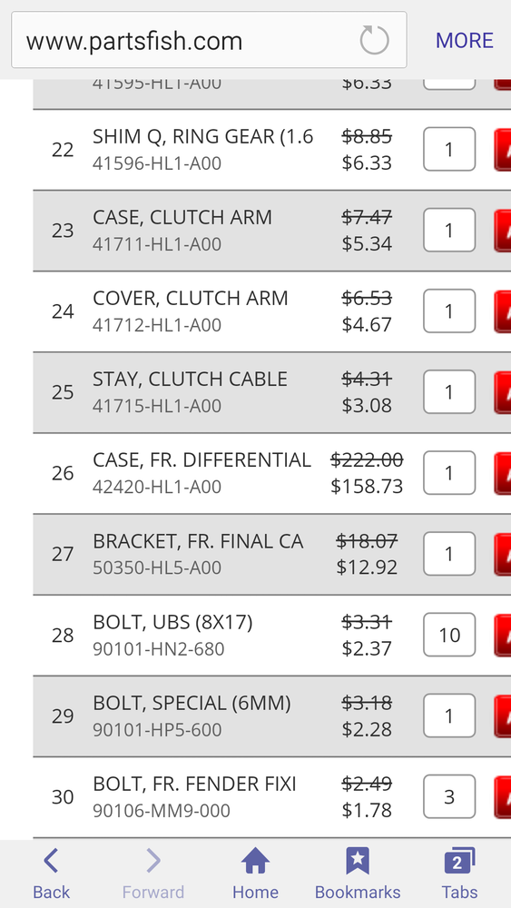

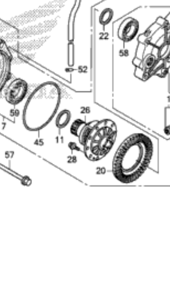

I studied it up a little more. I believe the gears i would have to weld on are housed inside of part # 26. It doesnt show it on the schematics, but i believe there will be 2 gears facing each other inside part # 26 with an 'idler' type gear between them. (I am guessing at this, if im wrong, please feel free to correct me.) Anyway, in a lincoln locker situation, you would weld the 'idler' gear to the 2 bigger gears that are facing each other, and the whole assembly will then turn as one. My idea was to weld pieces of metal tubing across from one gear to the other. But one piece of tubing would slide inside the other. Drill holes in the tubing and bolt them together. Weld the nuts on the inside of the inner piece of tubing so you only need a socket for the bolt heads. There would be more to it than that, but thats the jist. Bikebandit, and partsfish both call part #26 a 'case', which im thinking is a typo. Im thinking the case would be the aluminum housing, but what do i know. Then i started looking at the price. Bikebandit wants $173 for part # 26, and partsfish wants $156 for part # 26. That got me to thinking, if part #26 works like i think it works, i could just buy it, weld the living hell out of the gears in part # 26 in my existing front end instead of making the bolt on thingy. Then when and if i start breaking too many cv's, or if its too hard to steer, i can take the welded up part out and install the new part. That is if part #26 is labeled correctly, and the price is correct also. I think $156-$173 is a little cheap sounding for this part. Anyway, im tired of typing just like im sure youre tired of reading. Im just thinking out loud.
View attachment 42950 View attachment 42951
I wonder what would happen if #22 were thicker?
Also, instead of welding I wonder if you could drill and insert a hard steel dowel pin somewhere to lock it in place? I imagine the gears and bits are all hardened so that may be tough. I have read on hotrod forums that when you have the option of spider gears you can just weld in a few spots to allow the gears a slight bit of motion to reduce immediate bind,when you get it apart and have pics that are better than a drawing we may have a better idea I guess.

Pfive, i have read a thread somewhere on here where someone said they stacked washers in the front diff of a certain Honda atv model (cant remember the thread or the model) and it made the front diff a locked front diff. I wonder if shim #22 would do the same thing? You may be onto something.

It may just fill the diff with shavings, but I doubt it would harm anything....also, a shim made from derln or hard plastic stacked in there would be interesting.
