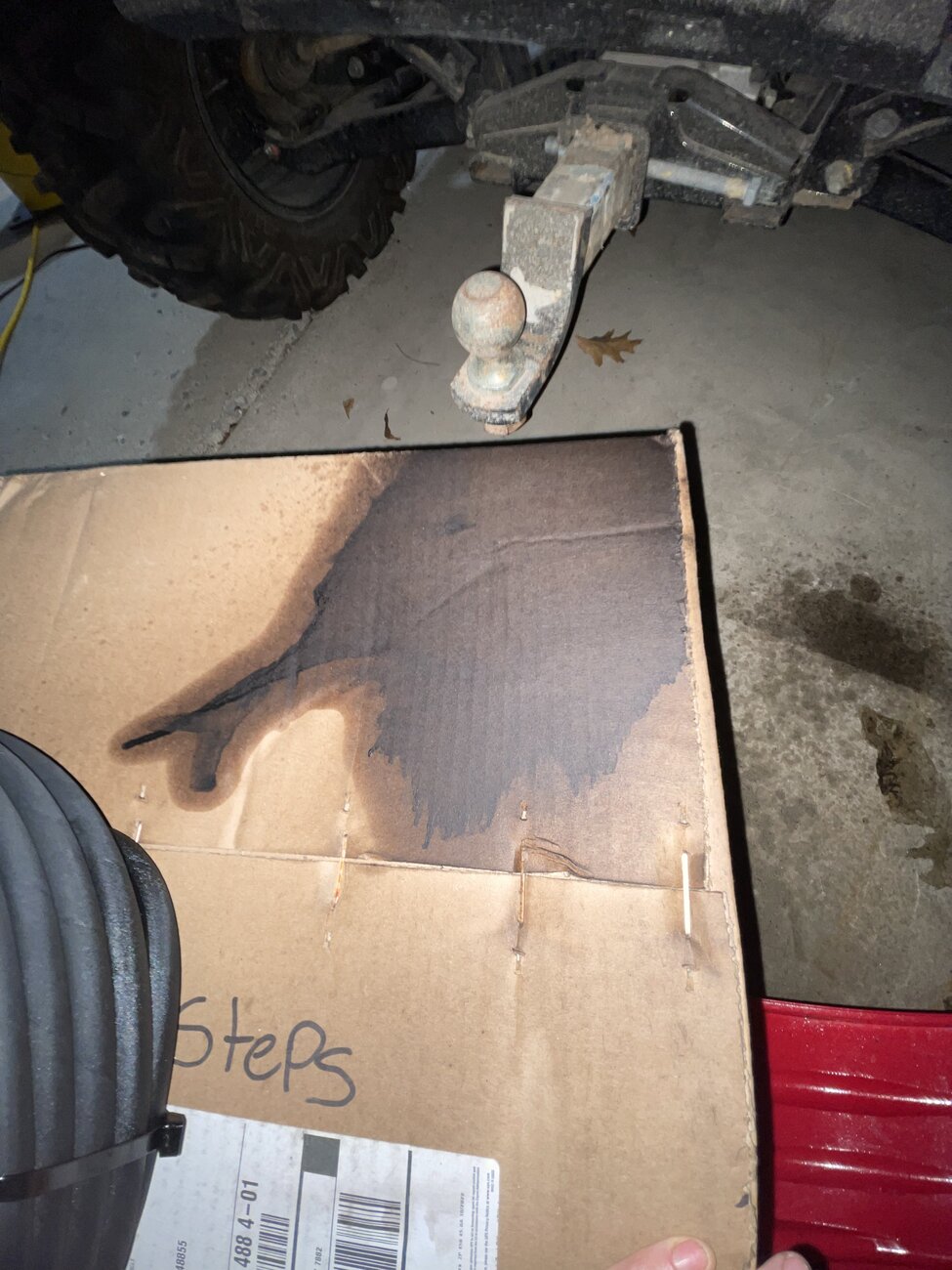

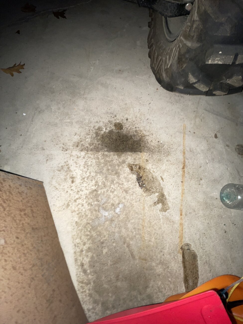

I have a 2021 1000-5 with around 300 miles on it. It doesn’t get rode a lot because of time. The last time I started it up was a month to month and a half ago. Well it’s cold in michigan now and we have a bigger snow storm coming so I figured I’d better go out and fire it up to make sure the batteries were good. Turn the key and tried to start it and the dual battery system said 9.7 volts from the drain over the last month and half. It just naturally made the clicking sound and no fire up. I put a jump box on it and it fired up but ran really rough from probably lower voltage and also 15-20 degree temps and the lack of running for so long. It would spit and spitter and then shut off. The steering wheel light came on and the oil pressure light did as well. I tried starting one more time after the batteries charged for an hour and the same thing. Battery voltage was up but still not perfect. Put the charger on the sxs for a full day and it brought both batteries up to perfect voltage. The sxs fires right up. Maybe idles a little sluggish for a few seconds and then gets into the correct idle rpm’s. Both the steering wheel light and oil light went away. When I throttle it up it just sounds off and with the garage door closed it was like a 2 stroke snowmobile in there with heavy gas fumes and white exhaust. There was definitely gas coming out of the exhaust because of it leaving a mark on the floor and a box behind my sxs. Does this sound like trying to start it and run it with low voltage it flooded the motor? Even though there was 24 hours in between starting it back up from the first initial fail and then charge? I’m gonna get new plugs and see if that fixes it but does anyone have any insight into this? I know enough to be dangerous.
View attachment 367239 View attachment 367240
I haven't read through all the responses but, have you checked to make sure you have good gas in the tank? I'd change out the plugs and put fresh gas (empty tank out first) then see what it does for you.
Good luck 👍

Attempting to crank may have fired the injectors and loaded it with fuel. Not sure if it has to see revolution to fire the injectors though or just the crank signal.

ETHONAL GAS setting 2/3 mo.in cold conditions could do it. ( probably has some condensation / water in there.
It is important to get it as EMPTY as possible.
Suggest:eek:nly Use Non-Ethonal 1-gal. & couple oz. Drygas ( Run with OLD Plugs 1st. will take a few minutes ) to clear up smoke & rough running.
Best to push Outside ( that White Smoke WILL FILL your garage/ shop in a couple minutes )
Good luck
Hope I've put on the right path .
