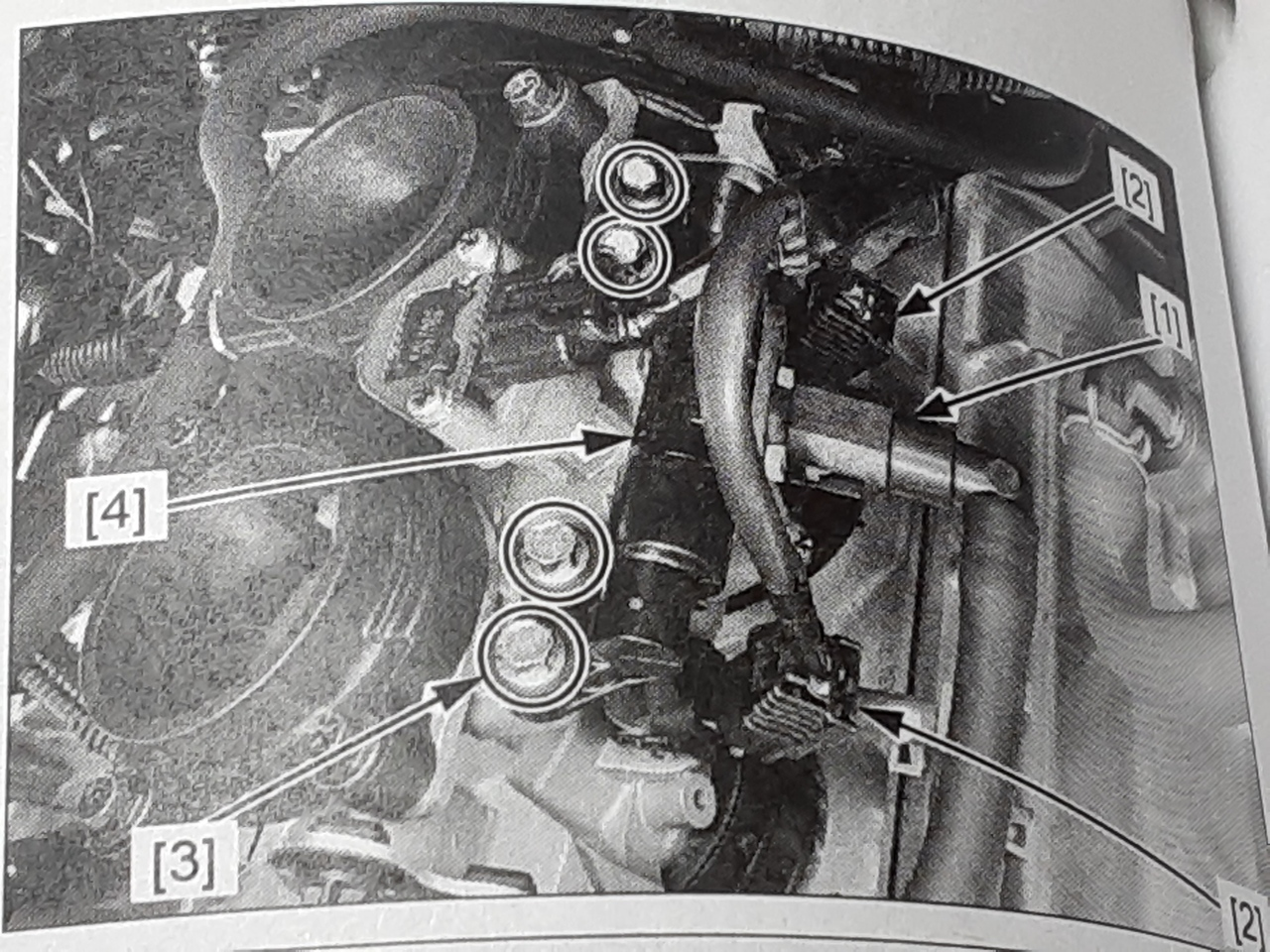

Thanks for the help. The injector wires. Are those the ones on the top behind the iacv? Where the fuel
Dumps into the throttle body?
This is a pic from my Talon manual but the Pioneer is 'about' the same. #2 (two of them) are pointing to the fuel injector connectors and where some wires were breaking inside the insulation - this is where you want to push the wires together, you're trying to make contact if the copper is broken inside. Can someone say if and when Honda fixed this problem, is it still happening? (We're trouble shooting a 2021 P1K with 300 miles) OP - they live between the throttle bodies and valve cover. #4 is the fuel injector assembly.
Thanks for letting us know you're quitting for the night.
Thanks for all your help! I thought those were it. I’ll Check those tomorrow. I feel defeated tonight.

So today I’m going to check the compression and possibly oil depending on time. Is there a way I can blow out the injector line of possibly water? I would think with as much gas that’s blowing out the exhaust there wouldn’t be any in there by now if that was it.
For the injector wire harness. Shouldnt I be able to unplug the harness and check it with an electric meter in the prongs for 12 volt power as I’m turning over the key? I’m assuming that each injector has a harness and the harness has one side as a neutral and one side as a hot because it’s two wires and my assumption is the harness wires go directly to the fuel pump?
