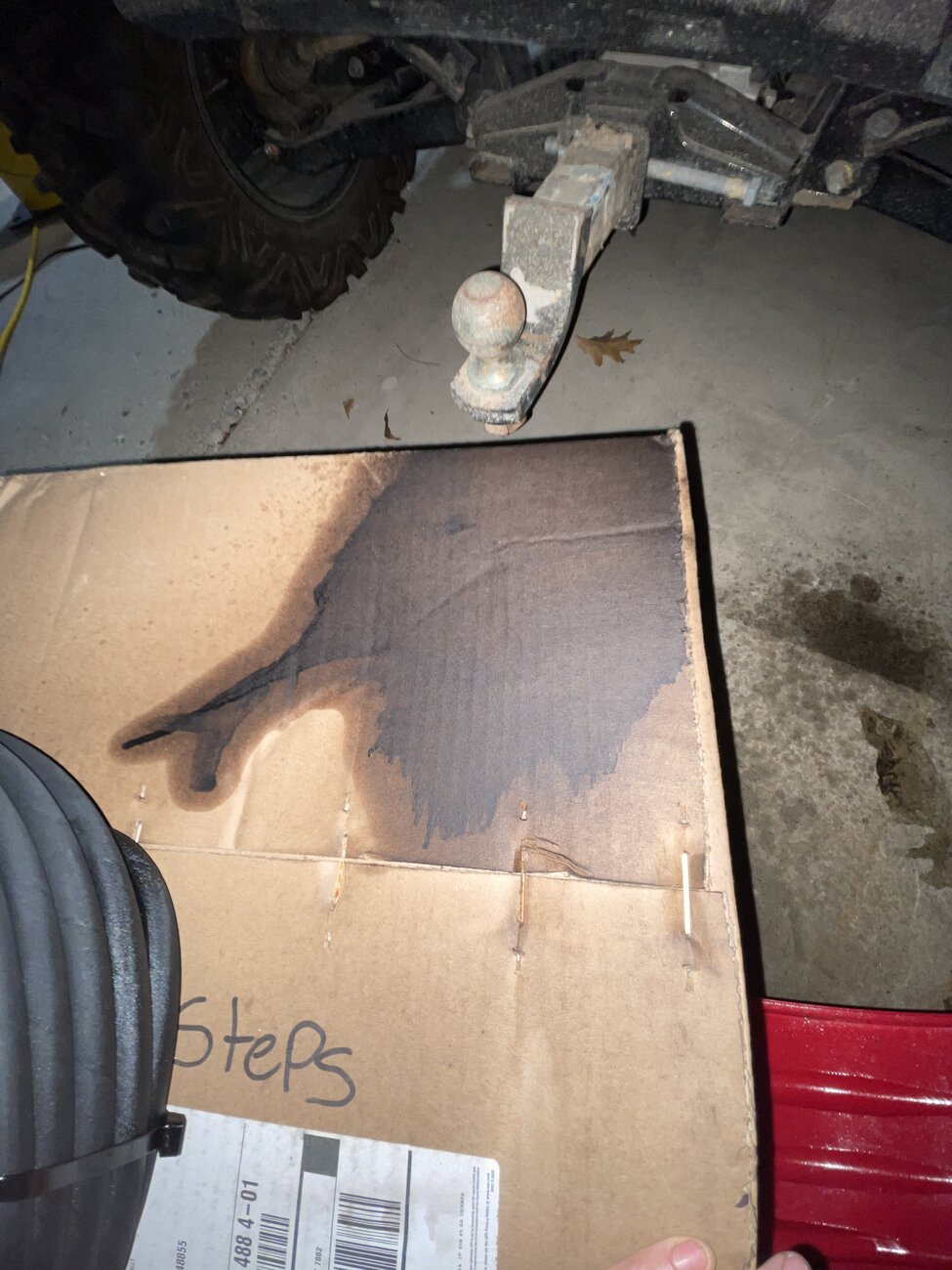

I did put a half a bottle in the tank with about 2 gals of fresh gas. Your saying just pull the line off the top of the fuel
Tank and pour the heet in the lines and raise the line as high as I can? I didn’t try wiggling the injector wires but I think from the fuel out of the tail pipe it’s getting too much and flooding.
I will have to look up what this pgm-fl is.
that’s the fuel that turned the snow yellow and then the obvious on the floor and box.
View attachment 367427 View attachment 367428 View attachment 367429
Can it be diesel? Or kerosene?
  • Wow
Will it light on fire if you put a match on it?
