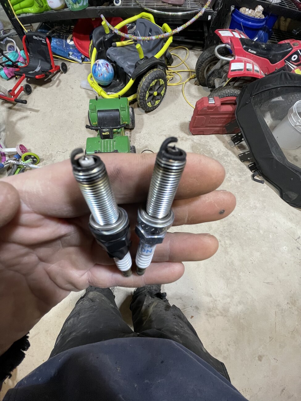

Yea with as much fuel that was blowing through it and the blackness on that back I think that cleaned itself. I also think that’s why the spark plug on that not burning cylinder was white when the running side was black. As in the pics below.
View attachment 367463 View attachment 367464
One plug looks fouled the other looks like it was washed by fuel. The white is just the porcelain.
If the ground side of the electrode were white, then it would indicate a lean fuel condition.
Yes exactly. The white is the one washed by fuel with not ignition. That spark plug will knock u on your but from the spark it puts out. I switched them anyways to try it. Knowing that it had spark and the plugs good and the correct gap.
