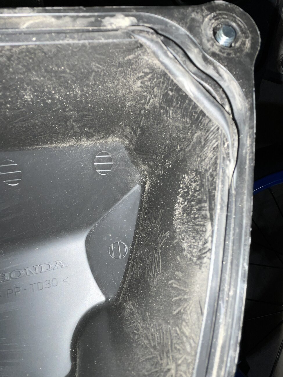

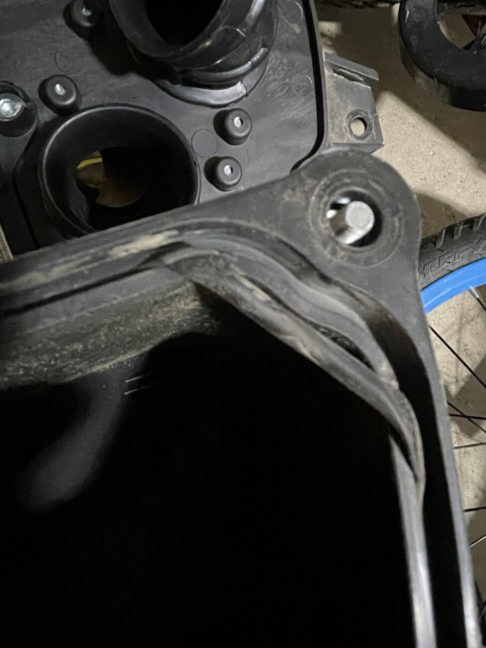

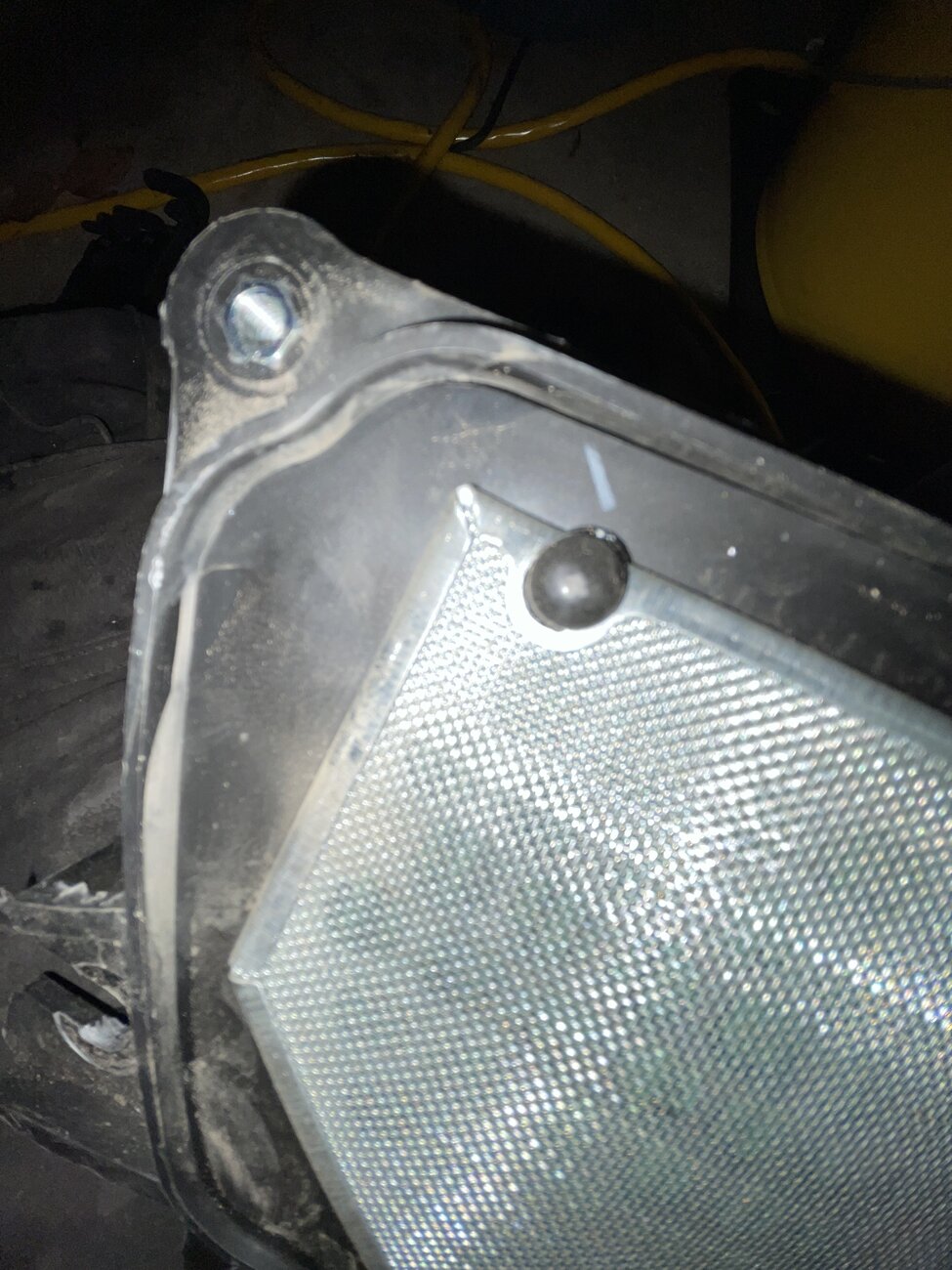

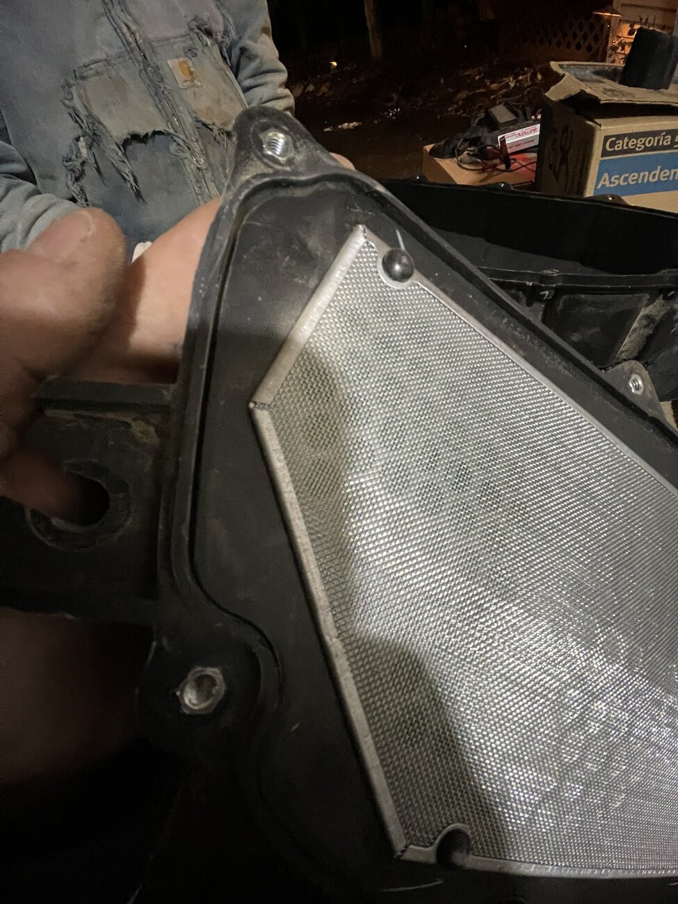

On a side note I took off the air box over the motor. The bastard that assembled the air box didn’t get the gasket in all the way and pinched it in between the air box outside so it was sucking air past the filter and there was sand granules in the box past the filter where it’s wide open down into the throttle bodies. I wonder how great that is for a motors. Pisses you off you spend as much as a f***ing car and they can’t do a simple job right that can be detrimental to you motor.

It doesn't matter, they need to be close to the same - we know one is working.
Good point. The air box gasket was screwed up from the factory so god only knows how much sand it has sucked through the motor.
