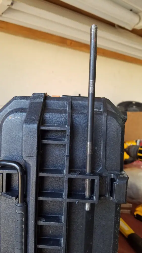

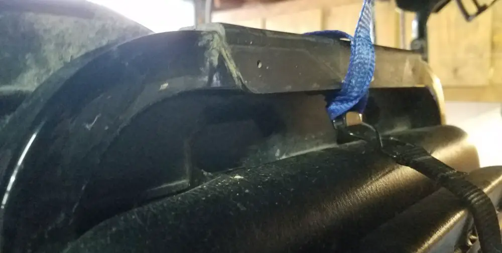

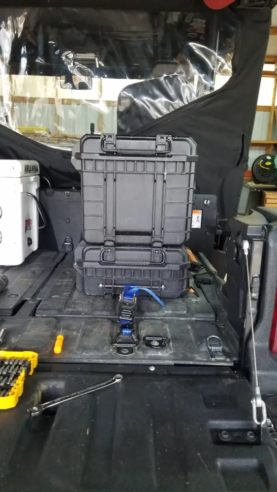

I wanted a better way to tie down my rigid tool boxes. I liked @ohanacreek s bolt idea but decided to do something a little different. I had some old hay rake tines laying around so i cut them to length and thread the ends. I drilled holes in the side of the box and drove them through.

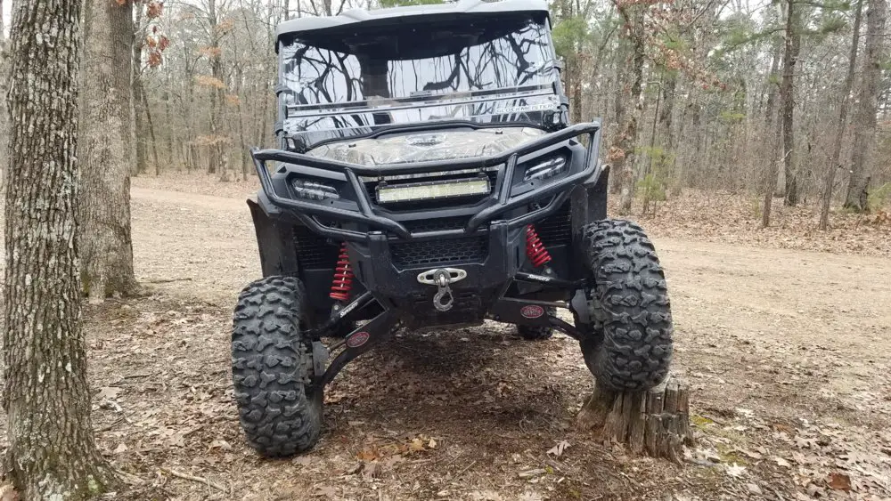

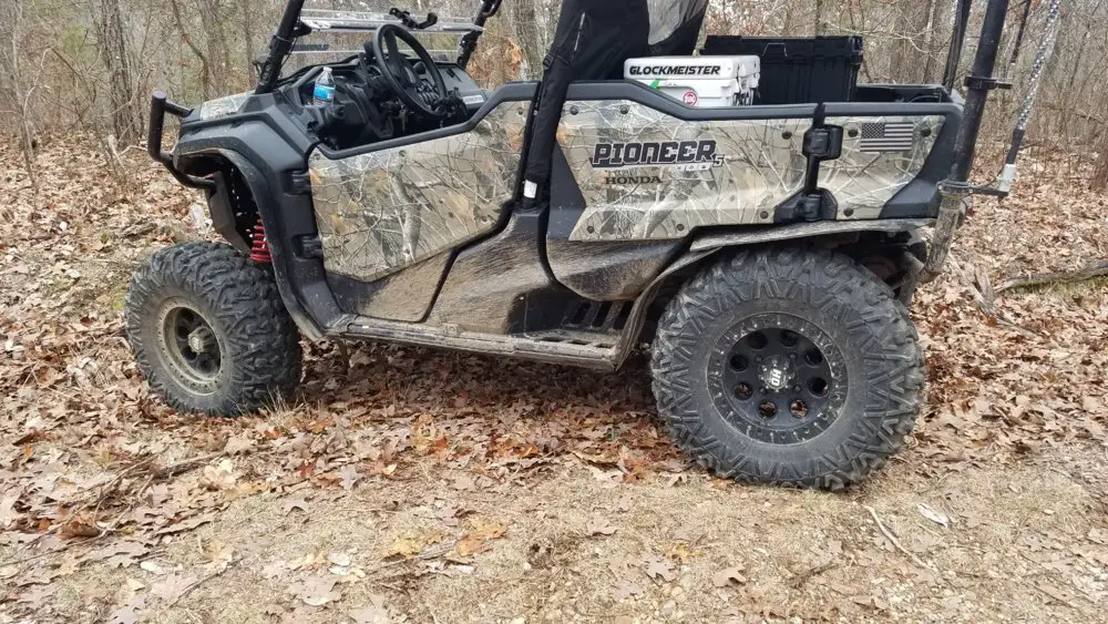

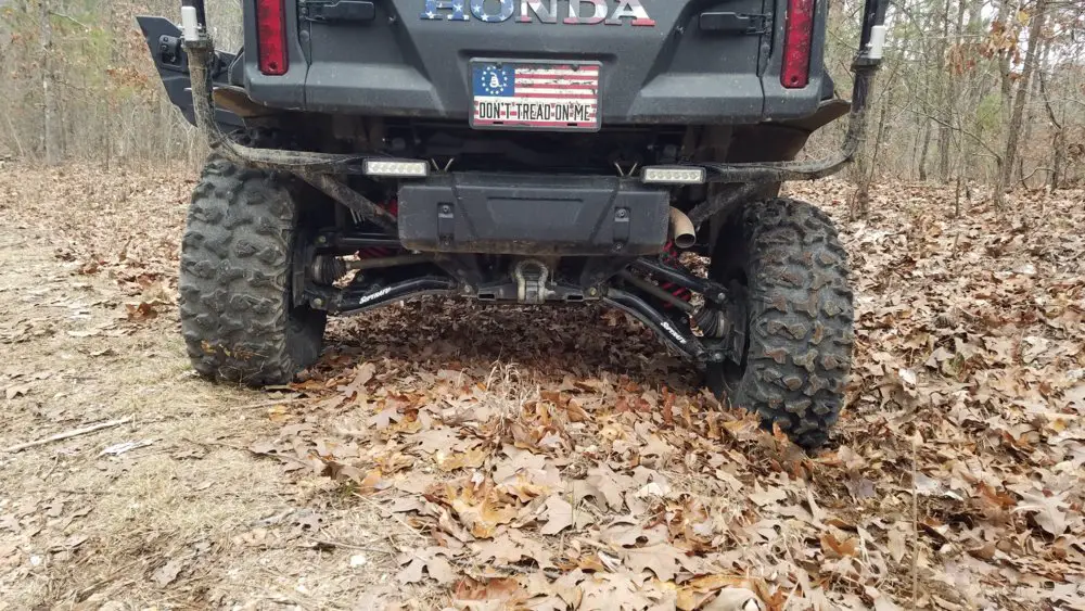

So i decided to pull of my lift and just run preload on my shocks. Ended up with 2.5 in of preload in the front and 2 3/4ths in the rear. This amount put me back at almost the same ride height as i had with the lift. Ride was greatly improved and there is definitely more shock up travel. I tried to get the rear tire to rub and wasnt able to. Overall happy with the outcome. Looking forward to doing some real trail testing.

Looks good! Now your getting back to the factory LE spects that everyone that dont have a LE makes fun of. Lol

Hell you're going to be stuck everywhere now! Good thing I got the rear winch!
