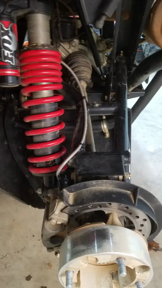

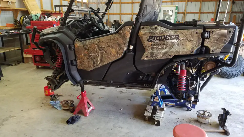

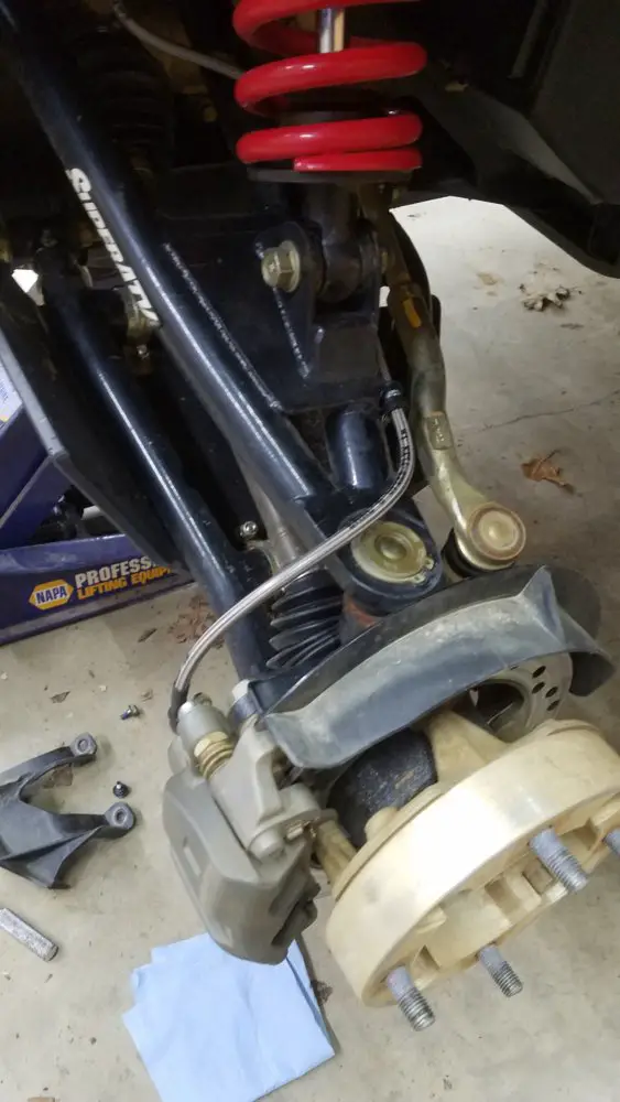

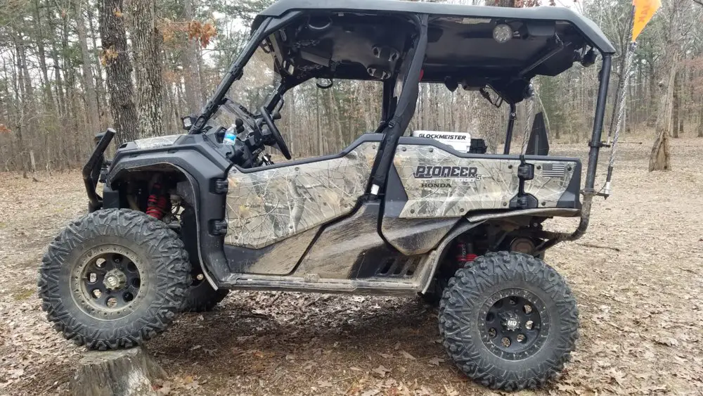

So i decided to pull of my lift and just run preload on my shocks. Ended up with 2.5 in of preload in the front and 2 3/4ths in the rear. This amount put me back at almost the same ride height as i had with the lift. Ride was greatly improved and there is definitely more shock up travel. I tried to get the rear tire to rub and wasnt able to. Overall happy with the outcome. Looking forward to doing some real trail testing.
View attachment 111808 View attachment 111809 View attachment 111810 View attachment 111811 View attachment 111809
