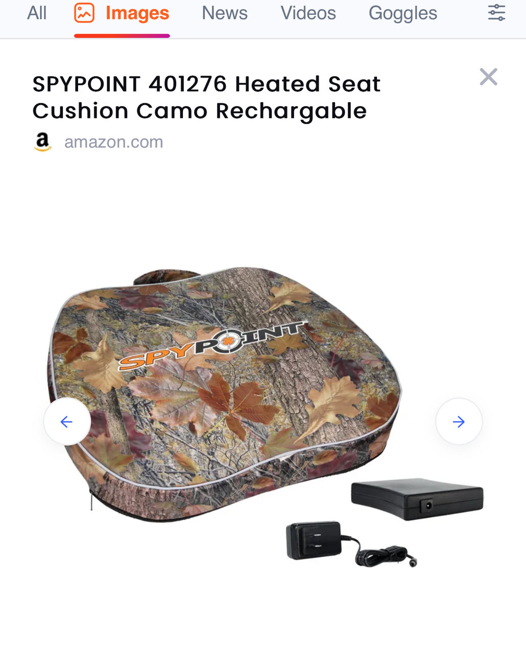

I forgot about that on mine. I have 4” thick heated seat cushions for the rear. That definitely helps. The rear seats are too low, even for 6’ adults.
And they work good in a tree stand, fishing boat or Packer game also. :p
They are similar to this although mine were from wal mart.

I bought two Mossy Oak - Wally World 3" electric hunting cushions like these. They fit perfect, make the rear seats better year round, and you can rig them to use vehicle power instead of battery (mine use standard USB power). When out in the cold, we throw an old sleeping bag across our laps and it works.
I also have a heated vest. If you haven't tried one, you should. It's magic.

I have one of those. It actually gets too hot for comfort sitting in the deer blind.
