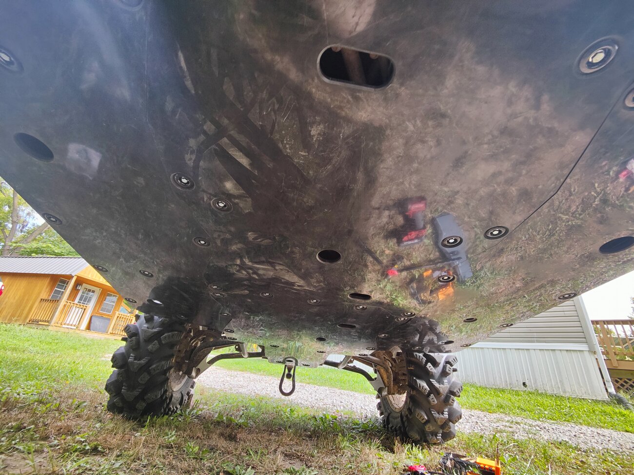

Inatalled the SuperATV full skid plate. That was a chore and a half! Used riv-nuts instead of the provided self tapping screws. I purchased a generic tool from Amazon and a box of M6 riv-nuts. I forgot about the actual bolts and ended up buying 34 from Westlakes for $1.16 each :/ they were $9 for 25 on Amazon. Good drill bits are HIGHLY recommended! I used a Bosch 1/4 to start each hole and then a Bosch 23/64 to finish it from menards. I went thru a couple of them.
I used 25mm and 35mm bolts depending on the location.

Proper Protection: 09-02-22
View attachment 352607 View attachment 352608
I like to use a drill bit up to the hole size smaller than the nutsert and then I switch to a unibit as they tend to drill a hole that is more round than a drill bit.

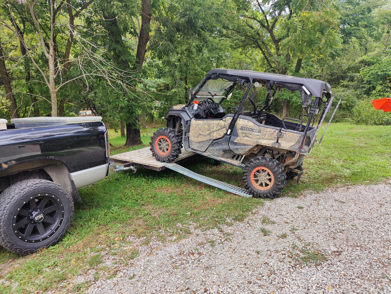

My wife and I just finished unpacking from our trip to Drummond. It was a long awaited vacation. We had a blast! We kayaked in Glenn Cove, hit every UTV trail, boated around some, hit all the gift shops, and just relaxed in the enjoyment of being 1000 miles from home forced to be in a position of just not caring of what's going on at home!
We went up and down marblehead 4 times. We did not meet as many people on the trails this year compared to our last trip. We were able to eat at Esther's for the first time. We met a new friend selling some cool gear that knew my wife's great grandfather. Overall just a memorable trip as always!
We learned with all our new upgrades we will be purchasing c-fab arms this black Friday. I emailed the company and confirmed they will have a black Friday sale so we look forward to that. My high lifter arms and lift will be up for sale eventually.
Are you referring to a step bit? I used a Bosch 1/4 to start each hole and then a Bosch 23/64.
