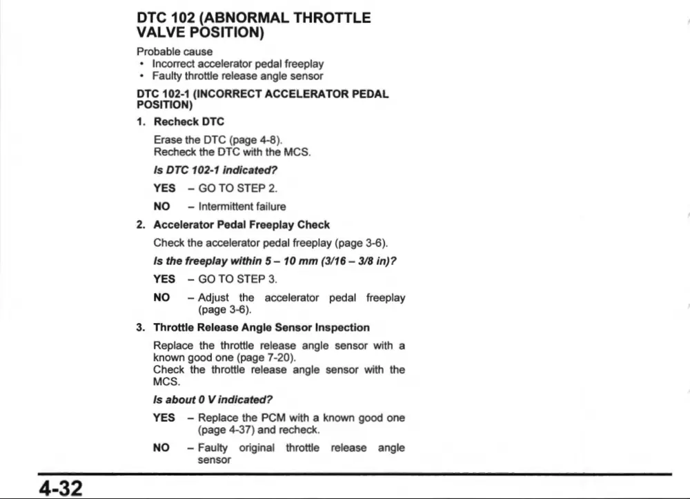

Code 102 is: Abnormal Throttle valve position with the throttle pedal release - sticking throttle valve. Says engine speed may be limited.
Ya I got it to stay running and drove it up and down the drive way and it seemed like the throttle was unresponsive or just wouldn't work right. Isn't that a recall too?
